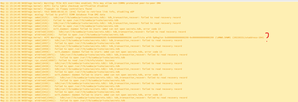

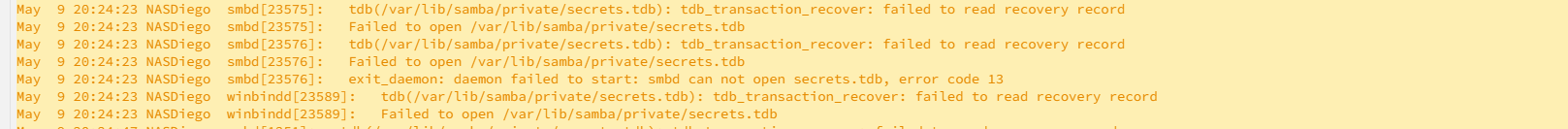

May 11, 20233 yr Author The following shares are, between other, setup a smb shared: Andrea, Casa Regarding System Logs it a shows: In several periods of time Thank you again
May 11, 20233 yr Community Expert This is a problem, Samba is failing to start because of that secrest.tdb error, try deleting /boot/config/smbpasswd and reboot, note that I believe deleting that file will lose user stored passwords.

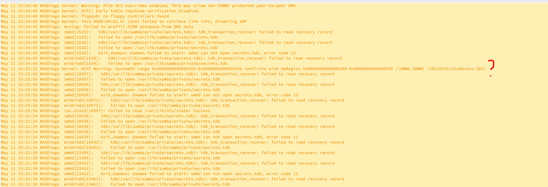

May 11, 20233 yr Author I proceed to delete smbpasswd and Reestart (I have to force the shootdown) the system. Once reestarted, smb continous not working. I checked that smbpasswd whas reseted (as you said without other users different than root). There are logs I am getting and the diagnostics file: nasdiego-diagnostics-20230511-1534.zip
