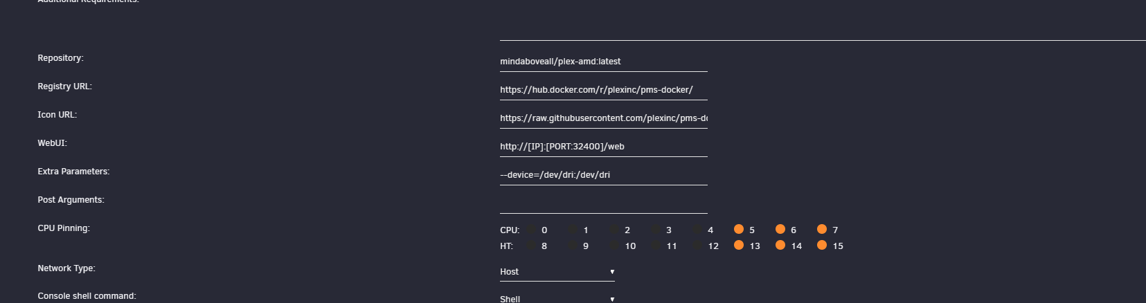

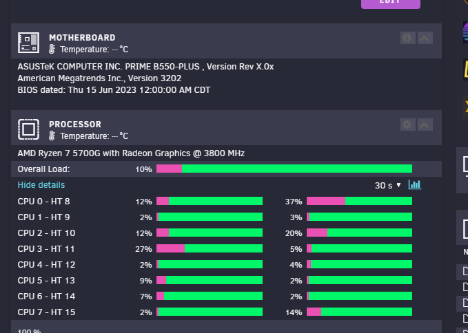

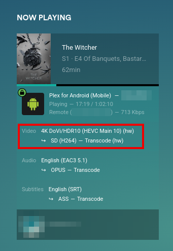

November 24, 20233 yr Author Dear All, I wasn't able to engage the last few months... I have revisited the setup I have and I discovered that current docker images I am using already manage now the iGPU of AMD Ryzen 9 7900. There are new settings available in the plex server to choose which GPU to use: iGPU vs an additional one I have installed nvidia Quad. I tried the last 24h and it worked perfectly. see some pictures below on the new setup I have. some posts mentioned that the transcoding can't manage HDR10 content but I found that this is not true. in my case the play is smooth and no bugs. What I noticed is that unraid still shows the CPU being used higher than with nvidia (around 25%) but you could see that iGPU is being used (bottom of the picture). I run a test with 5/6 streams simultaneously, and all was transcoding from 4K HDR10 to 1080p with no sweat. Pic 1: shows the docker setup with /dev/dri Pic 2: Shows the new settings under transcode in Plex server settings. Rafael is the code name of the iGPU in Ryzen 9 7900 Pic 3: Shows the dashboard while running one transcoding from 4K HDR10 to 1080p Pic 4: Shows unraid dashboard with realtime CPU usage (higher when using iGPU vs Quadro) I think it's because unraid can't distinguish CPU vs iGPU for Ryzen. and on the bottom of the picture the GPU monitoring using the GBU statistics plugin showing the usage on iGPU.
