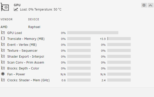

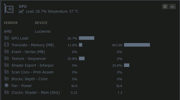

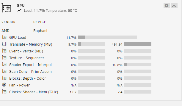

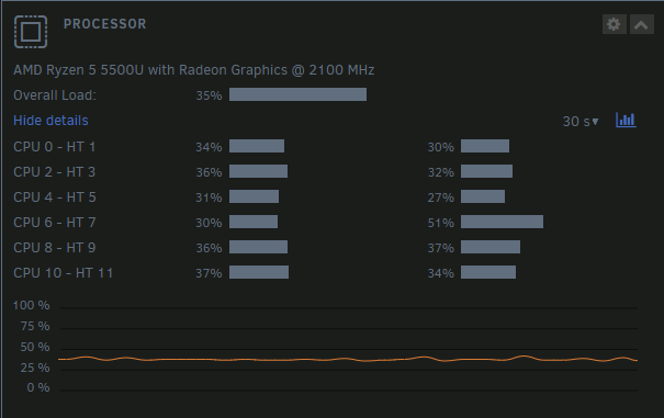

September 22, 20233 yr So here are my results converting 4K to 1080P Single Transcode Multiple Transcodes You are correct, CPU did increase, while GPU did not, but all three report HW transcoding and this is from an ADM Ryzen 5 5500U with Radeon iGPU This was with the three transcodes above all running. If your GPU is older, not sure what is officially supported by Plex. Might be worth a look through their forums for your GPU and see what other's experience with it is. Edited October 4, 20233 yr by Nofences Corrected grammar for clarity

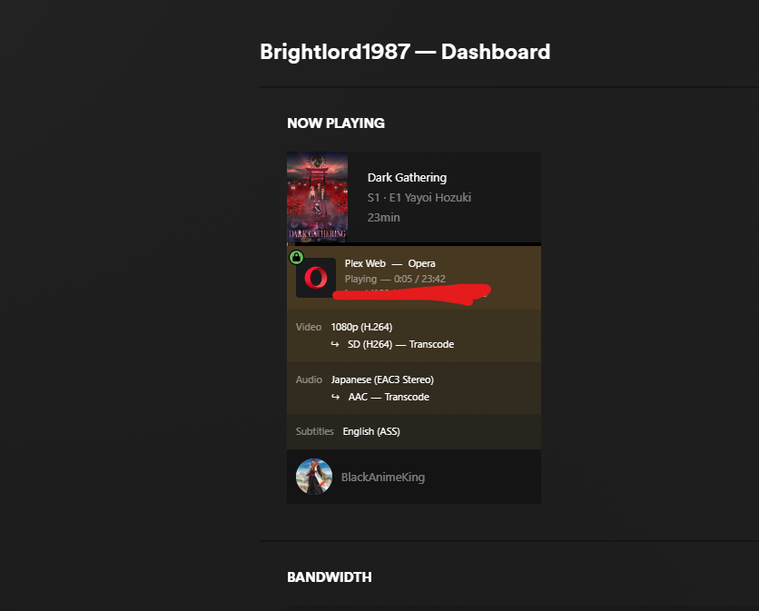

October 3, 20233 yr @Nofences I have followed your instructions for setting up the AMD transcoding and mine is still not HW transcoding. I have a AMD Ryzen 7 5700 @ 3700 MHz and I still get this when I Transcode. I have installed the Top plugin as well as add the variable device: Edited October 3, 20233 yr by animeking1987
October 4, 20233 yr 11 hours ago, animeking1987 said: @Nofences I have followed your instructions for setting up the AMD transcoding and mine is still not HW transcoding. I have a AMD Ryzen 7 5700 @ 3700 MHz and I still get this when I Transcode. I have installed the Top plugin as well as add the variable device: Are you using the "Official" Plex container? I was unable to get it to work using LSIO or Binhex Plex containers. Did you enable HW transcoding in the Plex settings? Can you post a picture of the container settings? I will try to help as much as possible, but can only really share what worked for me.

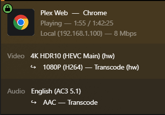

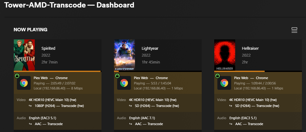

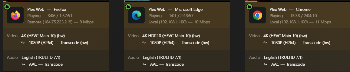

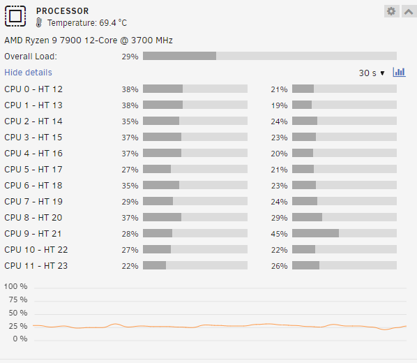

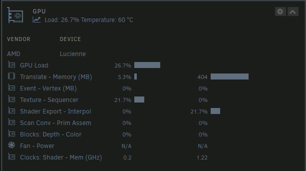

October 4, 20233 yr @Hiko0 Below are some screenshots from a little testing today. I have a 7900 (non X) on an MSIX670 mobo. I run a bare metal VM passed through with an iNvidia graphics card. When idle the processor hovers around 5%. I am running Plex official docker v1.32.6.7557 This is 4 4K streams transcoded down to various bitrates. 2 Streams were being played in browser on the VM. The others were on different devices. Edited October 4, 20233 yr by jace055

October 10, 20233 yr @jace055 11% GPU utilization seems to me pretty low, are we sure that plex is not utilizing the CPU somehow as well? Edited October 11, 20233 yr by matew
October 17, 20233 yr On 10/10/2023 at 5:45 PM, matew said: @jace055 11% GPU utilization seems to me pretty low, are we sure that plex is not utilizing the CPU somehow as well? It does seem low to me as well. My main win/takeaway is the processor doesn't jump to 70-80% utilization when I start a single 4k transcode. So the GPU is doing something. I assumed the built in codec doesn't use much processing power from the processor itself and is offloading the workload to the dedicated chips.
