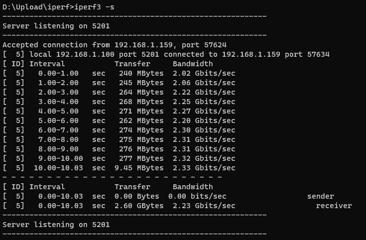

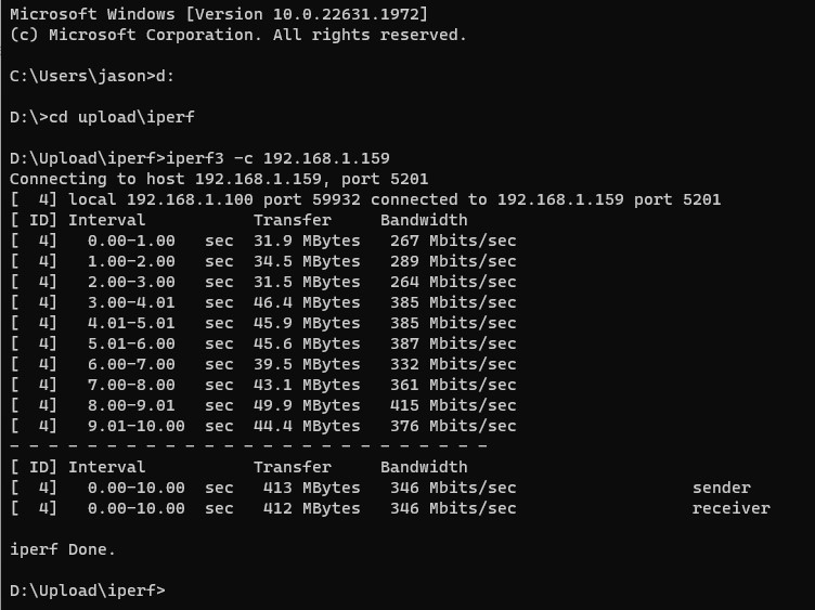

  7. Here are the results of the iperf tests with the driver installed. I neglected to test before reinstalling the driver.

  10. I installed the driver and restarted, however performance is not good, when connected to my gigabit switch, I am seeing 100+ mbps transferring to and from the Unraid server, when connected to my 10gbe switch, I am getting 217 mbps FROM my Unraid server, but only 18 mbps TO the Unraid server. Cache drive on the server is functioning normally, so it is not a write speed issue. I have not removed the driver yet, but I did put my connection back on the gigabit switch until I can determine why.
