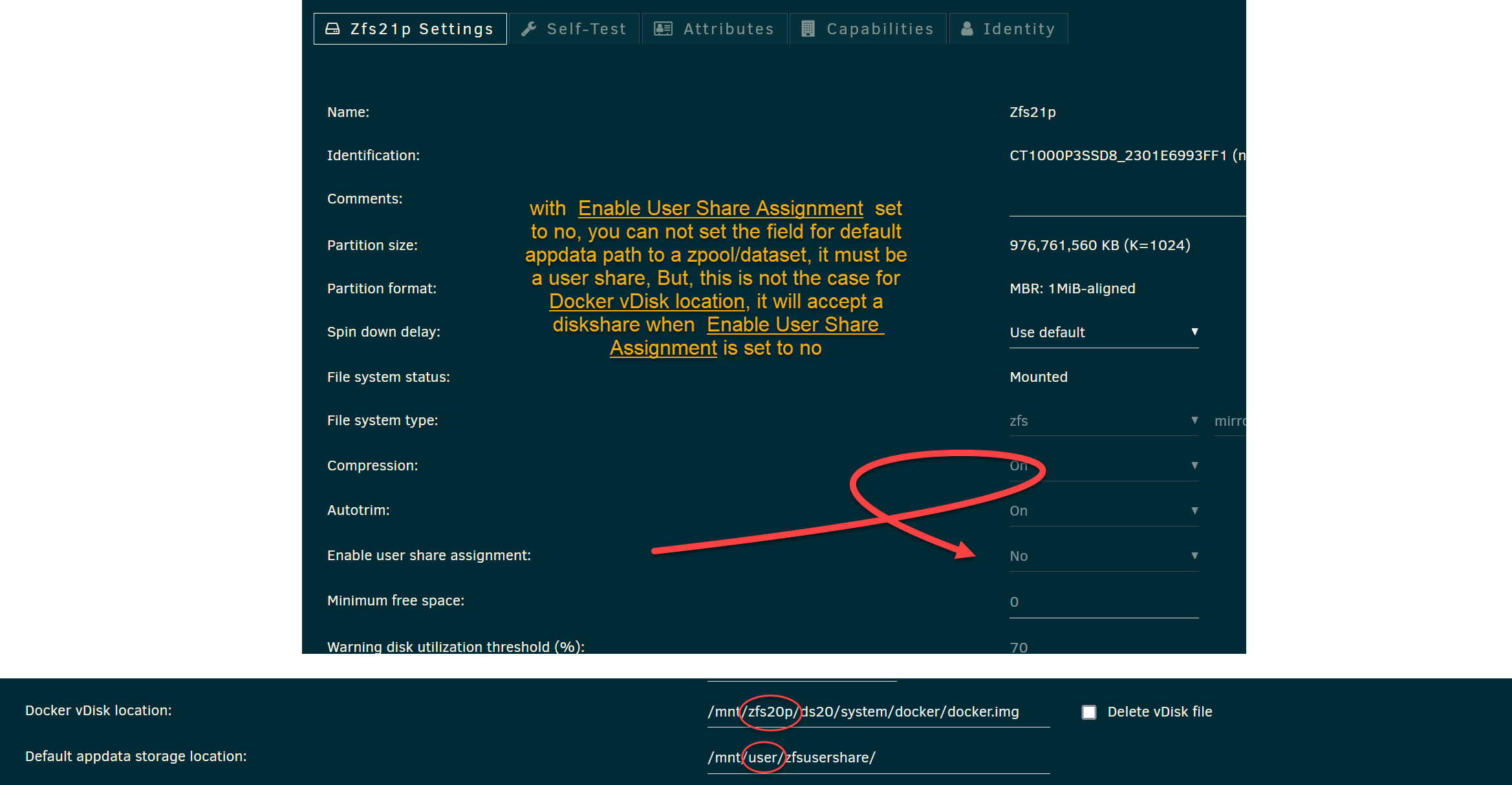

additional question,  in the docker config, it appears that you can not select a zfspool/ as a appdata default storage location,  is this by design or a bug ?
docker vdisk can be set to zfspool, but not appdata

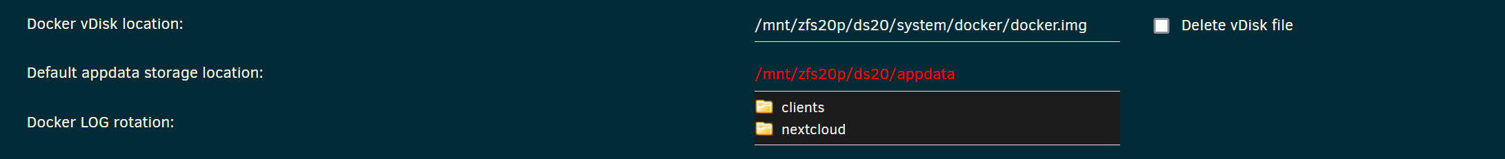

You can use zfs storage for appdata, does the appdata folder exist?
yes appdata does exist (on the pool not the array)

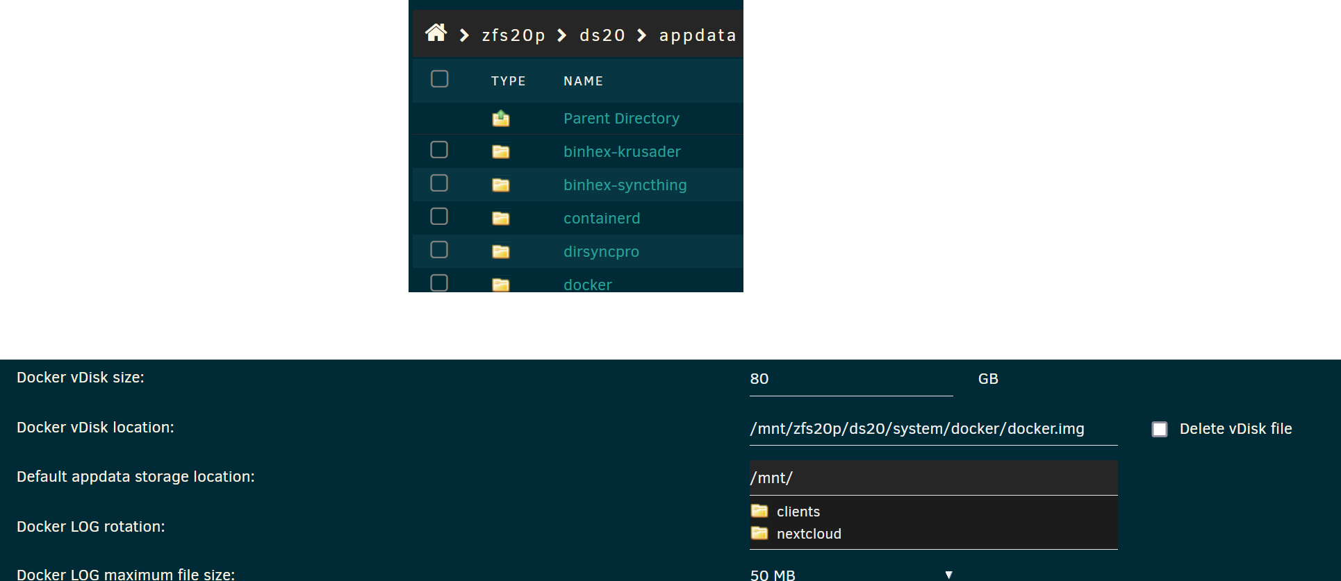

when i select the dropdown for default appdata location, it only shows shares i have on the array
Disk path also works for me.
I set Enable User Share Assignment to no, due to I was having issues with RC5 where the data in the user share could be different then  what was in the dataset disk share.
that is how i found that appdata path could not be set to a zpool if enable share assignment is set to no. but you can set the docker vdisk location,
Possibly the  issue  with different data in user share and the pool dataset no longer an issue with RC6 ? sounds like some changes where made regarding using bind-mounts in zfs.
