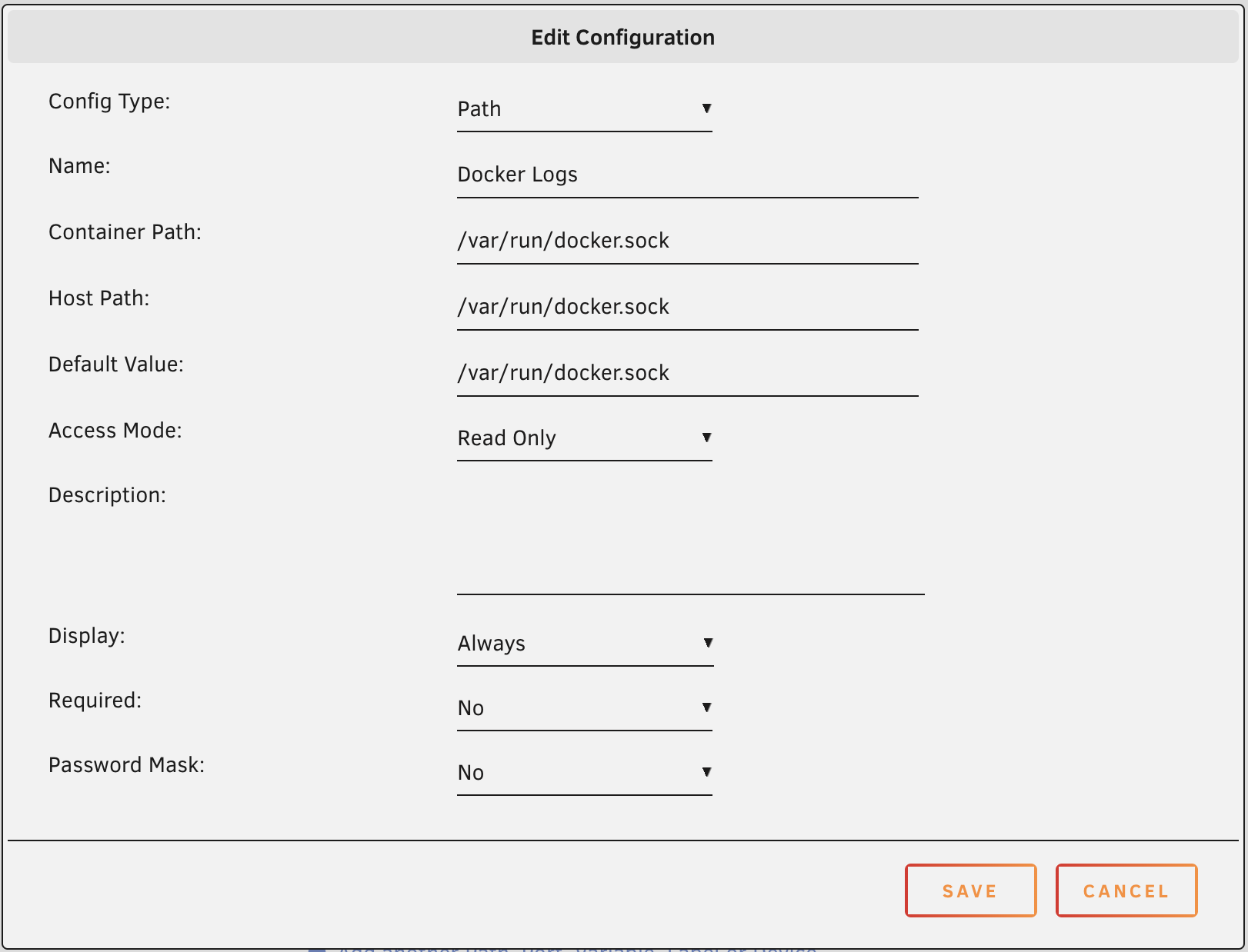

Unraid Docker Logs
To ingest Unraid's docker logs using Vector, the container needs read-only access to the unix socket Docker listens on. The default in Unraid is /var/run/docker.sock
Add the below path configuration to the Vector container:

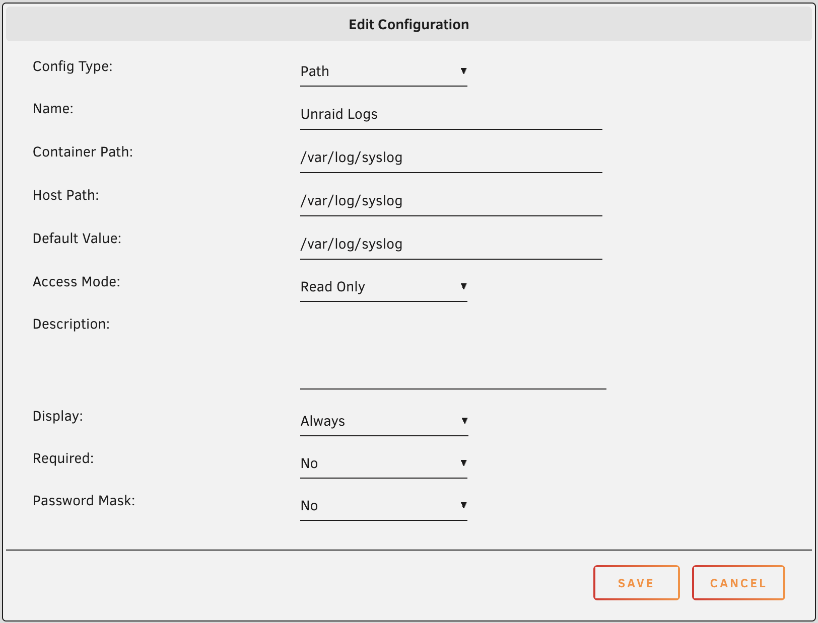

Unraid syslog
To ingest Unraid's system logs using Vector, the container needs read-only access to the syslog file. The default in Unraid is /var/log/syslog

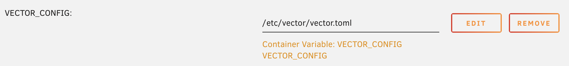

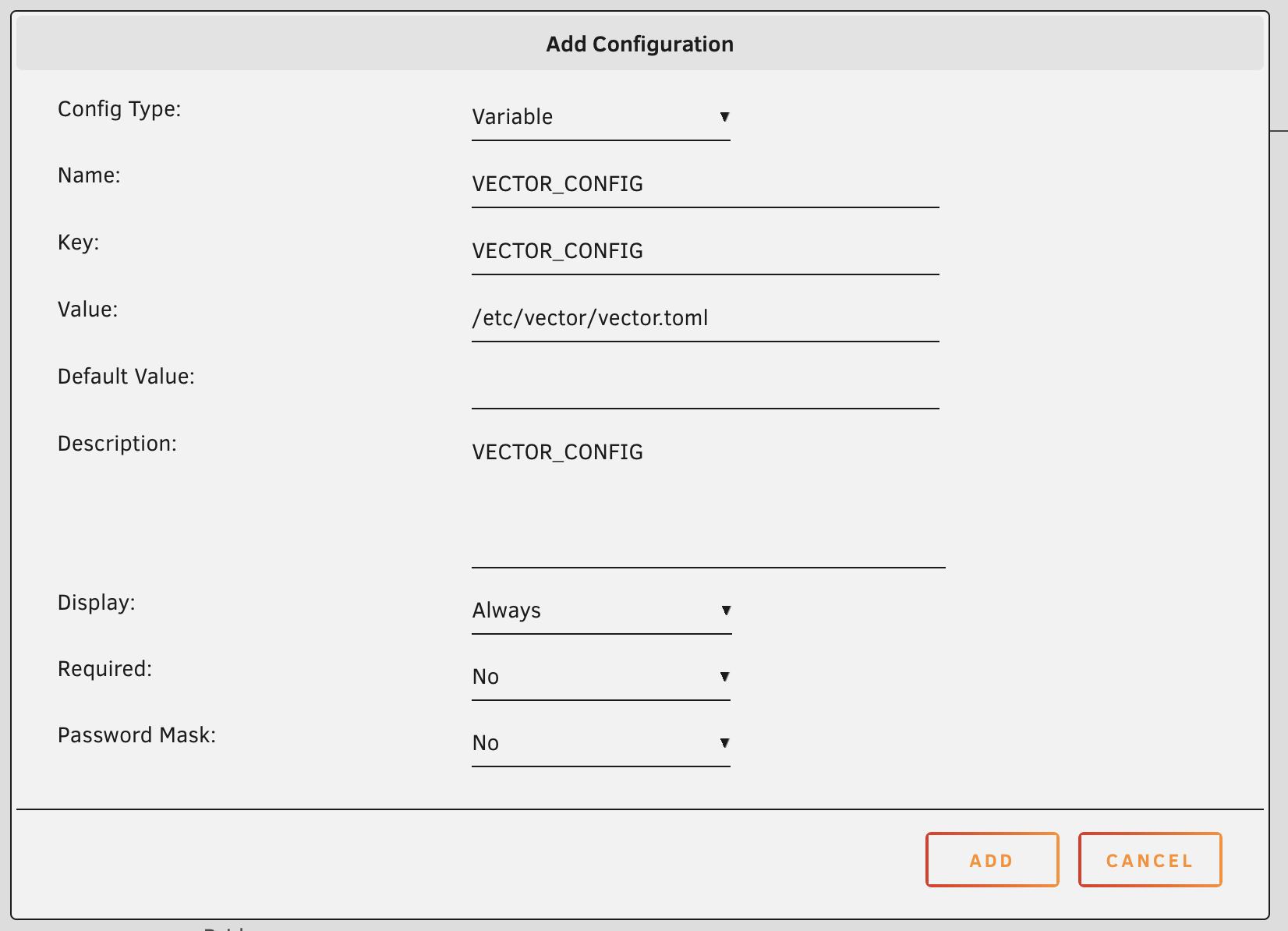

Hi Steve, you can fix this by adding a new environment variable to the docker container configuration in Unraid. Please see screenshots below
Type: Variable
Key: VECTOR_CONFIG
Value: /etc/vector/vector.toml
