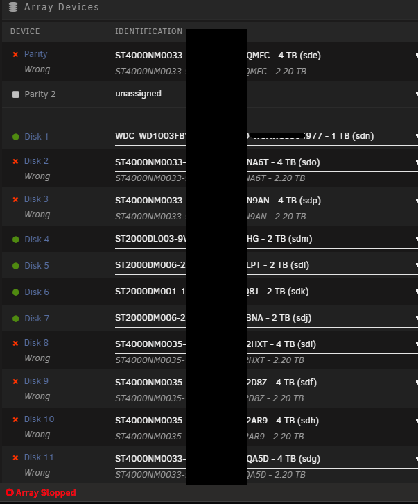

I have recently upgraded my server hardware. My old server had an older controller that could only read drives up to 2.2T not knowing this at the time i installed 4T drives as some of the replacements.  The server continued to work but only allowing me to access T2.2 of the 4T it was not an issue at the time as i was moving from 1T so it was still over double the storage. I recently migrated to a new server that sees all 4T adn because of this some drives came up as wrong. So i did a new config and mapped the drives manually now i'm gettig "Unmountable: Unsupported partition layout" These drives can not be formatted they still have my data. How do i add them back to the Array?

This an old screen shot I took before I did anything I since did a new Configuration and re-synced parity. yes the original disks are still in ill give it a shot. Really appreciate the help
