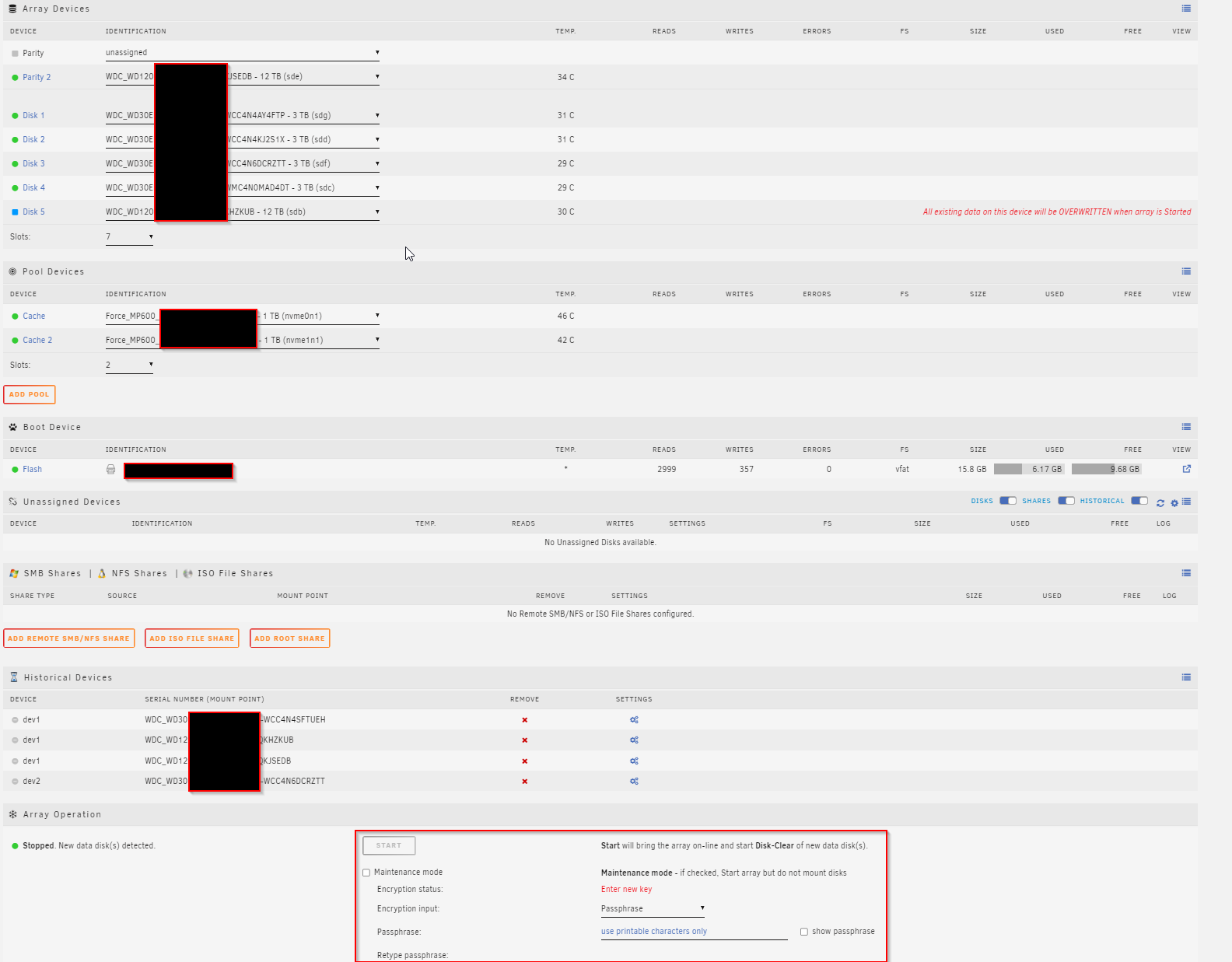

Next: i want to add the second 12 TB as Data Disk,
  • setting slots form 6 to 7 and select the new disk for slot 7
  • i can't start the array as it wants me to add a passphrase for encryption (i have no encryption setup)
  • is it possible to add the disc without encryption?

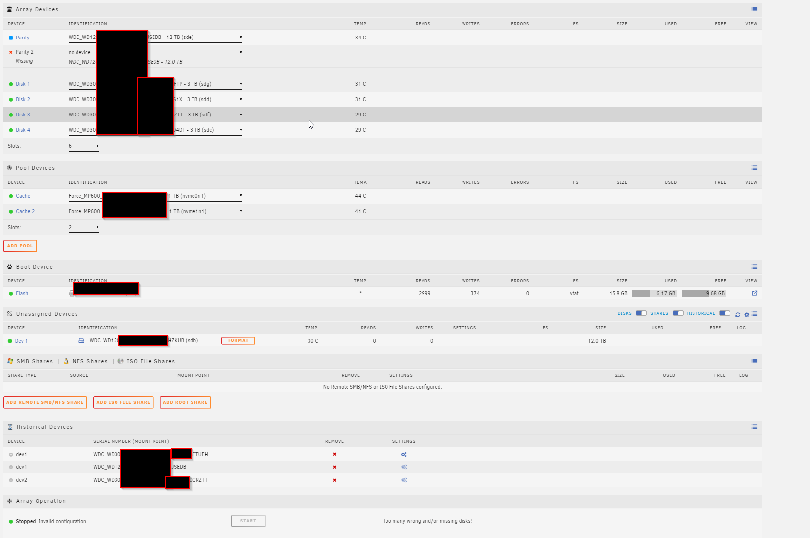

Next 2: i want to move the Parity Disk from slot 2 to slot 1
  • Does it have negative side effects only having parity slot 2 and slot 1 empty?
  • Trying to move the disk to slot 1 i get: "Too many wrong and/or missing disks!"
Screenshot Question 1 Adding a Datadrive requieres Encryption:
Screenshot 2: Trying to switch Parity to Slot 1.
Sounds like you have encryption set as the default under Settings->Disk Settings?    Regardless you can click on the drive on the Main tab and set its format explicitly to a non-encrypted file system which should now let you start the array.
Unraid will be quite happy if you want to leave parity1 slot empty.
You cannot combine removing parity2 and assigning parity1 into a single step.  Moving parity2 to the parity1 slot involves
  1. Stop the array and unassign parity2
  2. Start the array to make Unraid 'forget' the parity2 assignment
  3. Stop the array and assign the old parity2 to parity1
  4. Start the array to commit the change and build the contents of parity1 (it uses a different algorithm to parity2).
Until step 4 completes your data will be unprotected against another drive failing.
Thanks for the quick help, that solved it.
