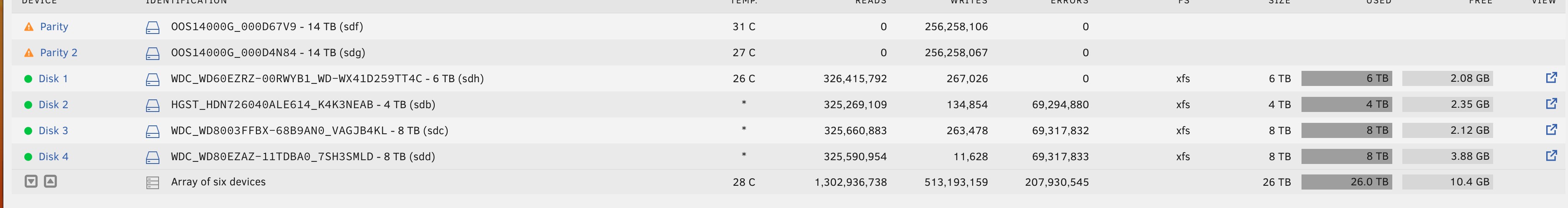

I have a 26TB array that is out of space.  It has dual parity using 2 8TB drives.   I bought 2 14TB drives.  I replaced one of the 8TB  parity drives with one of the 14TB drives and started the array and it started doing a parity re-sync.  It ran ok for a couple of hours and now I'm getting a crazy number of read errors on 3 of the 4 data drives.  What could possibly be going on here?

I've checked smart status on the drives and done short tests.  Drives appear ok?  They also have have fans blowing on them and do not appear to be hot.

please attach your diagnostics, there could be some information in them.
lots of line like Jun  9 11:32:18 Vault kernel: md: disk3 read error, sector=2045235784
Jun  9 11:32:18 Vault kernel: md: disk3 read error, sector=2045235792 in the log

Looks like the fairly common Ryzen onboard SATA controller problem under load, look for a BIOS update, you can also try v6.12-rc7, newer kernel may help, if issues persist best to use an addon controller, or use a different board.

ok, checked BIOS update.  There was one but only from 1 month ago with next to nothing in changelog.  Didn't apply.  Updated to 6.12-rc7 which was very smooth.    I already have a 4 port external card so I moved two of my drives off the APU Sata ports from the board to the card.  Now there is 4 drives connected to the chipset sata ports on the board and 4 drives connected to the external card.  Restarted parity sync.  Fingers crossed.
