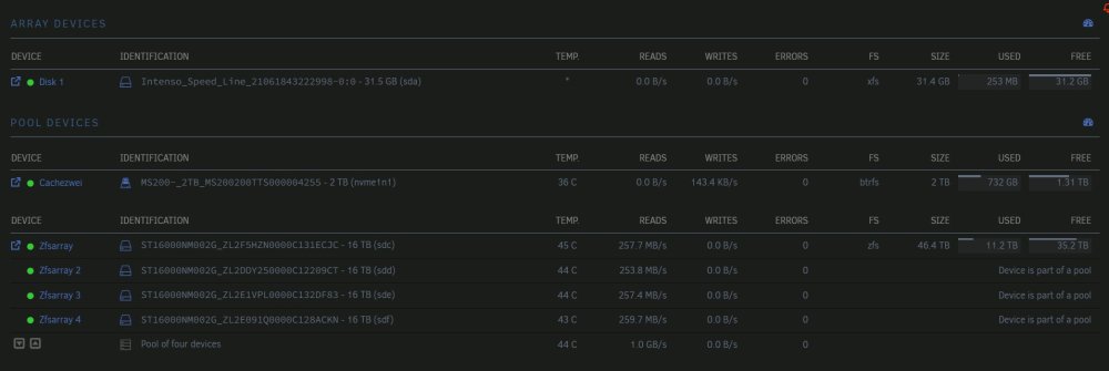

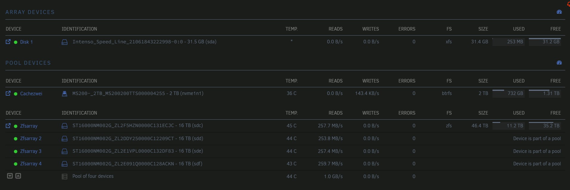

Currently you need to have at least one device in the array. I use a single small usb flash drive.
Hello there you need atleast one HDD/SSD/Thumbdrive as an drive in your array then you can setup any Pool you want.
I think you want something like i did here.
Aha! Do you have it as the parity disk or member disk, or does it matter?  Then I can create my ZFS pool?
no parity disk just one "menber" Disk.
Yup, @domrockt that's exactly what I was trying to do.  Ok, I pushed the button and set them in the Unraid Array.  I'll stop it, find a spare USB drive and do that.
I'd give you both credit if I could.  :)
No thing, the community helps a lot, Unraid is amazing.
