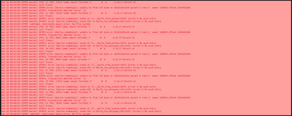

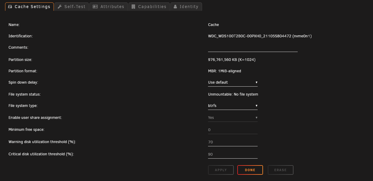

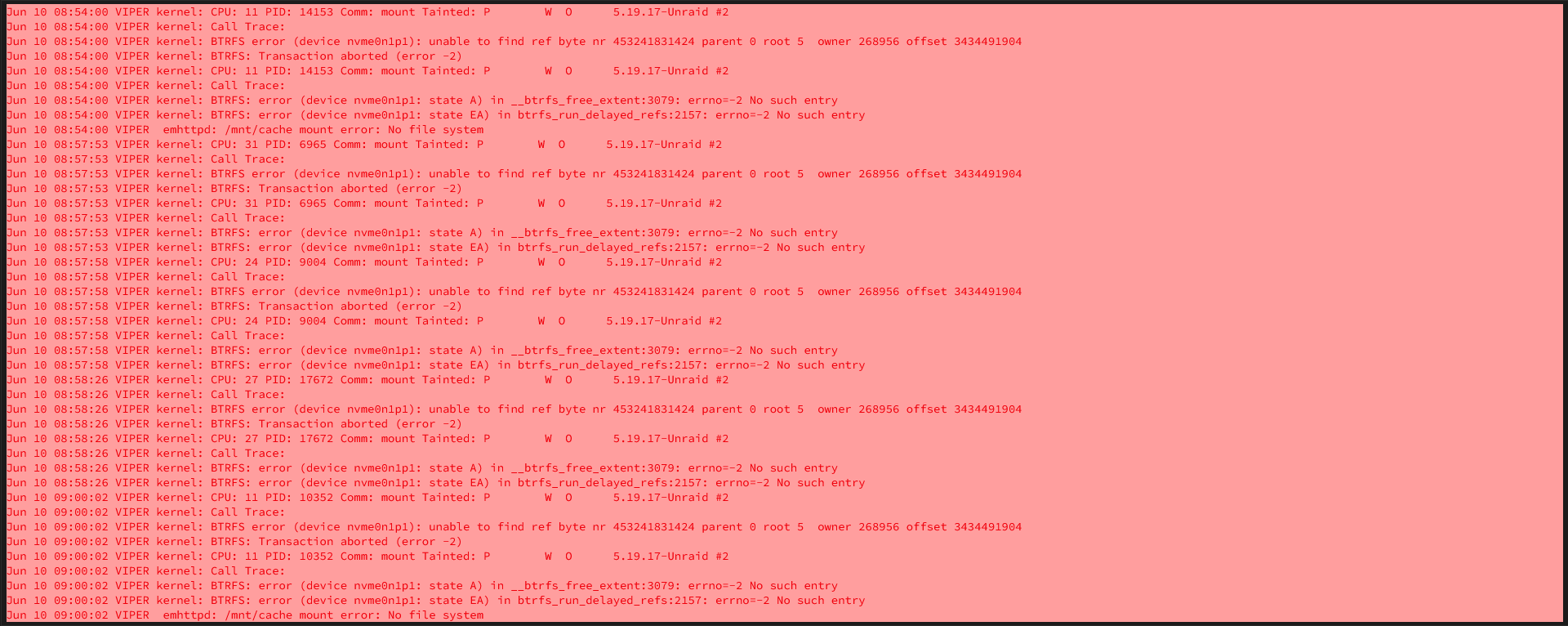

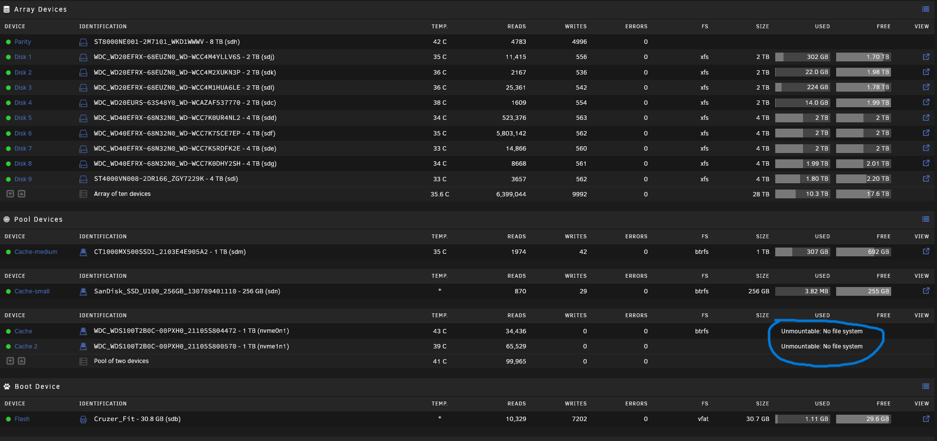

Hello everyone! I rarely post because I usually figure out issues myself as a long-time user of Unraid. However, I'm currently facing a problem. This morning, I woke up and noticed that my dockers had frozen overnight. When I accessed the Unraid WebUI, I saw that my main Cache pool was labeled as "Unmountable" (refer to the picture). This cache pool stores the following:

mount: /temp: special device /dev/sdnvme0n11 does not exist.
       dmesg(1) may have more information after failed mount system call.

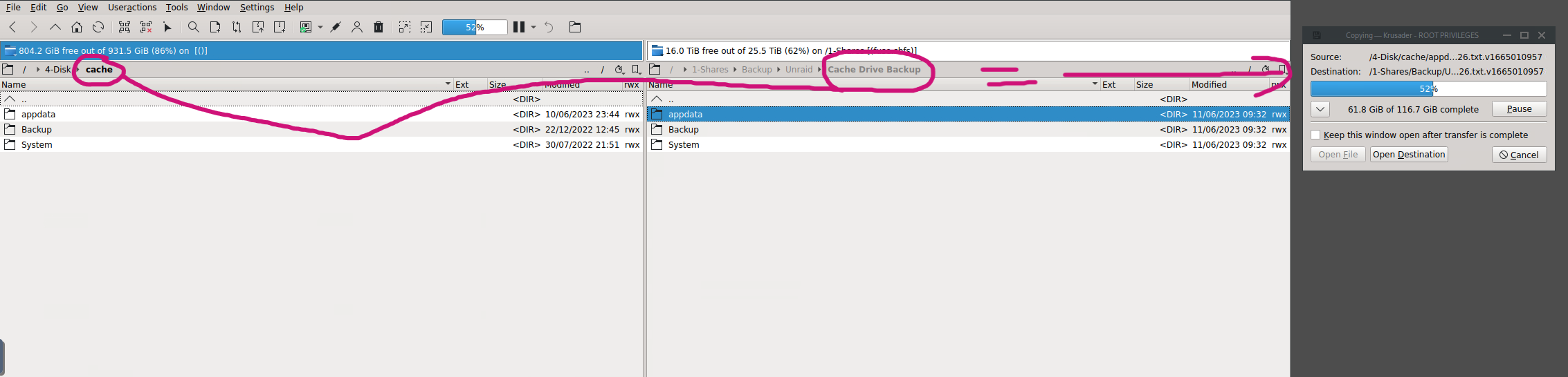

Thanks I did what you asked. You might see some dockers now in the logs. These are ones I just manually created to get my server up and running again. What's crazy is after I ran your command you gave me and rebooted the drives are back??
btrfs rescue zero-log /dev/nvme0n1p1
I started to backup and will make sure that my CA Appbackup is running again in the future. I just need to know if I need to set any CLI flags back or your recommendations?

I want to add that I think I recovered everything and backed up my data. I really appreciate it. I also set back up CA backup again "properly".
