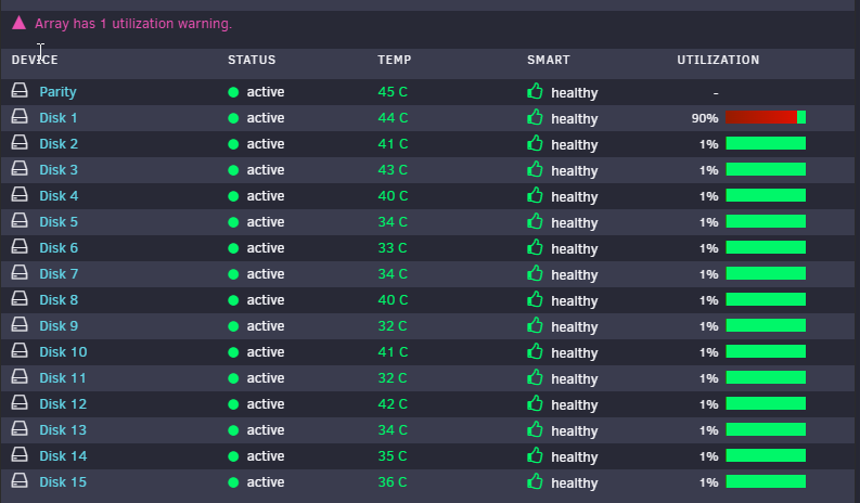

Hey, at what point will it start to use the other disks? or have I misconfigured something?

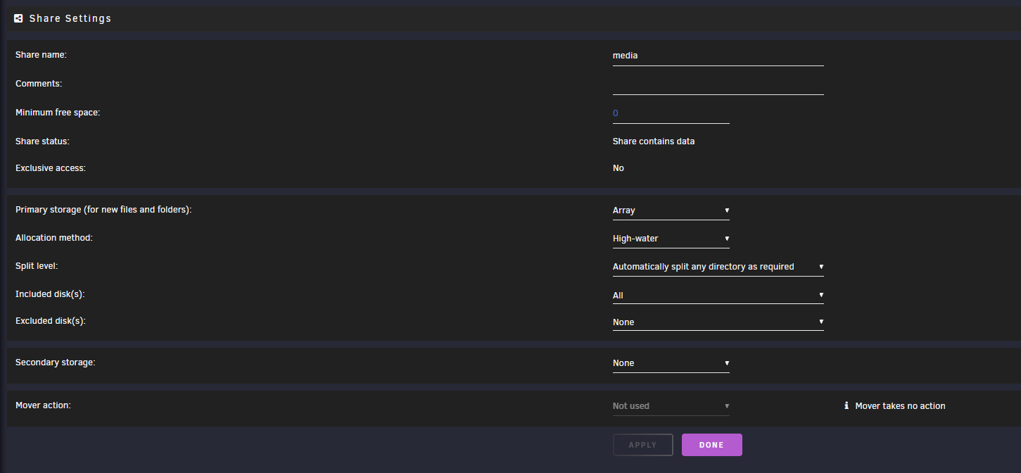

I have just set the minimum free space to 20% to see if that changes anything
Cannot see any obvious reason why the files are only going to the first drive :(  Maybe somebody else will spot something :) just as a check are you sure you are. Opting the files to the User Share and not explicitly to disk1?

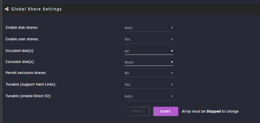

global share setting look ok to me

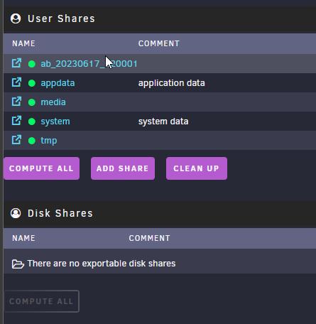

1 hour ago, JorgeB said:
Just to make sure you are writing directly to the user share, not a disk share, right?
How can I be sure? From this screenshot I would say it's a user share. It's the media share in question
Where are you writing to? Is it over SMB or locally? And in any case post the path you are using, like //tower/media or /mnt/user/media
It's all local. if I look at Sonarr for instance, the path variable it `/mnt/disk1/media/tv/`
haha I think I see my error. I need to change Sonarr from `/mnt/disk1/media/tv/` to `/mnt/user/media/tv/`?

It will not affect it at all.   Unraid does not move data between array drives by itself.
