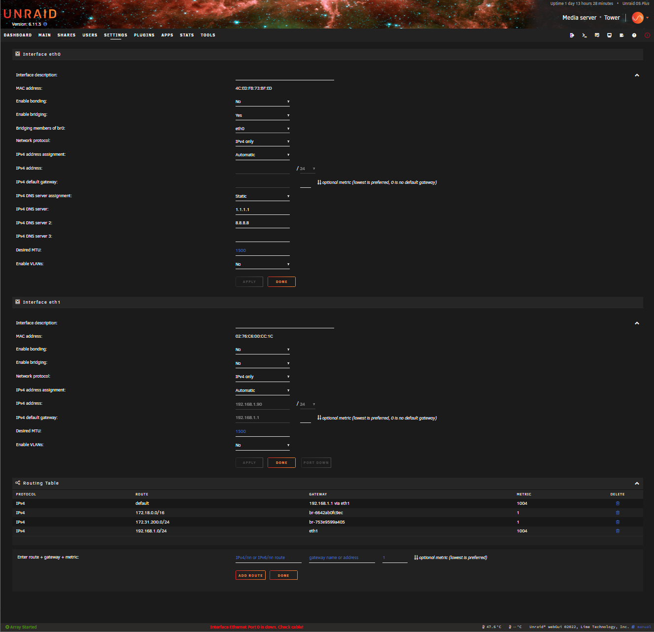

I have two NICs in my system; a 1G NIC built into the motherboard which is unused, and a 2.5G NIC on an external card which is the primary network connection. Originally, I had the 2.5G NIC setup as eth0 and the 1G NIC setup as eth1, which bridging, etc. turned on on eth0 for my VMs. However I discovered that after a reboot my VM wasn't able to connect to the network and upon further investigation it seems that the NICs have switched places, with the 1G NIC becoming eth0 and the 2.5G card becoming eth1, which has bridging disabled. Is there a way to lock a NIC to a particular interface so that it doesn't change at reboot?

I'm sorry, I must be missing something obvious but how do I do that on this page?
The 2.5G NIC is being set as eth1 in this SS, I want it to be eth0.

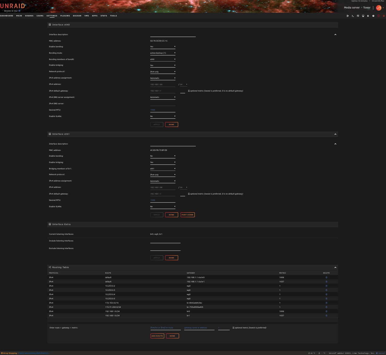

Upgraded to 6.12.2, still no menu to set the NIC assignments. Also 6.12.2 caused my array to no longer stop properly, fun :(
