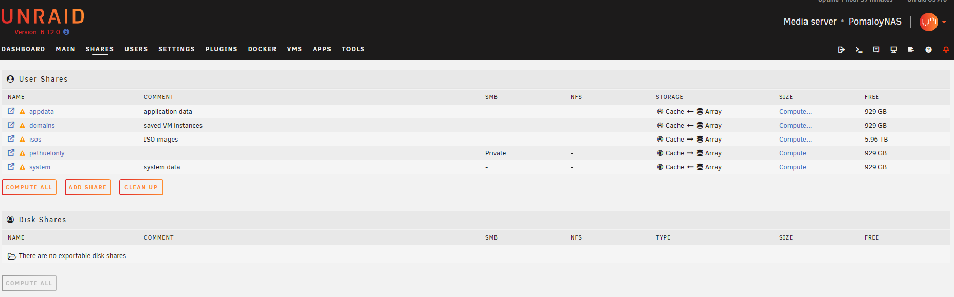

Was dumping some files to server then transfer stopped. Network drive icons in windows file manager suddenly showed (x) mark. Checked Unraid web interface and found that user shares are gone (except for 1).

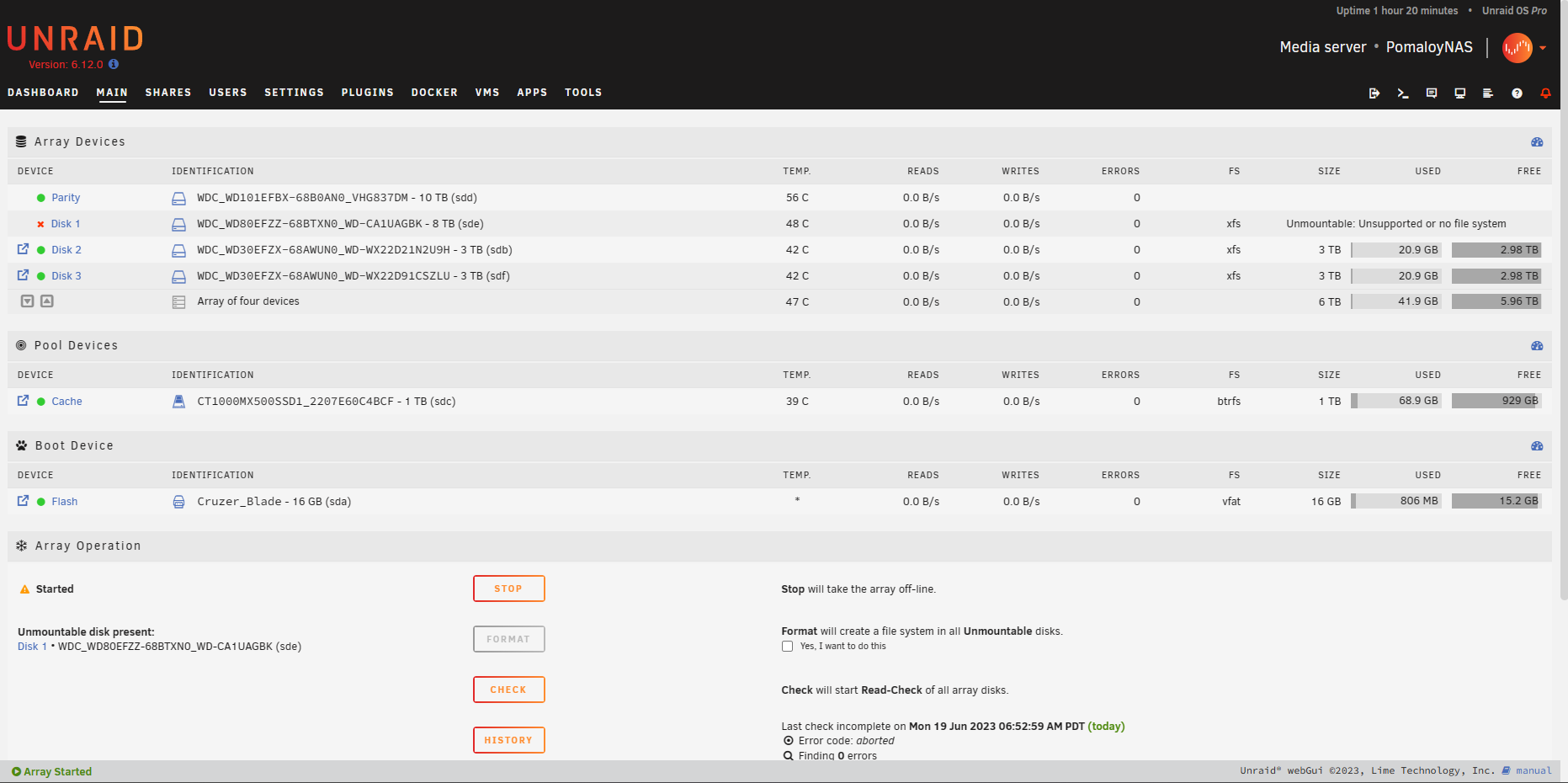

Array also shows Disk 1 unmountable.

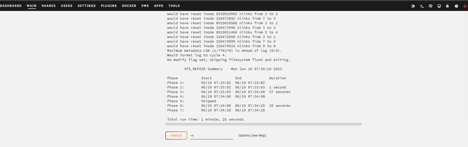

-nv check yielded a lengthy log. Showing here end of log.
What am I supposed to do next?
Run it again without -n or nothing will be done, and if it asks for it use -L

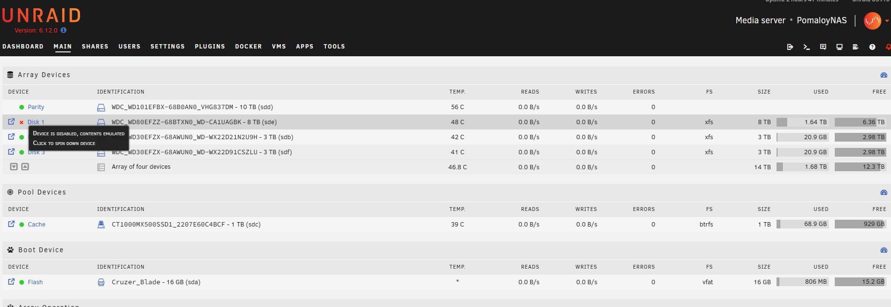

Thanks. Ran a -L repair and seems like the user shares have come back. I can also access most files though I am not sure yet if there were any data loss.
Still, the disk 1 shows an x in the array. and when hovered on shows (device is disabled, contents emulated).
That is expected - the repair process updated the emulated disk, not the physical one.   It takes a rebuild to clear a disabled state.
does the rmulateddisk now have a lost+found folder on it?   That is where the repair process puts any files/folders for which the name cannot be found.
Hello,
Yes there was a lost+found folder. Seemed like the xfs_repair did its thing. When you mean "rebuild to clear a disabled state", can you link me to guides to achieve this. Thanks.
