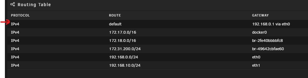

For some reason, each time I upgrade to a new version of unraid, I can't route to outside the network. I discovered it's because the default route is missing.
In the file attached, you can see the line I have to add manually in order to restore outbound network access.

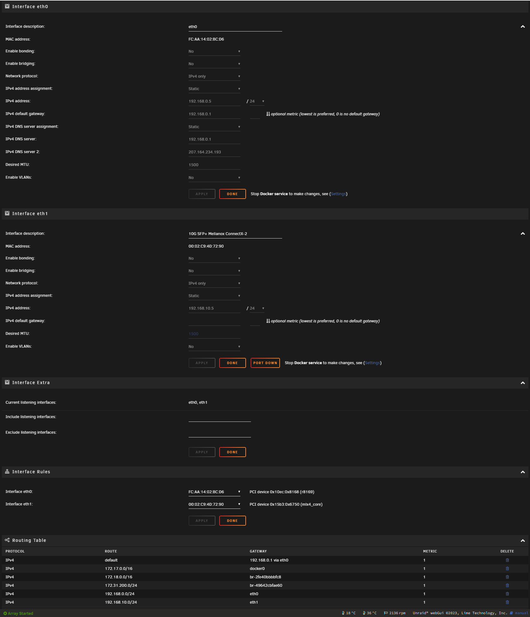

I see two (see below)

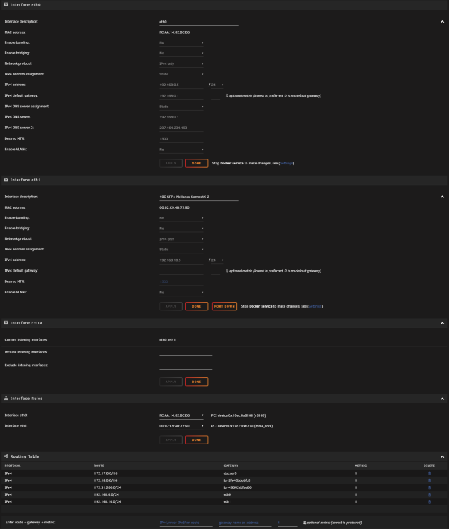

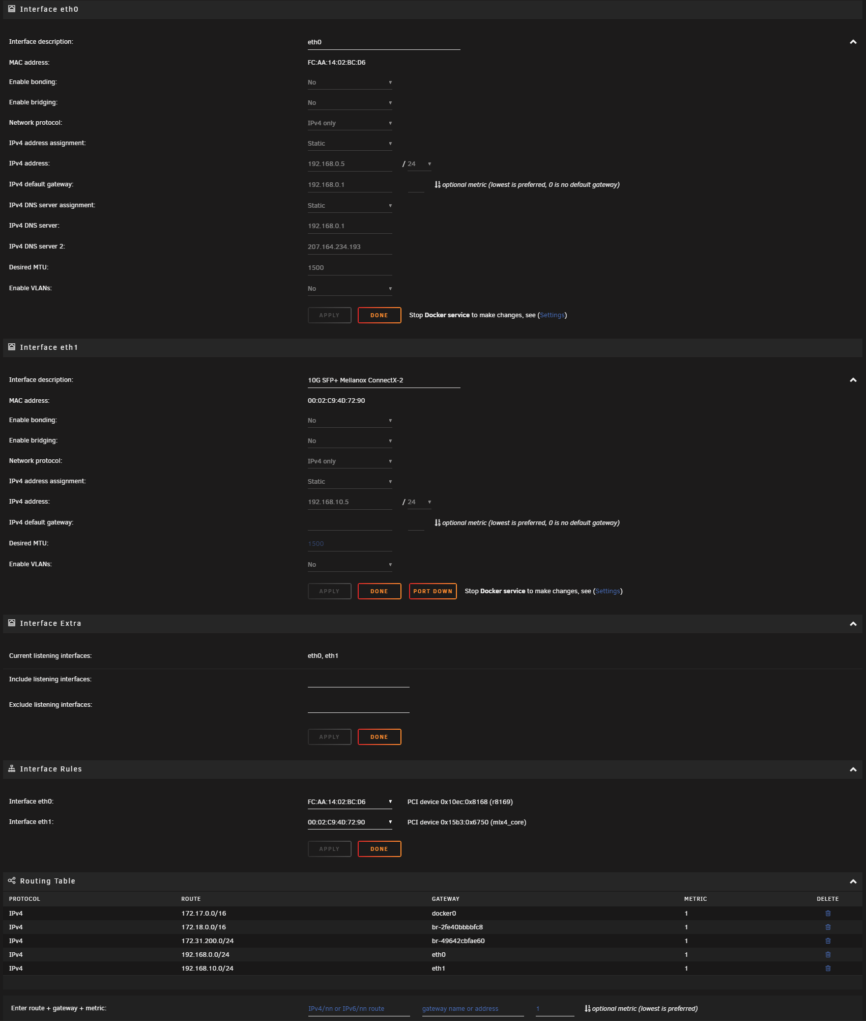

I performed the following as you instructed:
  • Made a dummy change to eth0 - I changed the default gateway, applied changes then changed the value back, applied changes
  • Rebooted. Default route missing again, no route to internet. Screenshot below. Diagnostics after reboot attached.
Last year I did make an attempt to add a usb-based NIC but it's no longer connected. This might be the root of the problem.
Thanks again.
