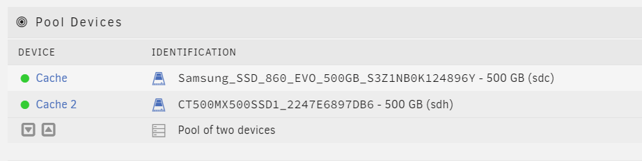

Cache pool settings
Reboot to clear the logs then run a new scrub and post new diags.
