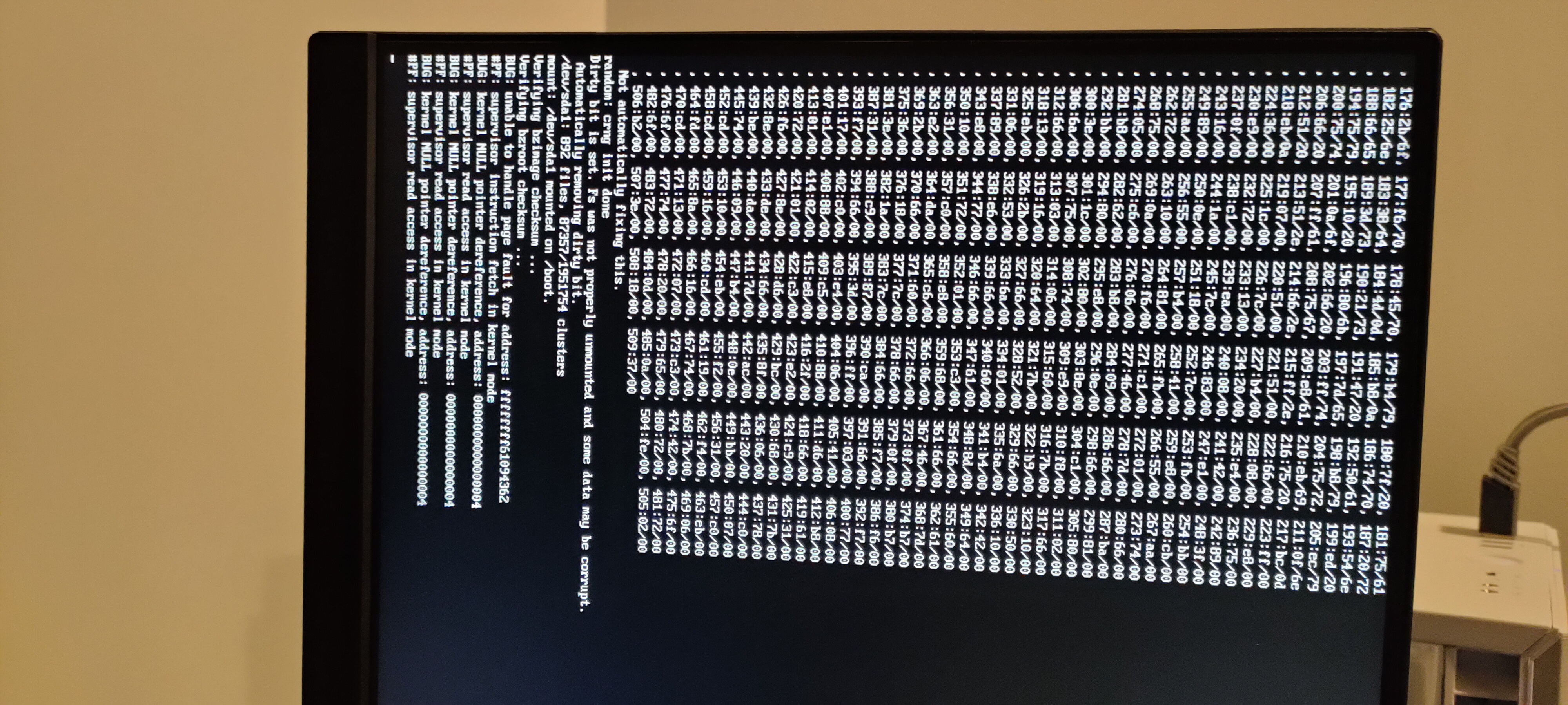

July 4, 20233 yr Due to broken parity on both of my drives (hard crash during parity check) I rebuilt parity on both of my parity drives. After the rebuilds had finished I ran a non-correcting check and it was stuck at 0 errors, less than one minute remaining for 24 hours. I used the web GUI to reboot and now it rebooted with a kernel panic error. I have attached a photo of the error for those who might understand it better than me. Is there anything I should do to fix the parity check and kernel panic ie just reboot, new flash drive etc? I have left it in this state because I did not know if I should try and get logs (if that is even possible) before rebooting. Edit: Attached syslog in below comment now that I know it was accessible from this state Edited July 4, 20233 yr by AngryPig

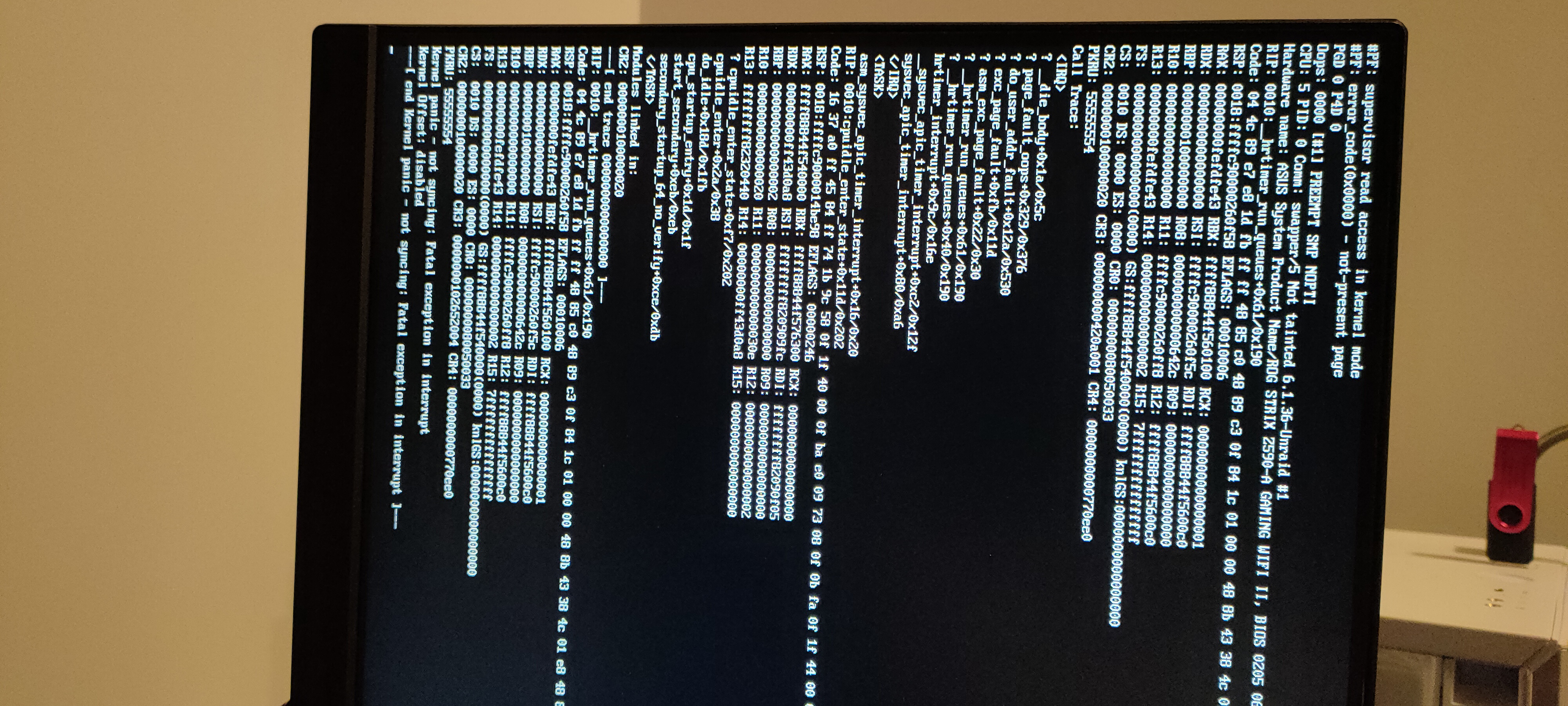

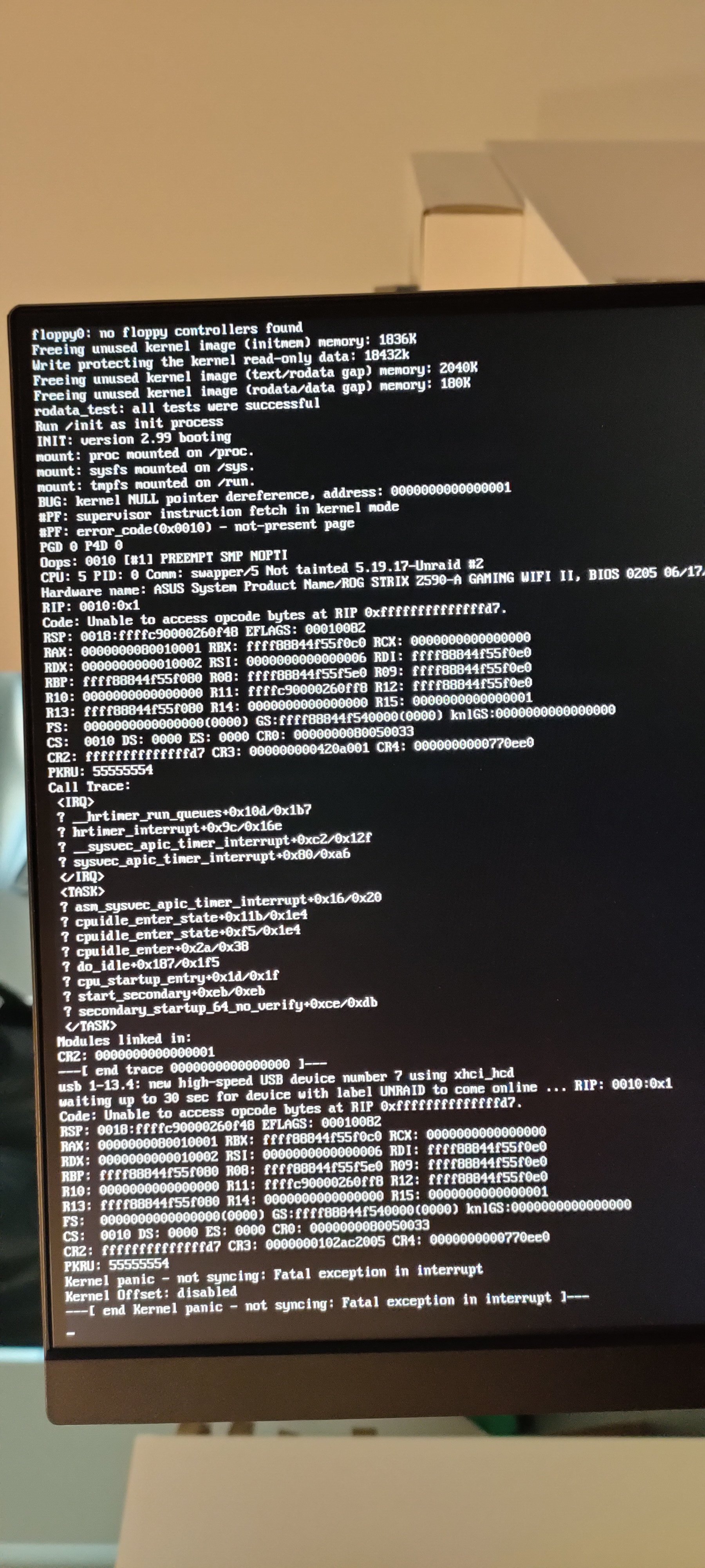

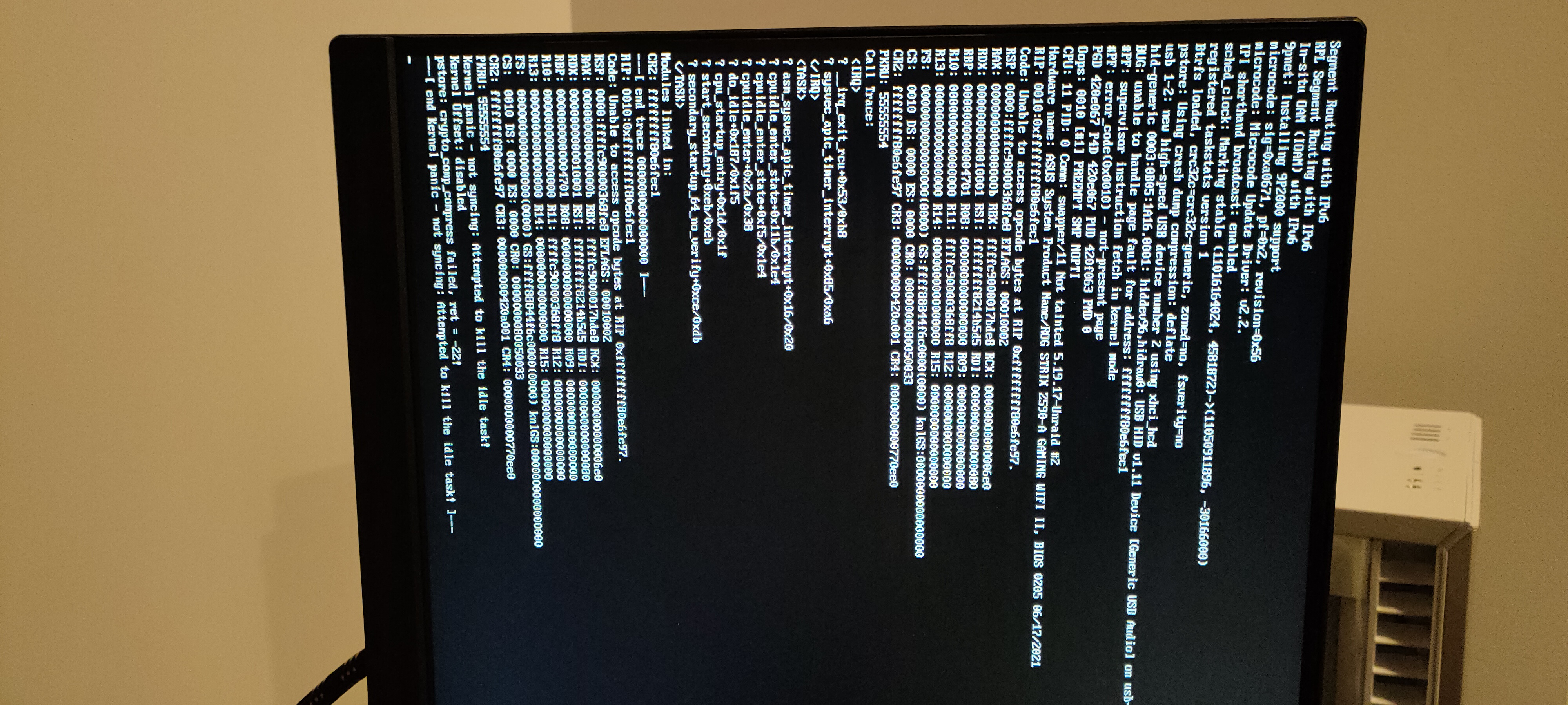

July 12, 20233 yr Author On 7/5/2023 at 12:59 AM, JorgeB said: Not really, but they look more hardware related. New update, it keeps having 'kernel panic' on startup now and if I try go to safe mode it gives me a kernel null pointer dereference error. I built a new USB with a trial license and tried booting to it and I also got 'kernel panic' so that pretty much confirms hardware I guess? Would it be worth booting into Ubuntu or Windows on a spare HDD or bootable USB to test the machine to try identify issues? I want to run all my options before going out and buying new hardware to start swapping parts Edited July 12, 20233 yr by AngryPig Added pictures
July 12, 20233 yr Community Expert 1 hour ago, AngryPig said: I built a new USB with a trial license and tried booting to it and I also got 'kernel panic' so that pretty much confirms hardware I guess? It's my suspicion. 1 hour ago, AngryPig said: Would it be worth booting into Ubuntu or Windows on a spare HDD or bootable USB to test the machine to try identify issues? It's worth a try, same for running memtest.
August 14, 20233 yr Author Solution On 7/5/2023 at 12:59 AM, JorgeB said: Not really, but they look more hardware related. Ended up being a faulty CPU. Had to RMA it.
