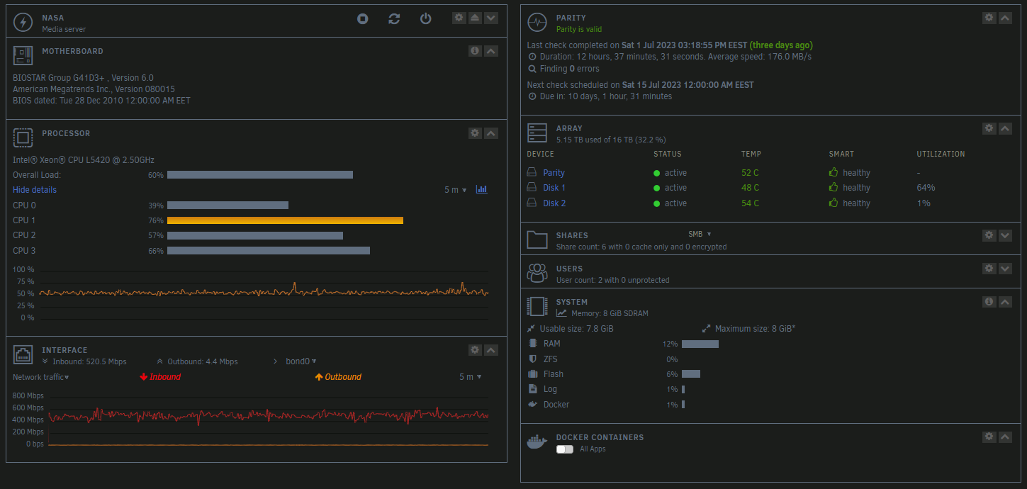

Anyways, back to my story. After configuring this system with two disks and a parity drive to backup my footage, I started transferring and I get like 1TB/day (around 20MB/s) and I don't see where the bottleneck might be. It's using only about 150Mbps out of a gigabit  connection, about 40% CPU and 16% of RAM. I'm using 8TB Ironwolf drives, however, they are limited to SATA 2 (3Gbps) by the old Xeon CPU. The initial parity check reported an average speed of 176 MB/s.

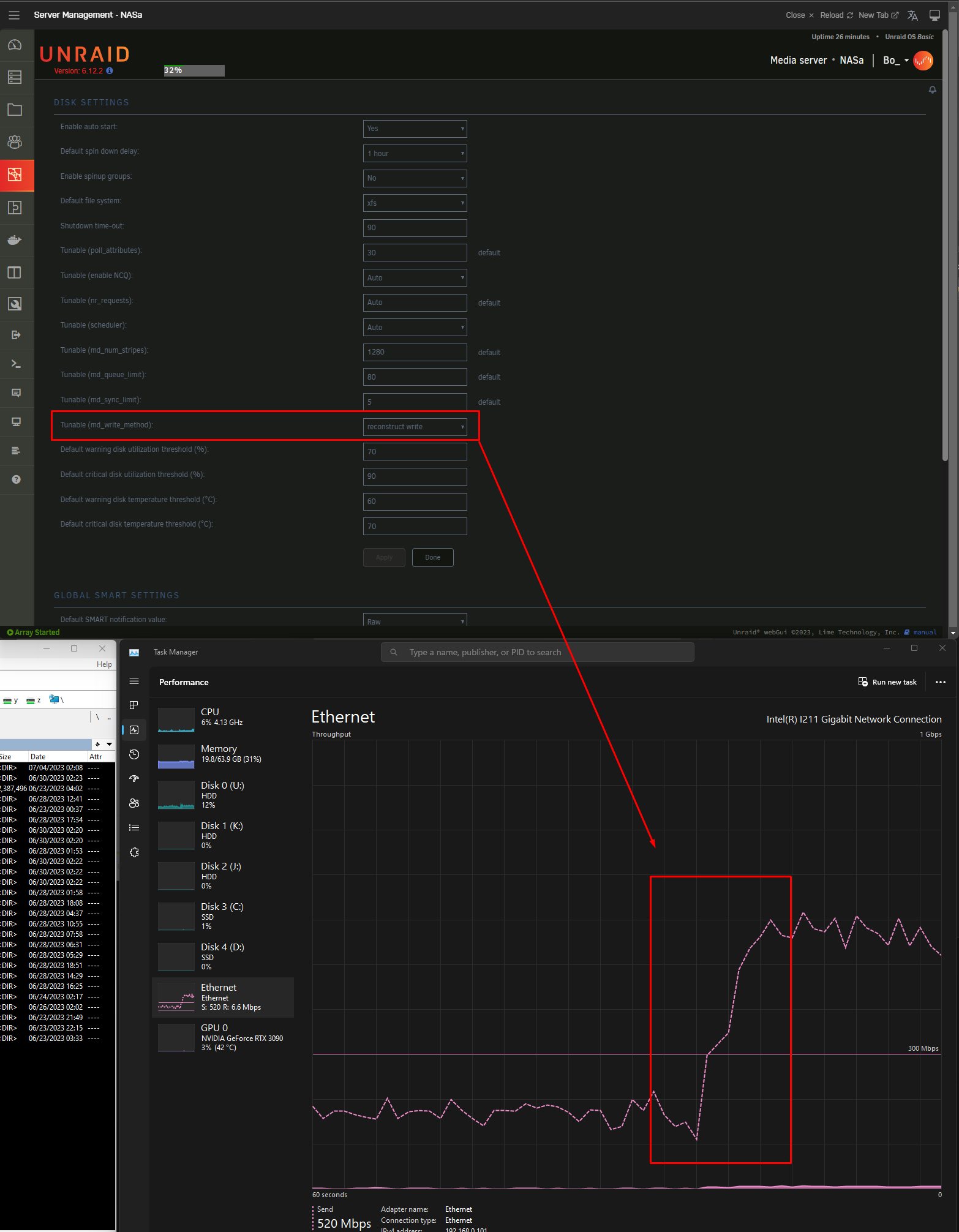

Did you enable turbo write?
Wow! Thanks! So it was a quick checkmark I was missing, indeed.
Here's  "the spike" I got when I switched from auto to reconstruct write (I'm assuming that's what you mean by Turbo Write).
Thanks a million!
