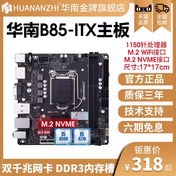

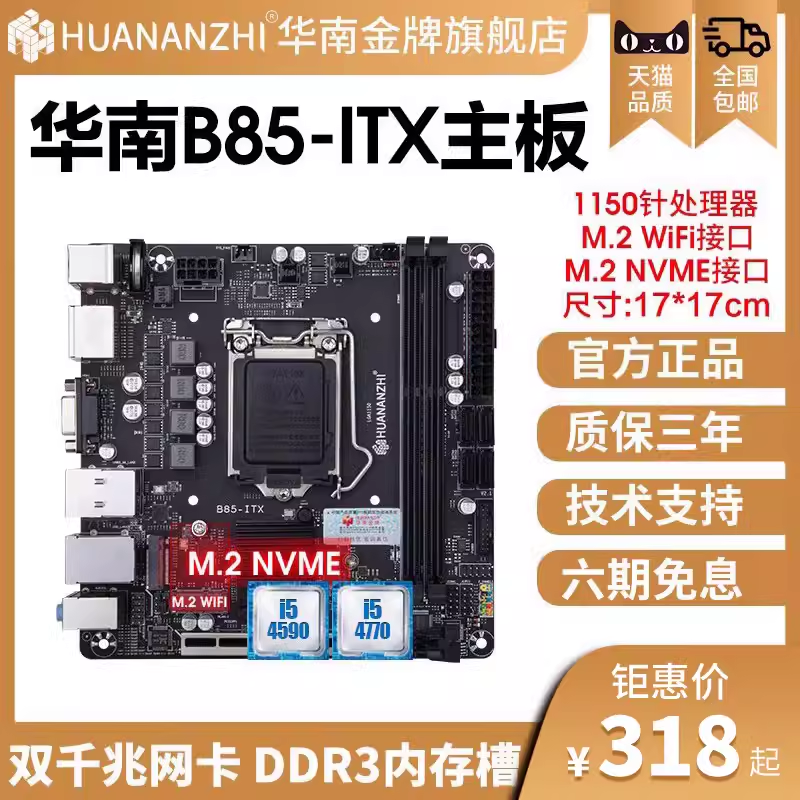

The other solution is buy a new 8 series mobo and give 2nd life for i7-4790S ( China have those 8 series new mobo very cheap ( less then 50usd ), dual LAN and support NVMe booting ( although you don't need that for Unraid ), build to ITX and SFX PSU and make it as small footprint as possible. I have buy one for a friend too, so far so good. ( But wrong BIOS setting will need CMOS reset )
You don't need 600w PSU, my 9700K build just use a 300w SFX PSU.

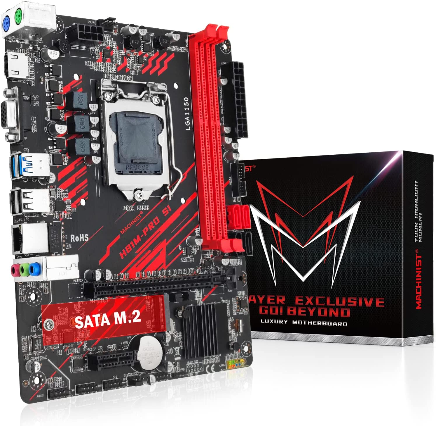

Or This one in Amazon ( but not support PCIe NVMe and single LAN ), size are DTX ( between ITX and mATX ), Cooler master NR200P support this mobo and max with two 3.5HDD.
https://www.amazon.com/MACHINIST-Motherboard-H81-Processor-H81M-PRO/dp/B09DVCV3LT

Thank you again,
I really like the idea of that mother board and rebuilding this thing. I think i will go with the new MOBO and a new case with proper cooling and call it a day.  Having a personal server has really been awesome for my family, they basically rely on it now, and it has become an essential friend. They cannot see life without one at this point.
