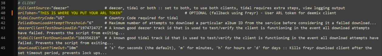

March 25, 20242 yr 10 hours ago, Mr_Jay84 said: I'm also struggling with this. Any ideas on how to inject the scripts into the container? I got it working. I followed the steps, made sure my folders where mapped correctly, and edited the extended.conf file. https://github.com/RandomNinjaAtk/arr-scripts/tree/main/lidarr For Lidarr 1. Create two separate folders in the appdata/lidarr folder. custom-services.d custom-cont-init.d 2. Download the script_init.bash and place it in the /custom-cont-init.d folder 3. Edit the extended.conf file with your Deezer Token, line 40. You may want to turn off the video script, line 10... I did not and it downloaded a lot of videos. Edited March 25, 20242 yr by djsnafu

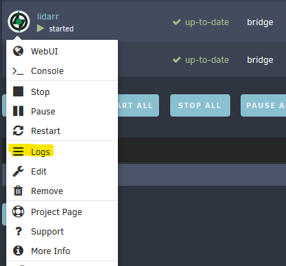

March 25, 20242 yr No just start the container. Open the Logs window and watch the status of everything happening. After its done downloading everything within the folder you'll restart the container.. it should then start working and grabbing things from Deezer. It really was pretty easy once I understood the only thing I need to do was to edit the extended.conf file Edited March 25, 20242 yr by djsnafu
