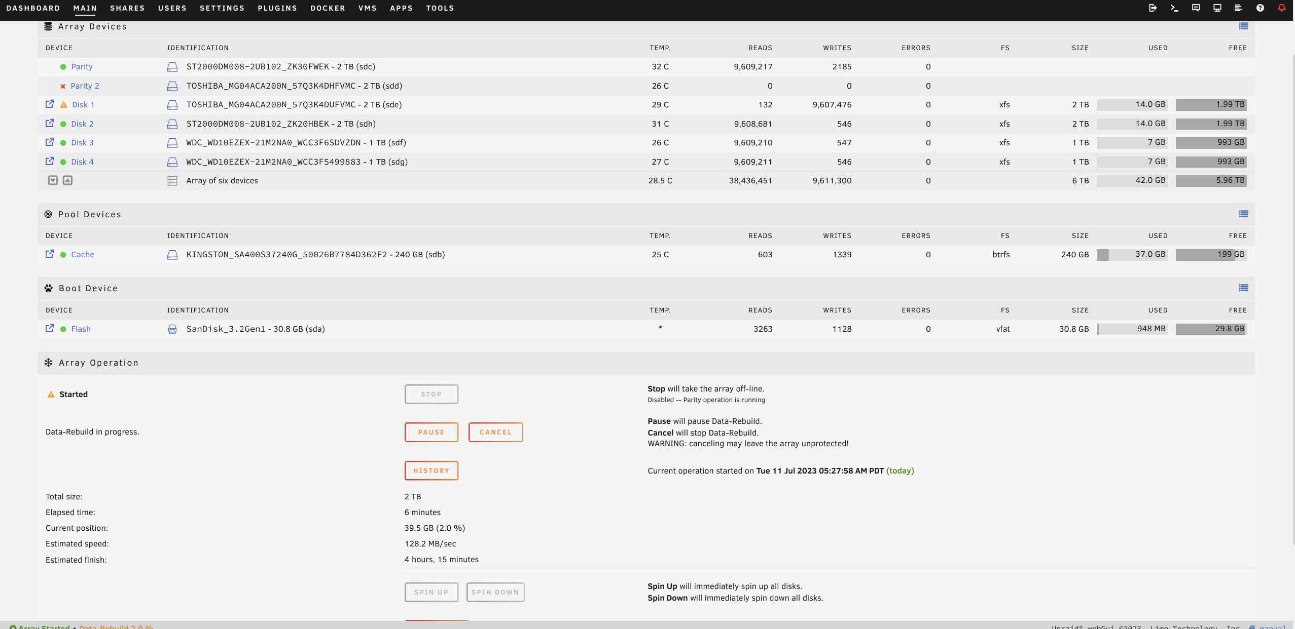

We are a small office and I've used Unraid for a number of years now at home and now at our office. Recently an Old drive went out, a parity drive, the array can withstand up to 2 faults so all was fine. upon placing drive in, format was needed for the drive, it rebuilt 2 terabytes and now I have 1 device disabled and one emulated with another rebuild taking place and my shares are gone. Maybe a few gigs of data nothing crazy.
But i've never had my shares just dip, a little bit worried right now with a sinking feeling and it sucks

Is there no ways to scan for files, should I kill the rebuild? If so what the hell is it rebuilding?
I feel like it did ask that and I didnt take it as a warning.... freaking crap
It's rebuilding the formatted (empty) disk, if the old disk is really dead and assuming no backups bet is a using a deleted file recovery util like UFS explorer.

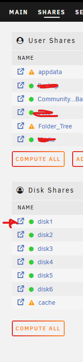

If you have Dynamix File Manager installed, you can go to shares and you will find this:
Now click on the icon in front of the disk where you want to see the contents and explore away.

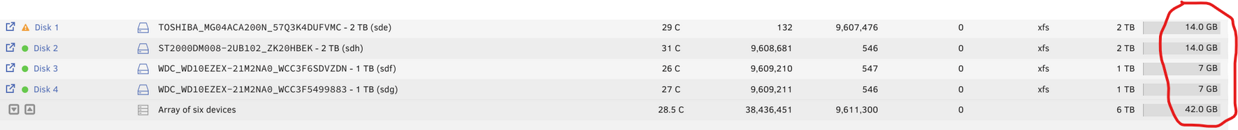

I just had a close look at this:
I would suspect that there is no data on any drive-- only the file system tables.
