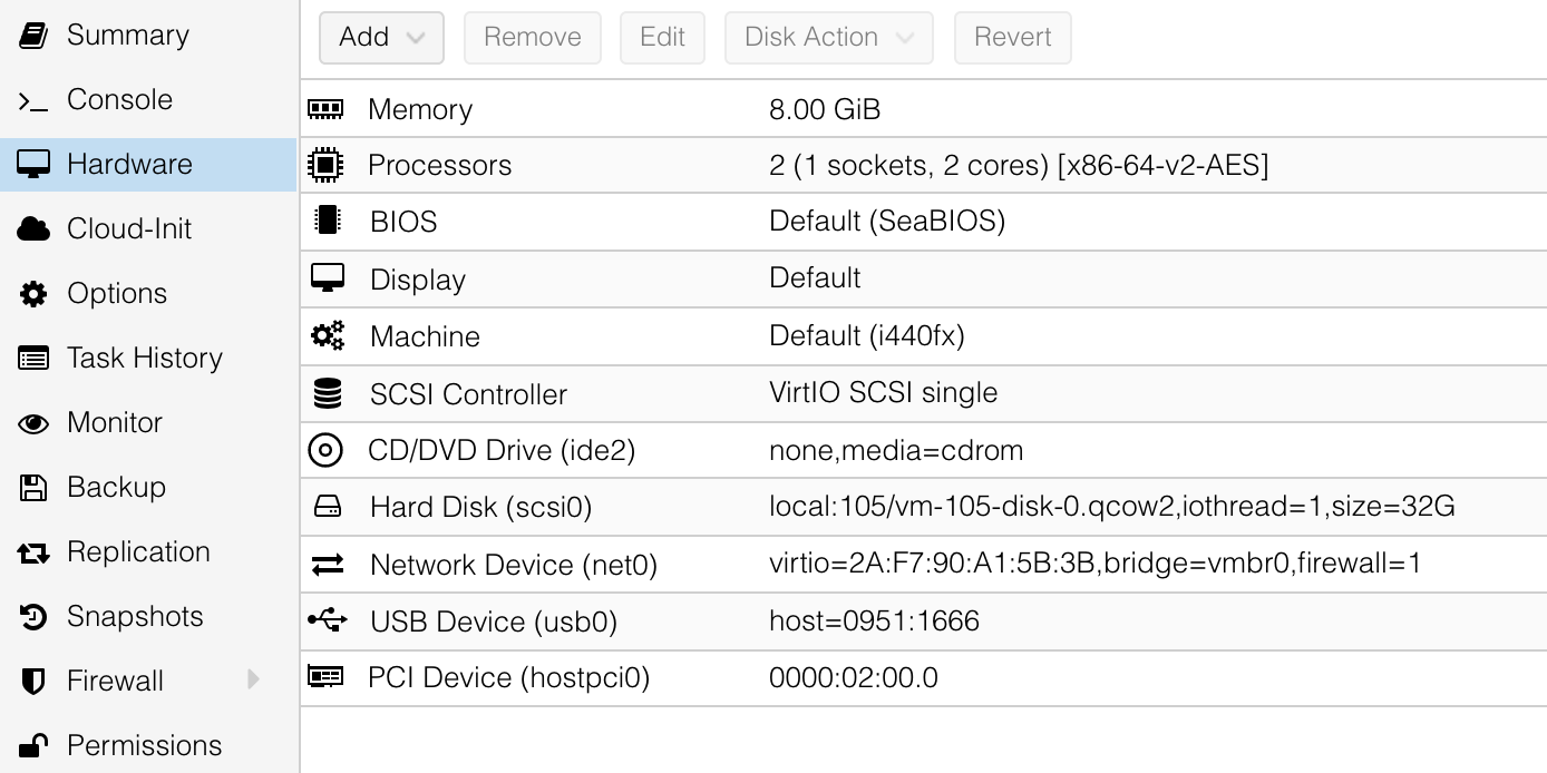

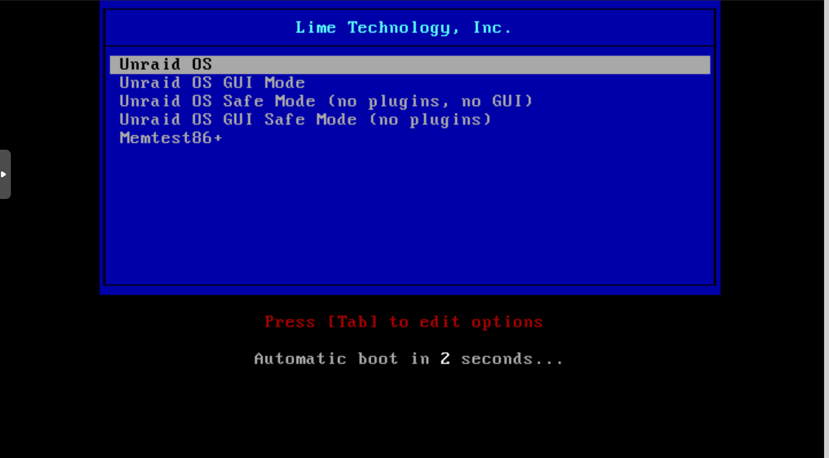

July 19, 20233 yr I am trying to install Unraid for the first time so I downloaded the USB Creator software and created the bootable USB flash drive. However, when I insert the drive in the target PC and attempt to boot, the blue Lime Technology, Inc. screen appears with an automatic boot timer that counts down from 5 to 1 then starts at 5 again in a continuous loop. If I hit enter on any menu option nothing happens. When I hit tab the /bizimage initrd=/bzroot prompt appears. I created a second bootable USB drive (same drive) but the same problem exists. I created a third bootable USB drive (different brand) and unselected the UEFI option but the same problem exists. I also attempted to create an Unraid VM in Proxmox and yet again experienced the same problem. I cannot believe that I spent an entire day trying to troubleshoot this issue. I am frustrated to say the least so I decided to join this forum. Can someone please suggest to me what I might be doing wrong. Supermicro X10SL7-F motherboard Intel Xeon E3-1245 v3 CPU 32 GB Crucial ECC memory 8x2TB HDD's Edited July 19, 20233 yr by nemo868

September 4, 20233 yr Hey, I had the same issue you were having with it looping on the boot screen. The automatic USB creator didn't add all of the necessary files needed. I was finally able to boot the server and run unRAID after fallowing the manual USB creation steps. I hope this helps. I accidentally stumbled onto this fix. fingers crossed it works for you too.
