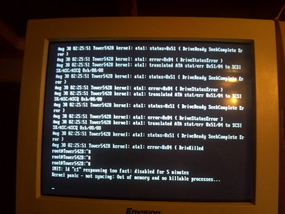

Hello,
I tried to upgrade a 1tb drive that is working fine to a 2tb drive for more space.  (server case is full)  There have been no problems with this server for several years.
Against my better judgment, in a hurry, I did not run a parity check before the upgrade.  (last one was 10 days ago)
I stopped and powered down the array.  Replaced the smaller drive with a larger one.  Powered on and started the array and it started to rebuild.  Last error on screen states:  Kernal Panic - not syncing: Out of memory and no killable processes...  Server is frozen at this point and I cannot save a syslog.  Last syslog on the flash drive is from several days ago.  I tried to power it on one more time and the same thing happened.
I would like to just put the old drive back in at this point (which is fine). But it is saying:  Stopped. Replacment disk is too small.
Is there any way that I can get the 1tb drive back in there and run a parity check?
Thank you.
attaching screenshot when the upgrade failed.  2nd pic is easier to read had to re-size.
Bump.
Enter "initconfig" and then rebuild parity.
Refer to the "Trust my parity" procedure in the wiki.
Thanks!  I ran memtest for 24+ hours with no errors.
With the original drive in place I did a initconfig and parity rebuilt fine overnight.
Just an update:  Parity check finished with the original drive in place.
I then swapped in the 2tb drive in the same spot and it upgraded fine.
