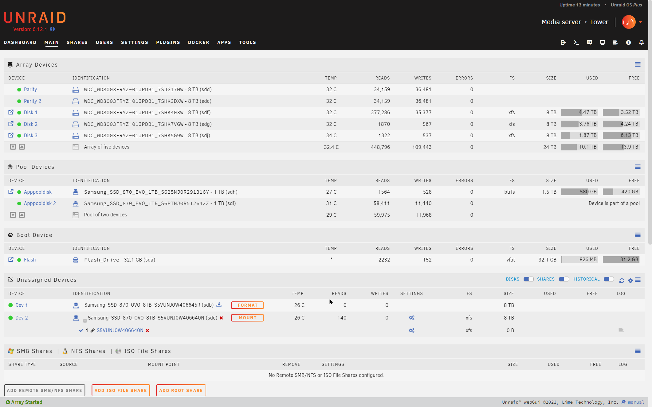

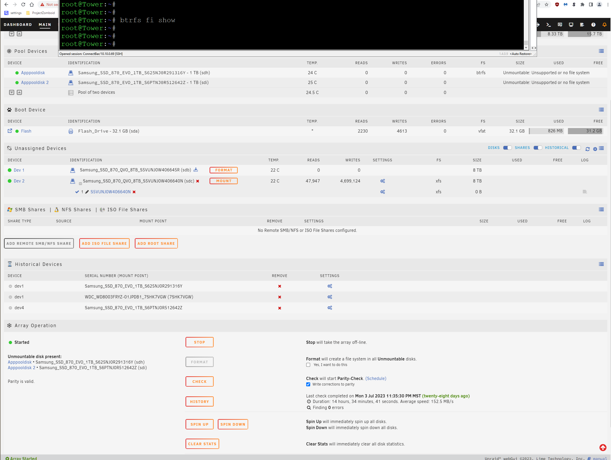

July 31, 20233 yr Hello, I believe i royally screwed up my migration from 1TB to 8TB cache drives. Apppooldisk Samsung_SSD_870_EVO_1TB_S625NJ0R291316Y - 1 TB (sdh) 26 C 0 0 0 btrfs Unmountable: Unsupported or no file system Apppooldisk 2 Samsung_SSD_870_EVO_1TB_S6PTNJ0R512642Z - 1 TB (sdi) 26 C 0 0 0 Unmountable: Unsupported or no file system Pool of two devices 26 C 0 0 0 Boot Device my steps were all done in the GUI going from this guide. stopped array in ui; replaced sdi with sdb, started array, saw btrfs operation looked okay to me but appeared to complete quickly. stopped the array replaced sdh with sdc started the array now giving errors about unmountable filesystem, panic and stop array, remove sdc with sdh start array see unmounatable errors stop array again replace sdb with sdi start array again see unmountable errors reboot server still unmountable errors and zero partitions. So basically, my array is started with the old 1TB drives and doesn't appear to mount the filsystem or contain any data. Not sure if the actions above wiped out the partitions and my data. Before i proceed to data recovery, I wanted to see if you think there's a way to resolve this? I was looking at the recovery page, however, it doesn't appear to relate to my situation since my partitions are completely gone. tower-diagnostics-20230730-1825.zip

August 1, 20233 yr Author Thanks for the prompt response! yes, sdi/sdh were original, sdb, sdc are new pool devices. My array is currently shutdown since i'm running ddrescue and testdisk, i do not see an output of the command, after i start the array i will run the command again. i've created backups of both disks using ddrescue and was looking at this thread and currently doing a deepsearch of the partitions, i see the primary partition already and hoping that it's possible to repair the partition this way. ddrescue running on sdh Scraping failed blocks... (forwards) ipos: 18390 MB, non-trimmed: 0 B, current rate: 0 B/s opos: 18390 MB, non-scraped: 0 B, average rate: 27851 kB/s non-tried: 0 B, bad-sector: 61167 kB, error rate: 3072 B/s rescued: 1000 GB, bad areas: 9724, run time: 9h 58m 30s pct rescued: 99.99%, read errors: 123690, remaining time: 7d 8h 59m time since last successful read: 10s testdisk deepsearch running on sdi TestDisk 7.1, Data Reco very Utility, July 2019 Christophe GRENIER <grenier@cgsecurity.org> https://www.cgsecurity.org Disk /dev/sdi - 1000 GB / 931 GiB - CHS 121601 255 63 Analyse cylinder 35285/121600: 29% Read error at 33360/1/7 (lba=535928469) Linux 0 32 33 121601 80 63 1953523120 Thanks for looking into this!

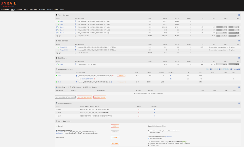

August 1, 20233 yr Author Here is a screenshot of my disks after the array has been started. TestDisk 7.1, Data Recovery Utility, July 2019 Christophe GRENIER <grenier@cgsecurity.org> https://www.cgsecurity.org Disk /dev/sdi - 1000 GB / 931 GiB - CHS 121601 255 63 Analyse cylinder 105745/121600: 86% Read error at 82729/130/32 (lba=1329049606) Linux 0 32 33 121601 80 63 1953523120 Linux 35941 137 37 37208 116 28 20353024 Linux 61096 208 41 62363 187 32 20353024 Invalid NTFS or exFAT boot 0 D HPFS - NTFS 176135 148 23 301524 101 50 2014371352 HPFS - NTFS 176135 148 23 301524 101 50 2014371352 Linux 102076 82 23 103343 61 14 20353024
