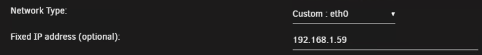

August 15, 20233 yr Hi all; I've a question that I hope someone can help me with. I want to map a static ip address that only responds to one docker. I added the ip to a different eth but all the dockers respond on it. Can anyone tell me how to accomplish this?
August 16, 20233 yr Community Expert Set he container to use a custom network, then specify the IP, e.g.:
