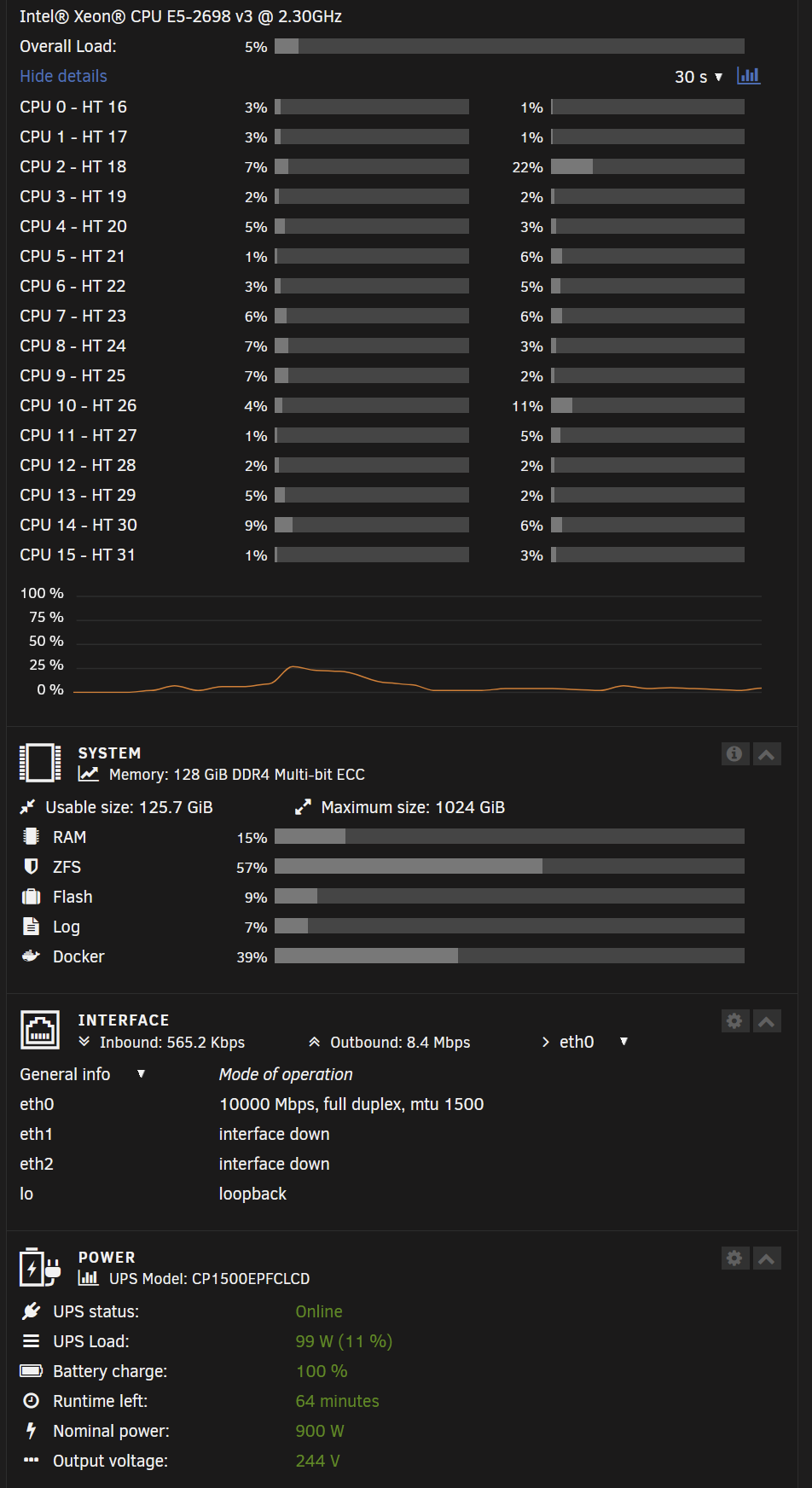

August 16, 20233 yr I’m thinking of going to upgrade my current build to lower the power consumption. At mean time I’m running unraid on my Lenovo Thinkstation P500 with 9 drive in total and 128gb of ddr4 ECC Ram. HBA card, And Xeon E5-2698-V3 processor and P2000 GPU, as now idle with 8drive spin down and nearly 0 CPU activity, GPU idle mode I had a power consumption around 100-130W. I’ve been searching around on the forum but can’t find the answer that I’m looking for as what’s the latest processor that unraid support so I won’t get the wrong processor as I notice previously someone mention that the 12-13gen Intel cpu are not recommended. Can someone recommend some hardware for me to go about. Thanks in advance. [emoji16] Sent from my iPhone using Tapatalk

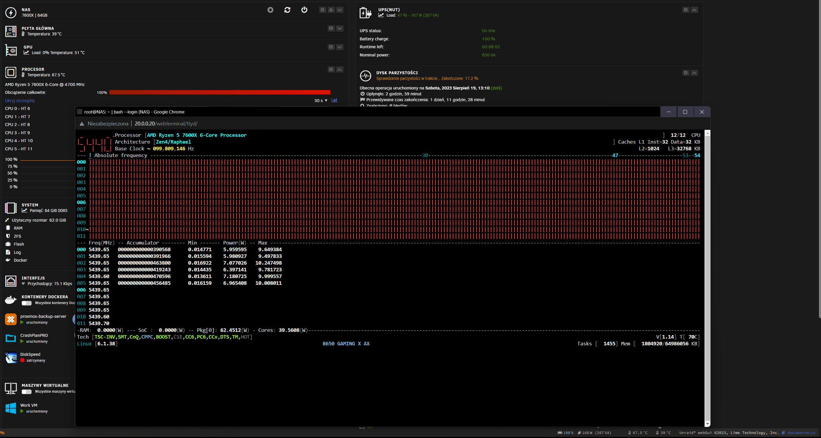

August 19, 20233 yr recently I've change my home server from i5-11600 (set to 65W limit), 32GB DDR4 to 7600X (set 88W limit), 64GB DDR5 (6 HDD drives, SAS controller, 2 NVMe drives on intel, after upgrade 3 NVMe on AMD) on server I'm running some VM, game servers, Emby (GPU transcoding) At standard load <20%, 2 drive spin-up 11600 took 140-160W from wall, 7600X same conditions 80-85W Right now unraid making parity check, all drives running - it takes ~125W from socket, when I put CPU on full load everything consume 168W
