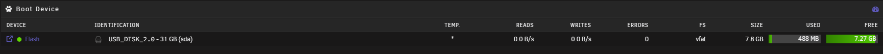

I'm having a small (but atm catastrophic) hiccup with my USB drive. Having run on Trial license for 3 days (on an 8TB flash drive), I've upgraded my license to Pro and moved the license to a 32GB flash. All was fine until this morning when my USB reports as being (a) read-only and (b) only 8GB in size. Everything else is running perfectly (dockers seem fine, array seems fine, etc).

Just to confirm .. 32GB USB showing as 8GB :(
That looks like a flash drive, may be best to just replace it.
Brand new, bought yesterday :( .. and the 3 others I bought yesterday all report as incompatible by the Unraid USB Flash Creator 😢
Still needs to be replaced, avoid generic flash drives, at least that one looks generic based on the device name.

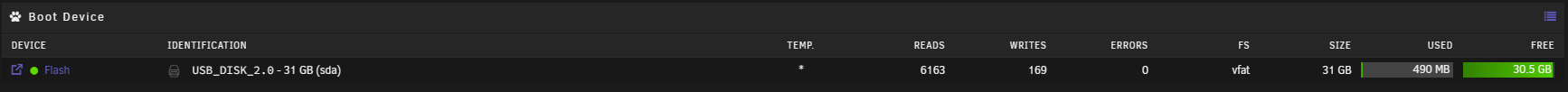

6. Unraid booted perfectly, USB disk showing up as 32GB
Not sure if the USB drive is suspect .. I may just swap it out when my new ones arrive (assuming Unraid USB Flash Creator will actually see any of the new USB's) but for now, Unraid is up and I can get busy migrating my 47TB Xigmanas server over to Unraid 😅
