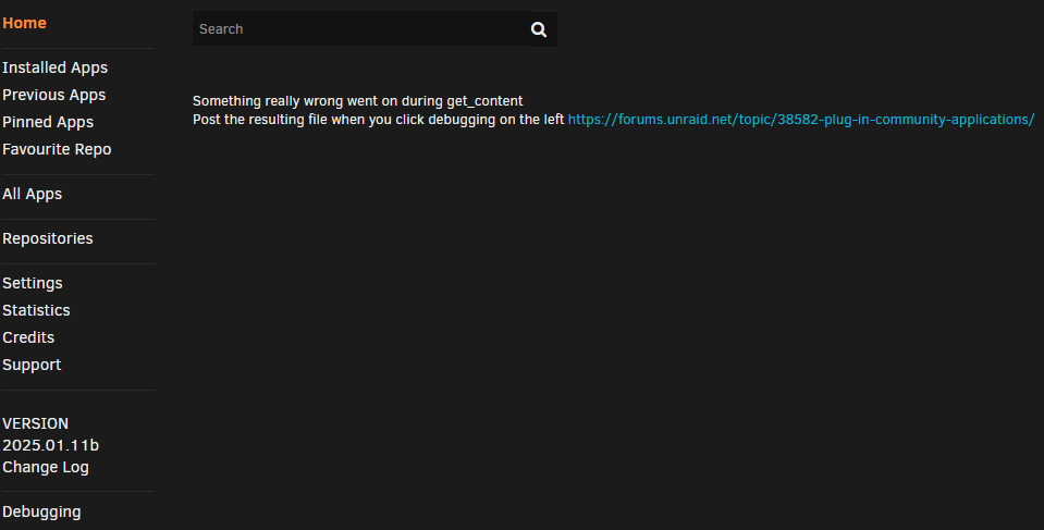

  3. Can confirm that 2025.01.11b still fails if NordVPN Threat Protection is enabled, as per below screenshot. Disabling NVPN TP makes the problem go away. I have raised a ticket with Nord, clearly their latest TP upgrade has done something new that makes things break. Interestingly, the latest Nord upgrade also "breaks" perfectly legitimate websites (like https://bodyblade.com). Thanks @Squid for all your efforts, love your work mate.

  5. Have removed the NordVPN extensions from both Firefox and Edge. Have turned off the NordVPN in Windows. Still getting the same "Something really wrong went on during get_content" error on both browsers despite having rebooted. CA-Logging-20250111-0303.zip
