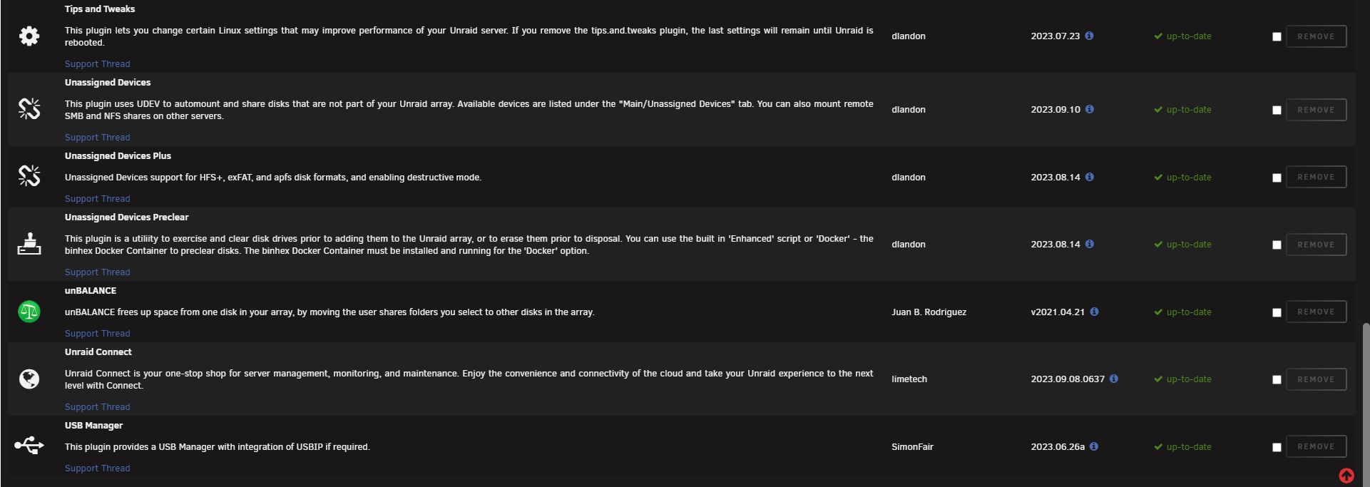

September 16, 20233 yr Author ok, I've removed all the plugins, and the problem seems to be fixed... I've reinstalled a few of the plugins I had before, and so far, so good... However, now for the life of me, I can't get the array to autostart... configuration is valid (although I'm not running a parity disk, as I have no need for it). I have "autostart" enabled in disk settings, but the array just won't start automatically... I've tried using the "new config" option, but still no joy... I'm at a loss... posting diagnostics... rg-server-diagnostics-20230916-1036.zip Edited September 16, 20233 yr by RGauld

September 19, 20233 yr Author Solution to reply to both issues, with your help I've solved the array autostart issue. It was an external eSATA Raid enclosure that was causing the problem. I've removed it from the array, and the autostart is working properly again, (although I'm at a loss to explain why, as it was working fine before). As to the slow WebUI, I've narrowed it down to the "Unraid Connect" plugin... After installing it, the slow WebUI issue returned... I uninstalled it, and the WebUI response time went back to normal... obviously there is an issue with the "Unraid Connect" plugin.

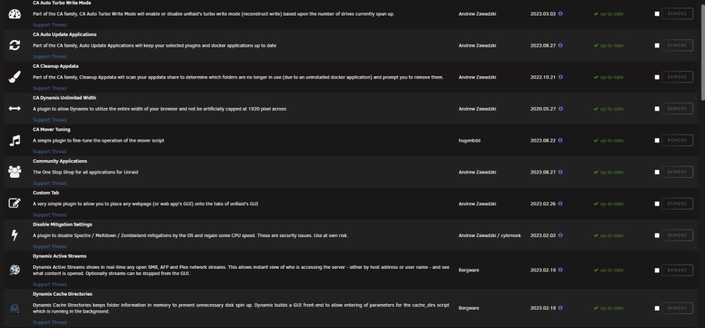

September 23, 20233 yr On 9/21/2023 at 7:55 AM, sebz29a said: Problem solved removing an old deprecated plugin : CA config editor Wouldn't have been the issue
