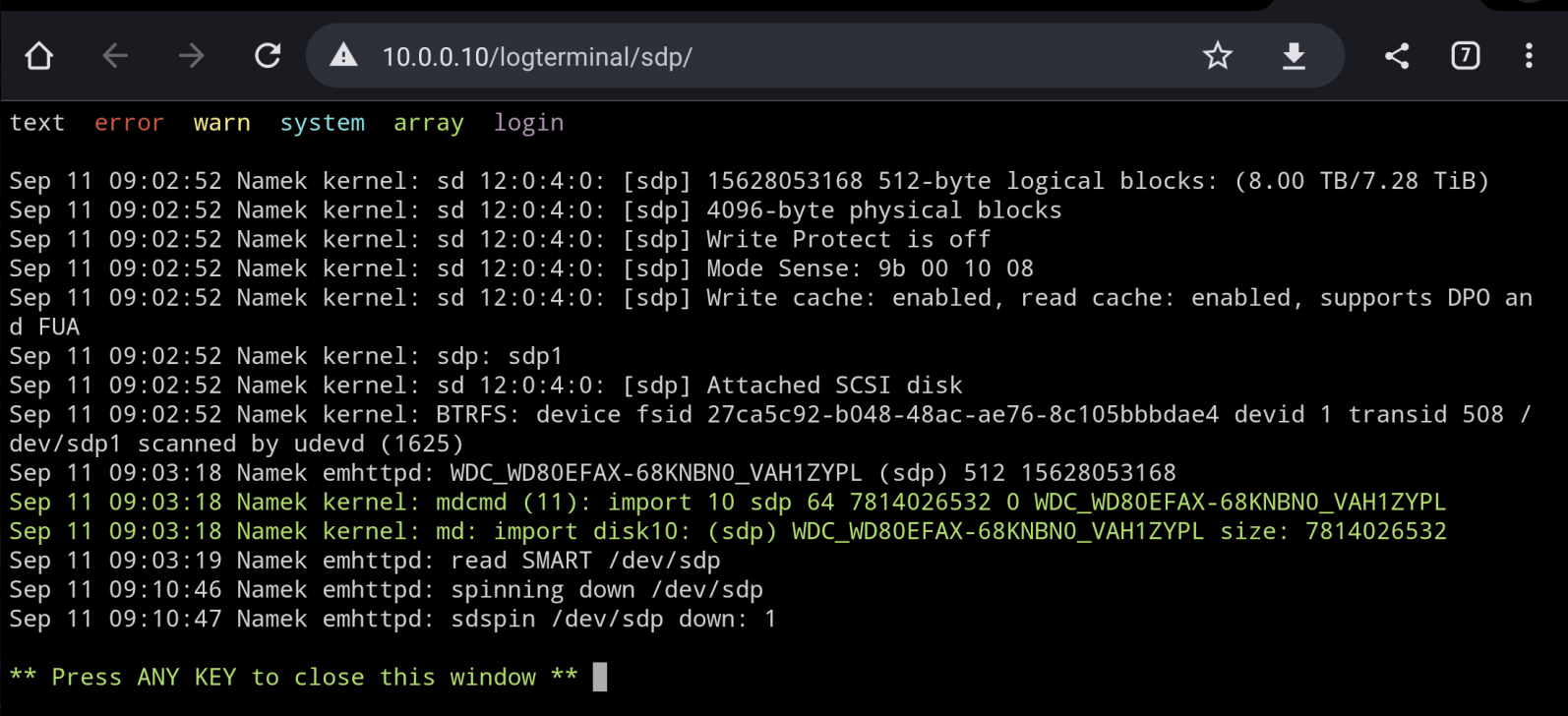

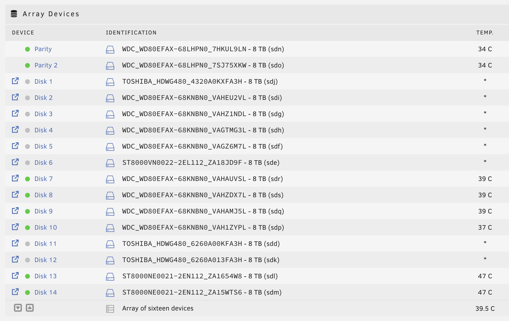

Hi all,
So I have spin down delay set to 1 hour, and all drives on default.
For whatever reason a subset of mixed drives will not spin down, they are all connected to the same SAS controller, and they are not on the same breakout cables either.
Diagnostics attached.
Screen shot too:
Also I am suffering from a random issue where I restart and some drives show as Wrong, even tho they are the exact same drives selected in the drop down so the array doesnt start.
Fortunately its only been 2 drives so I've been able to rebuild parity.
Once when I just set it up, it was EVERY drive.
Nothing changed hardware wise. I literally just rebooted.
Really hoping to get these 2 issues ironed out...

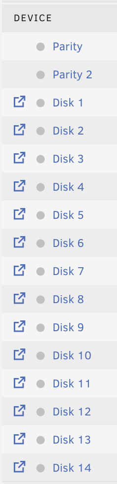

Ok so I dug into this more...
Ran safemode, didnt help either.
I then looked if there was a new Firmware for my 9300-16i and funnily there was, but also I noticed that I hadnt flashed BOTH sides of the controller.
Num   Ctlr            FW Ver        NVDATA        x86-BIOS         PCI Addr
0  SAS3008(C0)  16.00.10.00    0e.01.00.03    08.37.00.00     00:19:00:00
1  SAS3008(C0)  05.00.00.00    05.00.00.01    08.11.00.00     00:1b:00:00
So I flashed them both this time to the latest 16.00.12.00 & BIOS.
Restarted and testing seems good now.
Voila:
