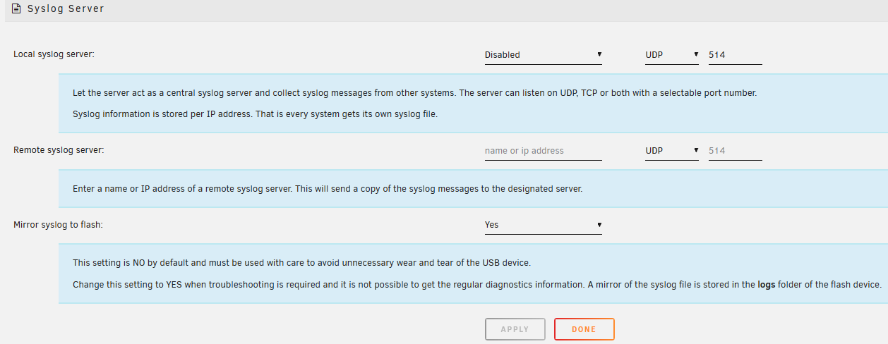

Syslog Server setup to log to the flash drive should be setup like this:
You will find the file in the   logs   folder/directory of the flash drive.
