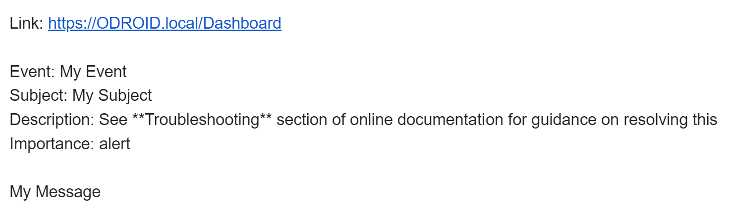

When I pass markdown to the notify script directly:
/usr/local/emhttp/webGui/scripts/notify -e "My Event" -s "My Subject" -d 'See **Troubleshooting** section of online documentation for guidance on resolving this'  -m "My Message" -i "alert" -l "/Dashboard"
It comes through the email as markdown, so I'm pretty confident the notification system is not converting it to HTML
I see where you are defining the string using markdown as `**Troubleshooting**`:
https://github.com/itimpi/parity.check.tuning/blob/800138c7ac56b25bba0d6fdc7b9ca4e1e1c75606/source/usr/local/emhttp/plugins/parity.check.tuning/parity.check.tuning.php#L634
But I think something (maybe the translation system?) is converting the markdown to HTML before it is passed to to the notify script

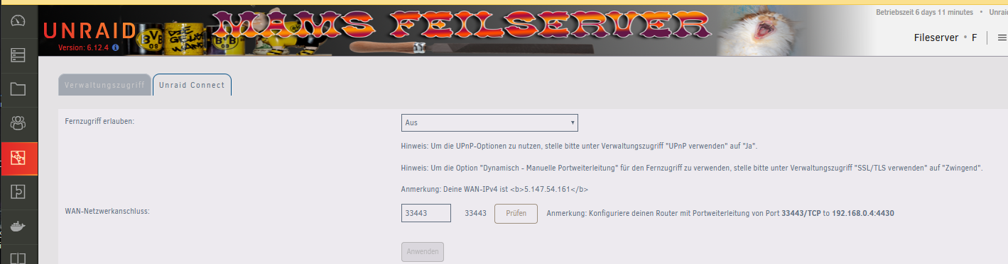

Ahhh, folks, there is another glitch like above, but not in the mail. instead the gui is wrong too:
"WAN-IP ist <b>..."
I bet this is the same problem like above. But the GUI is html, so the "<b>" needs to be escaped somewhere.
