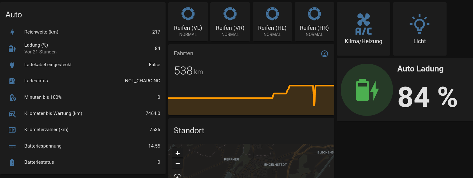

[SUPPORT] wubbl0rz - FiatChamp
Connect your FIAT, Jeep, Ram, Dodge, AlfaRomeo car ๐Ÿš— or truck ๐Ÿšš to Home Assistant. Needs a vehicle with enabled uconnect services and valid account.
ย
190108698-6df2a4de-776d-45e2-8f27-1c5521f79476.thumb.png.a2b25808eb27a40d1541aa91b320af07.png
