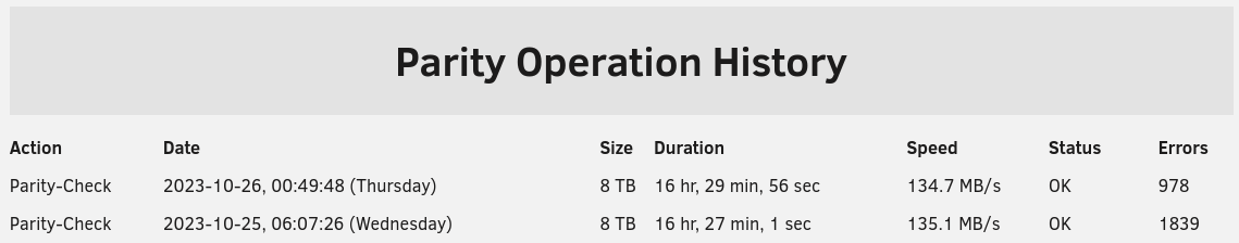

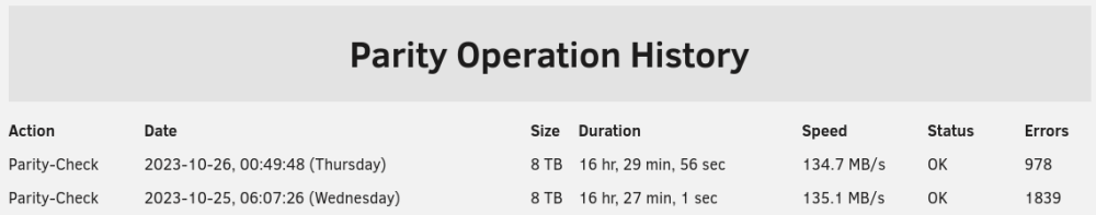

So i exchanged all the Sata Cables at first. Run a first correcting Parity check that 1839 errors, did a second check (non correcting) some hours later that found 978 Errors:
So i dont think it was the cabling.
Next would be the controller i thing with the same procedure.

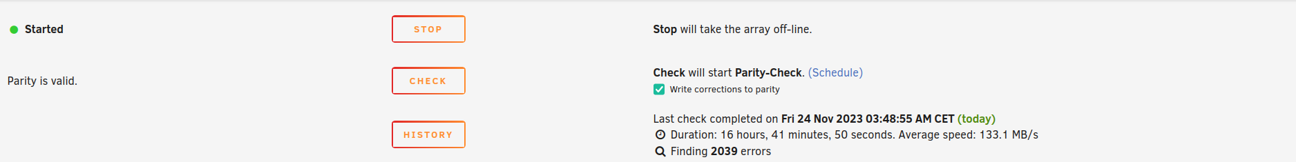

Than i did a Parity Sync, which completed but with 2039 Read Errors on Disk 3.
If i replace the disk now with a new one and let it rebuild shouldnt there be faulty data on it in that case?
I mean it show the Parity as valid, which i quite dont understand if there are read errors while building the Parity.
Or does it mean that there read errors which could be resolved, by multiple readings etc?
Post new diags.
It's not logged as a disk issues and the disk looks healthy, check/replace cables and try again.
