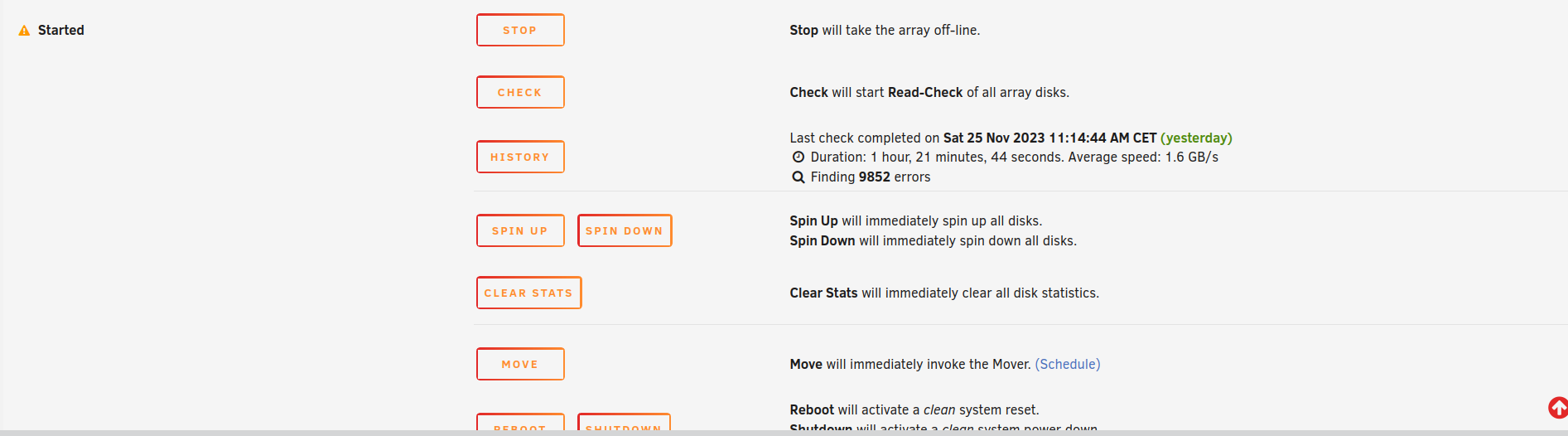

Sync Errors what the cause?
Anyone an Idea?

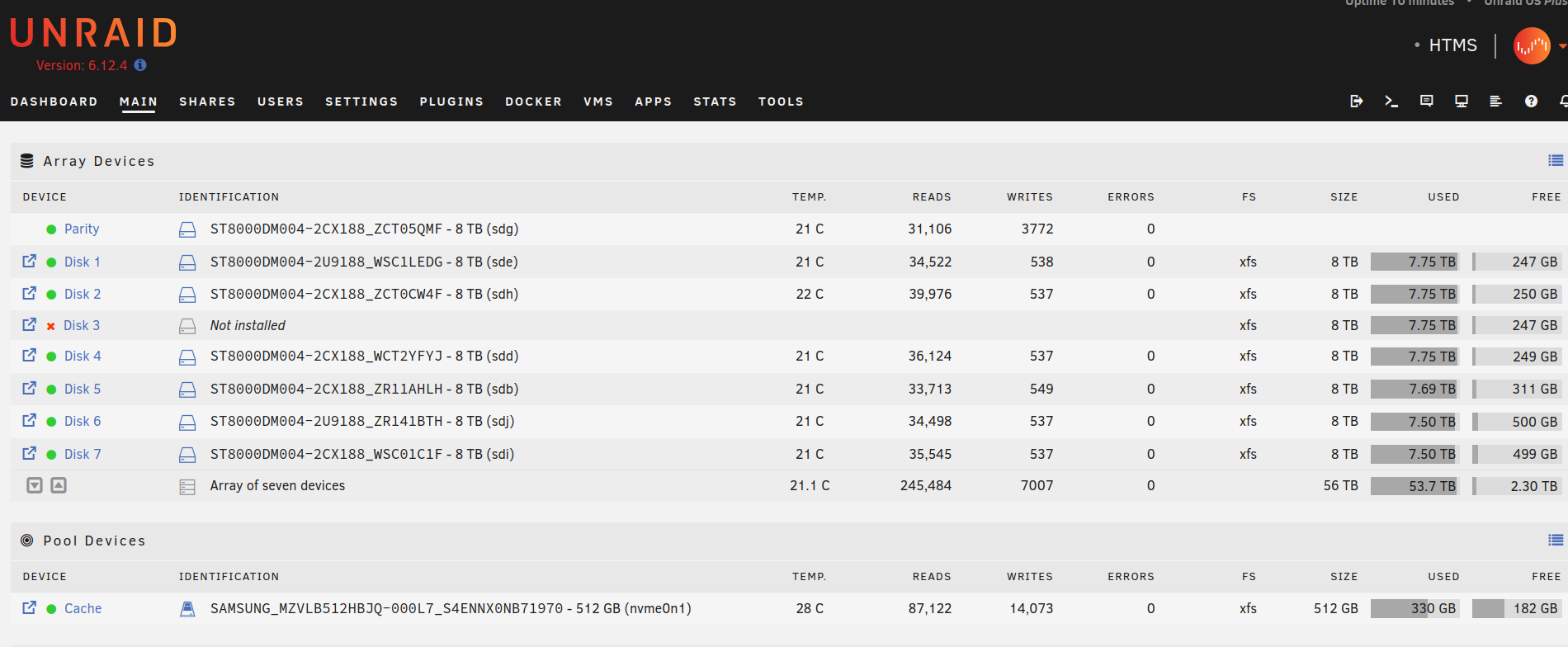

Tried to copy down the File normal with mc what failed.
But althought the missing drive is not shown as emulated i can play the files which are on the missing drive, which confuses me a little bit.
So is there any way i could use the not 100% Parity to correct the nearly dead drive?
According to your screenshot it IS being emulated as the emulated disk has mounted and appears to have plenty of data on it.  What makes you think it is not emulated?
Hmm didnt unRaid flagged such disks as emulated in past releases.
I know that it is emulated else i couldnt access file which are on the damaged disk.
Nevermind i started a rebuild of that disk to another 8TB i have laying around here, although i know there will be some corrupted files on it because the parity i not clean.
After that i will take a look on the disabled disk with ddrescue to see which files are affected.
Its only media files so no big deal.
Hopefully the sync errors are gone after this, because that disk was the cause.
Have you tried hovering your mouse over the icon for the drive?
To be honest: no i have not tried that.
Okay it was not the Memory, Cable , PSU etc. it was Disk 3 which was damaged.
Ran a non correcting Parity check against the rebuilded drive which ended with zero errors.
Any hints how i can check the old HDD for the files which seem to be on the damaged sectors?
