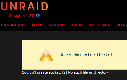

Hello all, I am having an issue and I can't figure it out. For some reason (this isn't the first time) my instance just decides it is done... I woke up this morning to an error and I am just able to get to it (emailed to me) that my docker file is unwritable and I couldn't access any of my docker instances. Come back and most of them are offline and I don't know why (I have auto update turned off for all dockers right now). The ones that showed online, I couldn't reach the web UI for any. Usually to fix this, I have to do a full reboot and most the time Unraid hangs and I have to do an unclean power down. I tried stopping docker and then restarting it and I get an error "Docker Service failed to start (Couldn't create socket: [2] No such file or directory." I uploaded the logs for before I do my reboot in hopes that someone could have some answers as to what is happening. I am sure it is something I am doing wrong or a setting that I might have over looked messing everything up but hope that someone more experienced can help me pin point what it is.

It looks like your cache pool is probably corrupt, and the docker.img file on that pool is definitely corrupt.
a common cause of btrfs corruption is RAM issues so you should finitely run memtest to check it out (if you boot in UEFI mode use the version from memtest86.com).
I thought that my docker image was corrupted last time and I deleted it and started new but it kept happening. If I reboot the server everything comes back perfectly even with an unclean shut down. It could be a ram issue but then I would expect that Proxmox would also have issues and it doesn't. I am virtualizing unraid on proxmox and have been for ever a year with no issues, the issues just started after about a month or two ago.
If the memory isn't being used by Proxmox but does wind up being used by Unraid, then only Unraid will be affected.
