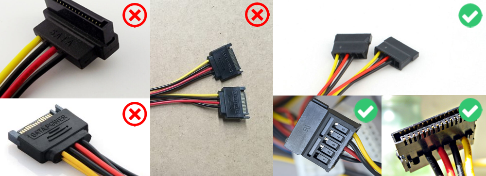

Yeah, that is NOT going to work well for spinner drives. It's questionable for SSD's, and not nearly enough power for HDD's.

Here is an image of what to look for, generally.
Notice the clear separations with distinct compartments for each cable. Avoid molded ends, the manufacturing process is so sloppy there have been many reports of fires caused by direct shorts inside the molded end, typically after the cable has been in use and experienced some normal heating cycles.
The molex 4 pin end is not normally subject to this type of failure, as the wires have much greater separation.
