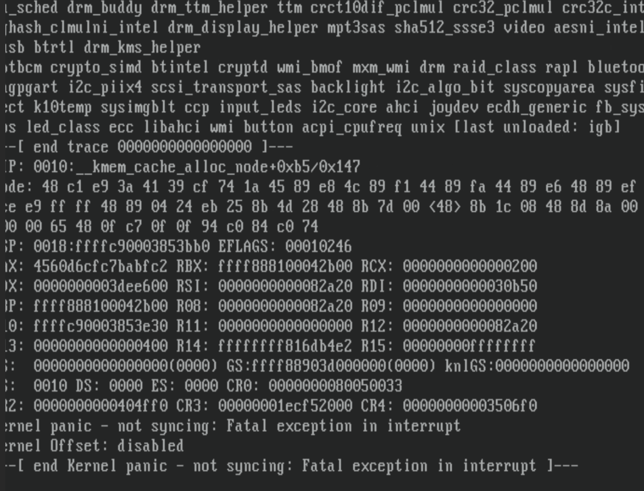

EDIT: I have also posted a screenshot of what is printed on to the screen at the time of the crash.
Edited by bonzi
It crashed again, this time I think we might have something more useful. Could it be that the USB ports are causing this and are failing or not drawing power properly for devices that need a lot of power? Especially I am thinking the USB port that the Coral TPU is plugged into? Thoughts? That is what it looks like to me from the log.
I attached all of the log from the crash and reboot. @JorgeB if you could have a look at the first few lines and let me know if you think this is what is going on. Thanks!
syslog-crash-2.rtf
A lot of call traces, they look more hardware related, try with just RAM stick, if the same try a different one, that will basically rule out RAM.
