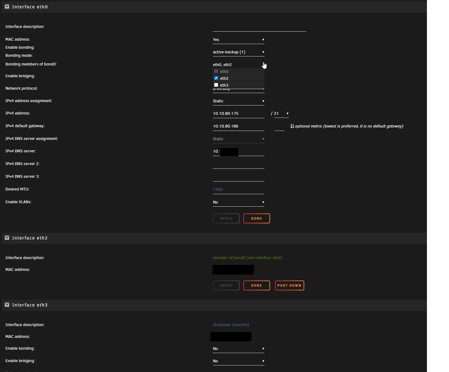

I'm still baffled why my /boot/config/network-rules.cfg file keeps disappearing and why my eth0 and eth1 devices keep getting renamed to eth2 and eth3 breaking everything. I have no idea how/why this started occurring or really how to fix it. Just praying that the upgrade resolves the issue.
Ok @JorgeB -- I have completed the upgrade and I still have the same issue.
There is no /boot/config/network-rules.cfg after reboot. If I add it (the one I found on the vanilla usb drive) it gets removed when the server reboots.
I'm posting the UI screenshot of my network config and another diagnostics bundle. Notice that the eth0 is grayed out and that eth2 and eth3 are seen as what my old eth0 and eth1 used to be. I have tried deleting the network.cfg file and rebooting as well as going through the ui and resetting network config.
