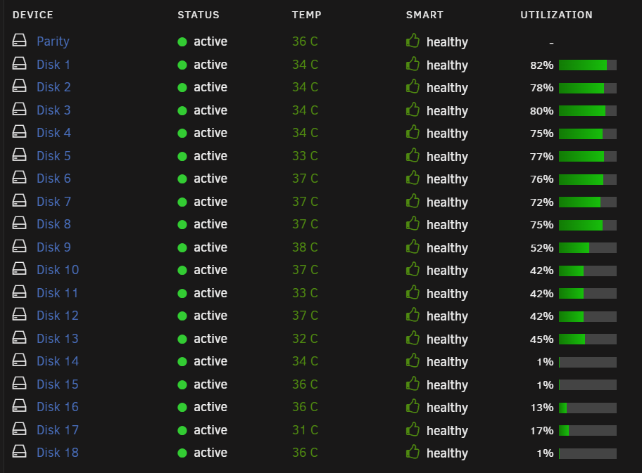

The array consists of 18 drives and my main concern is regarding Disk 1. When I started this array, Disk 1 was pegged at 88% before Unraid cascaded the files down to the next drive and so on. However, as time goes by, the utilization on Disk 1 continues to drop, and currently it is at 82%. I don't really pay attention to the rest of the Disks' utilization, but I won't be surprised if they go up since I constantly add files to the array as well.

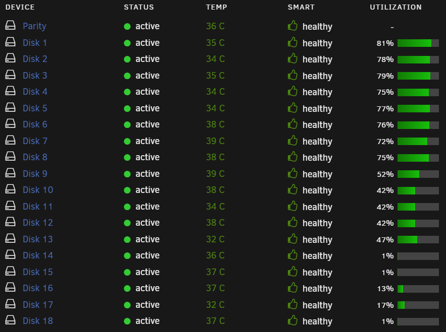

Hello again. Bumping this back up. So I noticed that today a few changes happened to the array.
Now with a point of reference from my previous screenshot, I can see that Disk 1 utilization dropped by 1% down to 81%, and Disk 3 also dropped by 1% down to 79%. Disk 13 went up by 2% to 47%. Now I'm not sure if some files were moved to Disk 13 from the other two disks. I also failed to mention previously that I set up the Warning disk utilization threshold percentage on all my drives at 88.

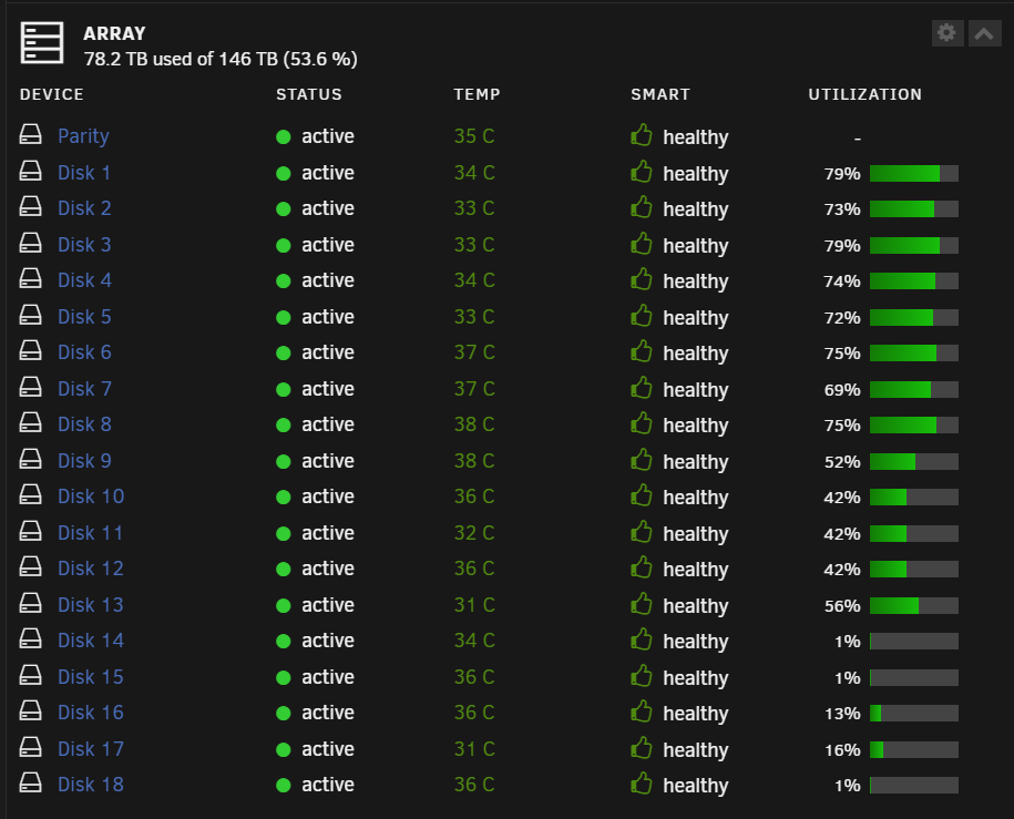

Hmmm...then that's really strange. Unless these utilization percentages are incorrect, it's still continuing, now with Disk 13 reaching 56% utilization while mutliple other drives are dropping in usage. What's interesting is that it's specifically filling up Disk 13 first over Disk 9-12.
Disk13 is larger than those so it was next chosen by High Water Allocation. Disk13 will continue to be selected (for any shares that are configured to use it) until it is half full.

Hi Trurl, thank you for that explanation, and that totally makes sense. So does the same "High Water Allocation" explanation apply to the other drives that are shrinking in utilization? From the latest screenshot, Disk 1, 2, 4, 5, 6 and 17 shrunk in utilization. These drives are 14TB, 10TB, 10TB, 10TB, and 8TB respectively. I wonder if it reorganizes files until the larger drives all reach 79%?
2 hours ago, itimpi said:
Unraid never moves files between array drives by itself.
Someone or something must be moving or deleting files. 'arr dockers, for example, are often configured so downloaded files will get moved to other shares
Even more interesting. I do have arr dockers, but nothing that I know off are set to move files around. But then again, this is very much possible and I may have enabled a setting that does this.  They might also be deleting and updating files in my drives and placing those newer files in a different drive in the array. This actually makes the most sense.
I guess as long as no files are physically deleted and lost, I think I won't worry too much about the usage percentage moving around. Thanks more the help trurl!
