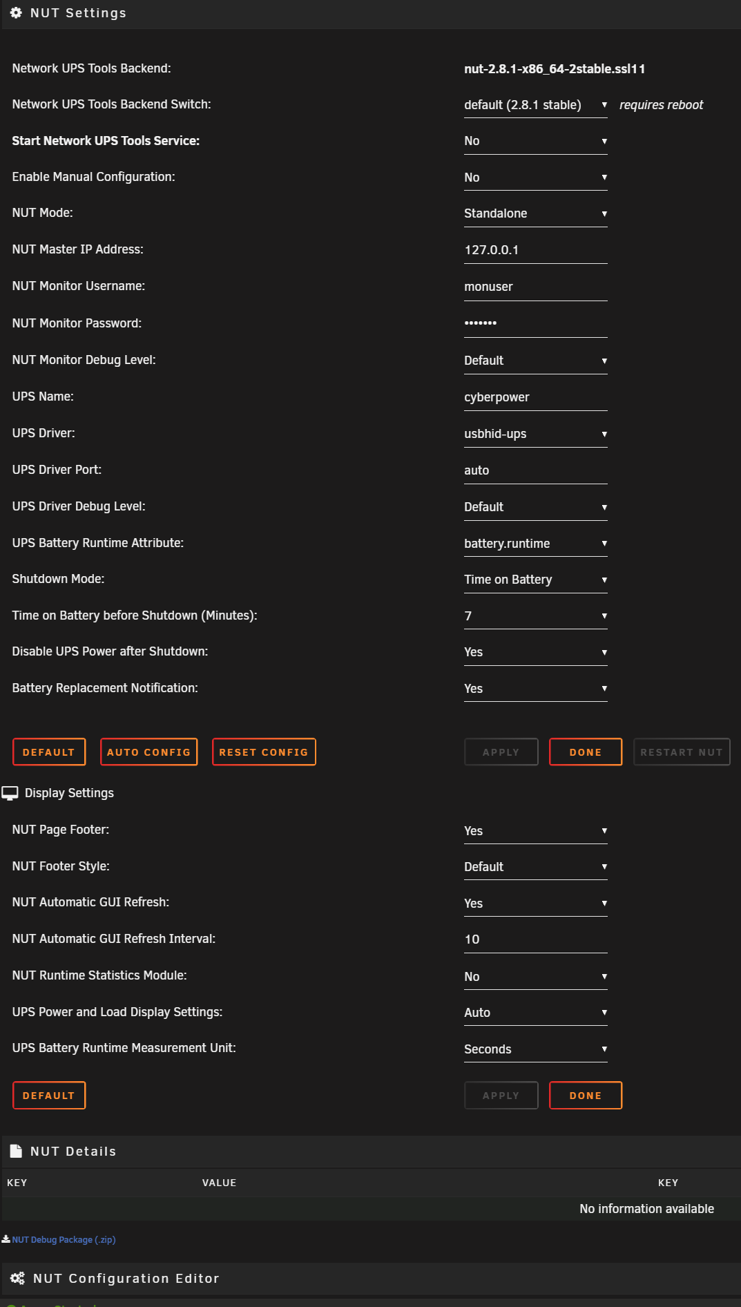

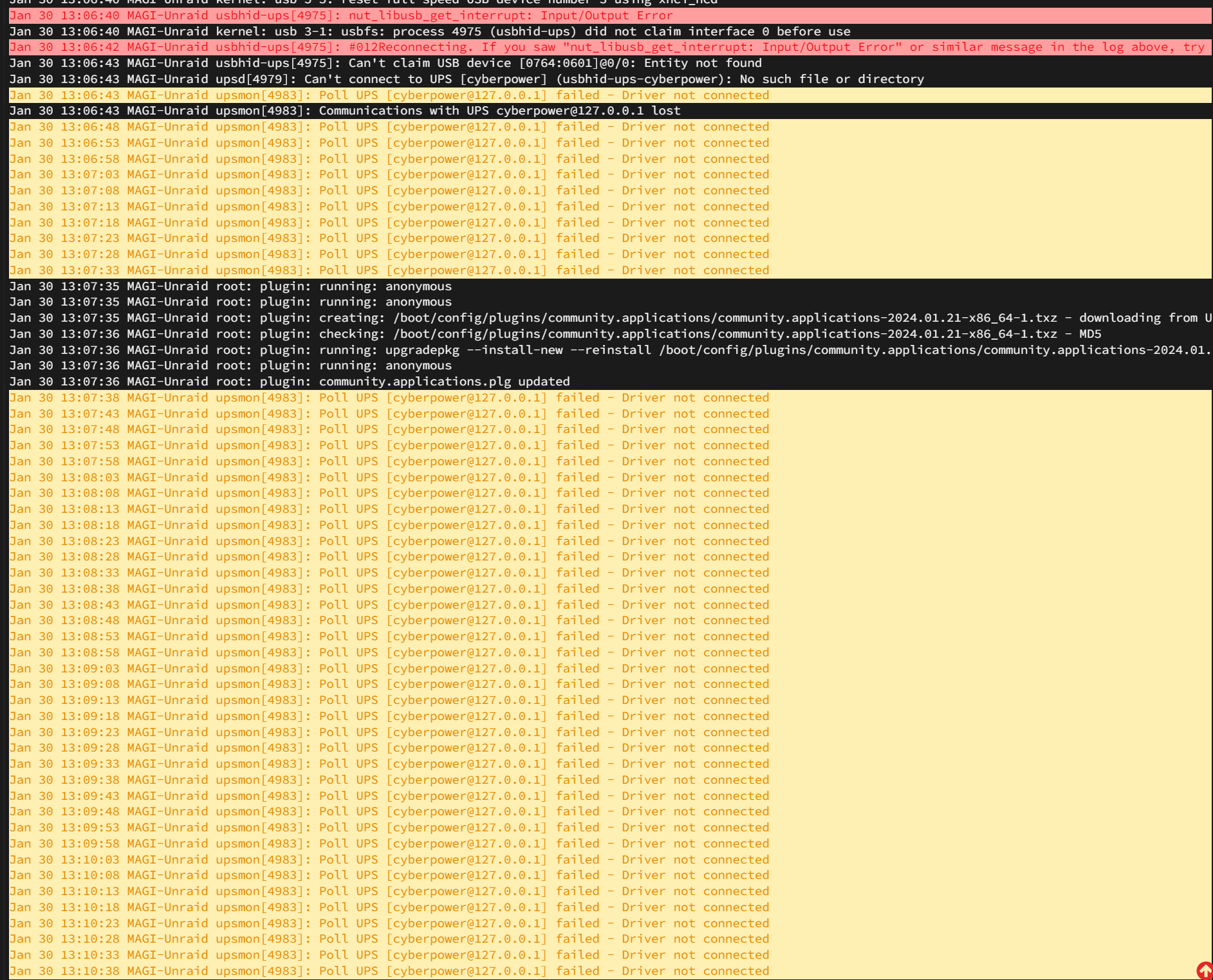

  12. Hi Rysz, I figured out what I did wrong, but it seem to not have fixed the issue. I seemed to have accidentally linked the USB connection for the UPS to one of my VMs, which would explain why NUT can no longer see the UPS. However, even after disassociating the UPS from the VM and rebooted my server, NUT's status still shows as Stopped. I'm not sure what else is preventing it from working properly. Is there a way to restart the NUT service without having to reboot unraid altogether?
  13. Hello Rysz (and everyone else here), I seem to be running into a strange issue with NUT. I'm not sure when this started occuring with NUT on my Unraid server, but for some reason, it would not want to run, at least I think it's not running. I enabled the footer and it disappeared. When I go to the NUT settings, and restart NUT, I get an error and it asked me to check syslog. I also decided to restart unraid to see if that fixed it, and while it did for a the first few minutes where the footer shows up and shows the correct UPS reading, it all of a sudden disappeared and the same issue happened again. I'm not even sure what to look for or try to do to fix this. I want to avoid rebooting unraid since it takes the server about 4-5 minutes to go through the whole cycle, so if there's any way for me to restart NUT without rebooting, that'll be great. I mean, of course I don't mind rebooting if it's really necessary, I just meant that I don't want to keep rebooting my server. I'm including some screenshots below, along with diagnostic file and nut debug file. Hopefully they can help. Thank you. magi-unraid-diagnostics-20240130-1617.zip nut-debug-20240130132107.zip

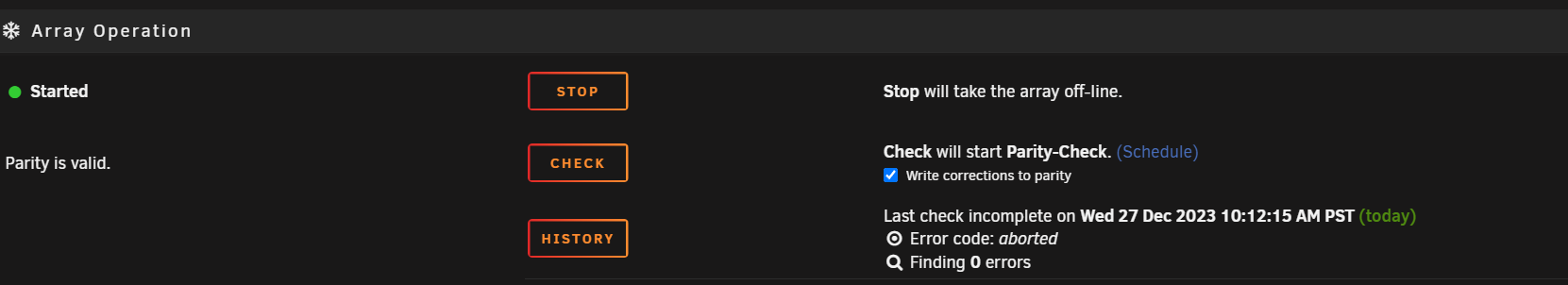

  15. Thank you again Jorge. I just updated to v6.12.6 and rebooted. It seems it rebooted just fine but I can't really tell. The only thing I noticed is that Parity Check is no longer running and that the last check is incomplete and Error Code says aborted. Should I run Parity Check again? I'm generated a new diagnostic in case you'd like to see it. If everything seems good, I'll proceed to mark this as resolved. magi-unraid-diagnostics-20231227-1324.zip
