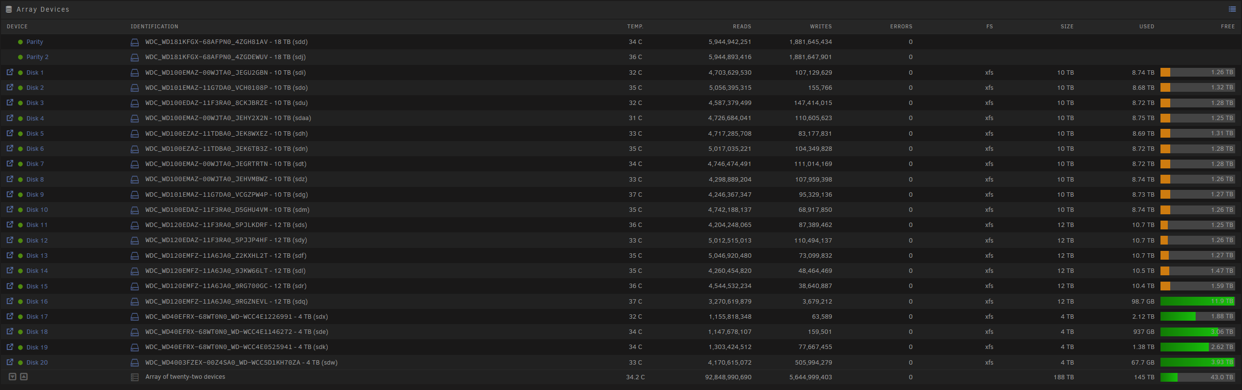

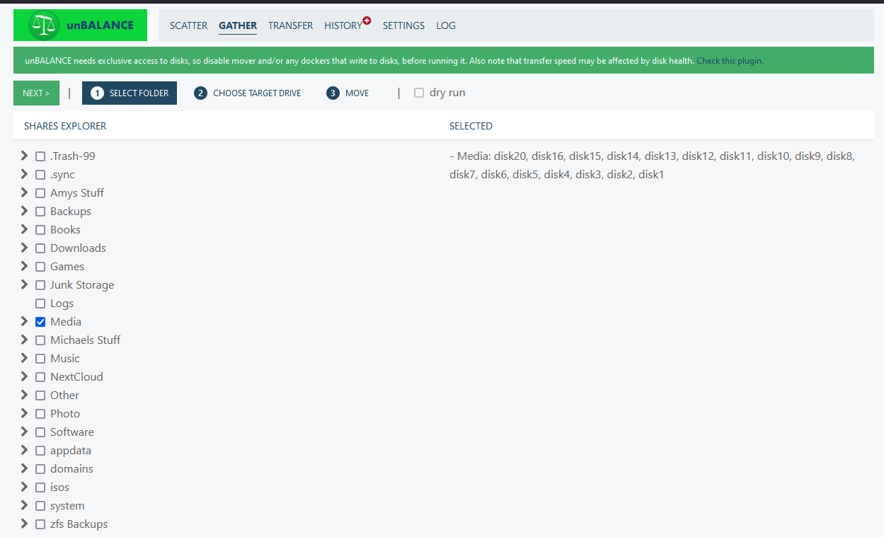

Based on the photos below, i would expect that my Media on disk20 would be moved by the mover to disk 1-16. But when i run mover, it instant start-stops.

That's not the mover, that's the unbalance plugin, please use the existing plugin support thread:
Thats not what i'm saying is the issue. Im saying that the files that should move from disk20 -> disk1-15 are not moving with the mover, but can be manually moved with unbalance as expected.

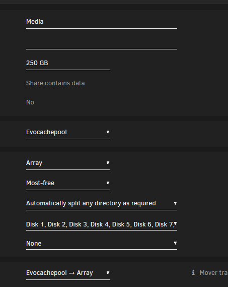

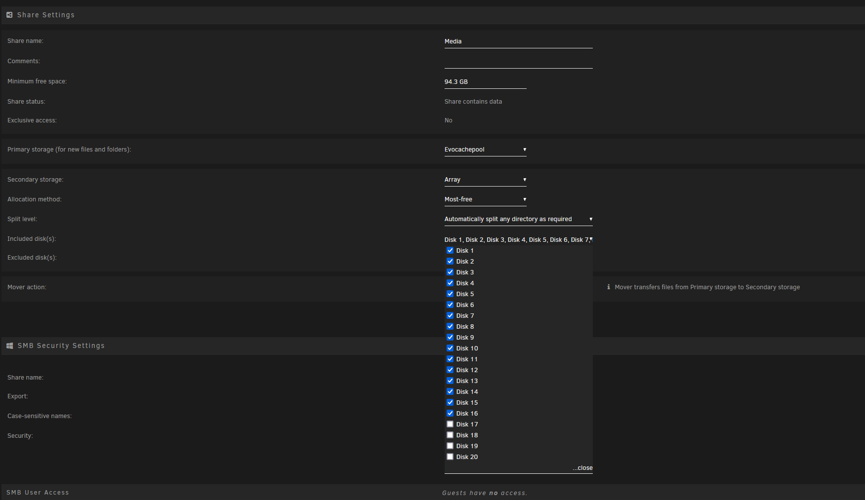

This has never been my past experience. To go further into it, im using syncthing to copy media across to my downloads folder:
Files are copied to the Downloads folder which is generally on evocachepool, but when it fills up or gets a mover run it moved these files to disk20.
Those files are then imported with sonarr/radarr and are now under the /media folder:
where the files are either on the evocachepool or disk 20(downloads) need to be converted to evocachepool or disk1-15 (media).
This process should move any files on either the evocachepool/disk20 which were in the DOWNLOADS folder to evocachepool/disk1-15 that are now in the MEDIA folder.
