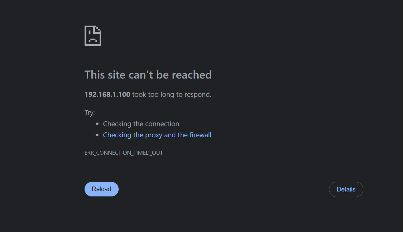

NO GUI and network disconnected
Sometimes my unraid server bug and i don't have gui, the server is disconnected to my router i don't know why, if someone have am idea please.

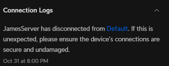

Log in my router : image.png.a1d9accf942af409973aefe8c420f7ea.png

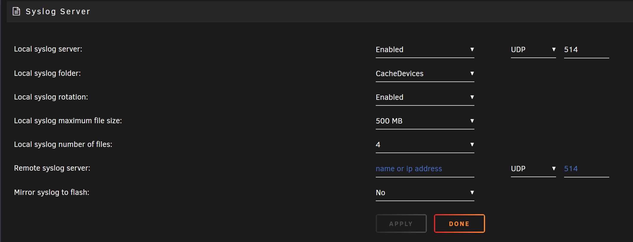

Were is save the log file ?
i check in my cacheDevices and i see nothing

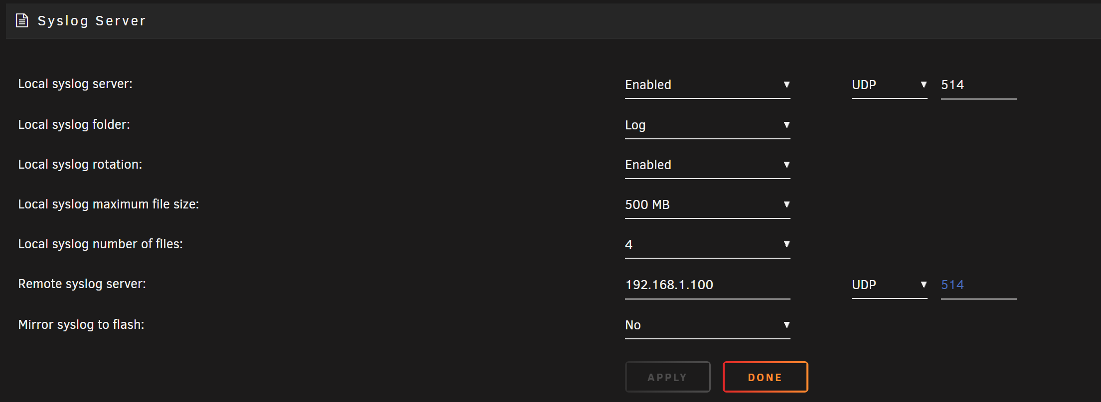

You only have the syslog server set up to listen at the moment.    You need to set one of the last 2 fields to get it to actually start recording messages from the host server.   This is mentioned in the link.
ok, i change for this and it's work
