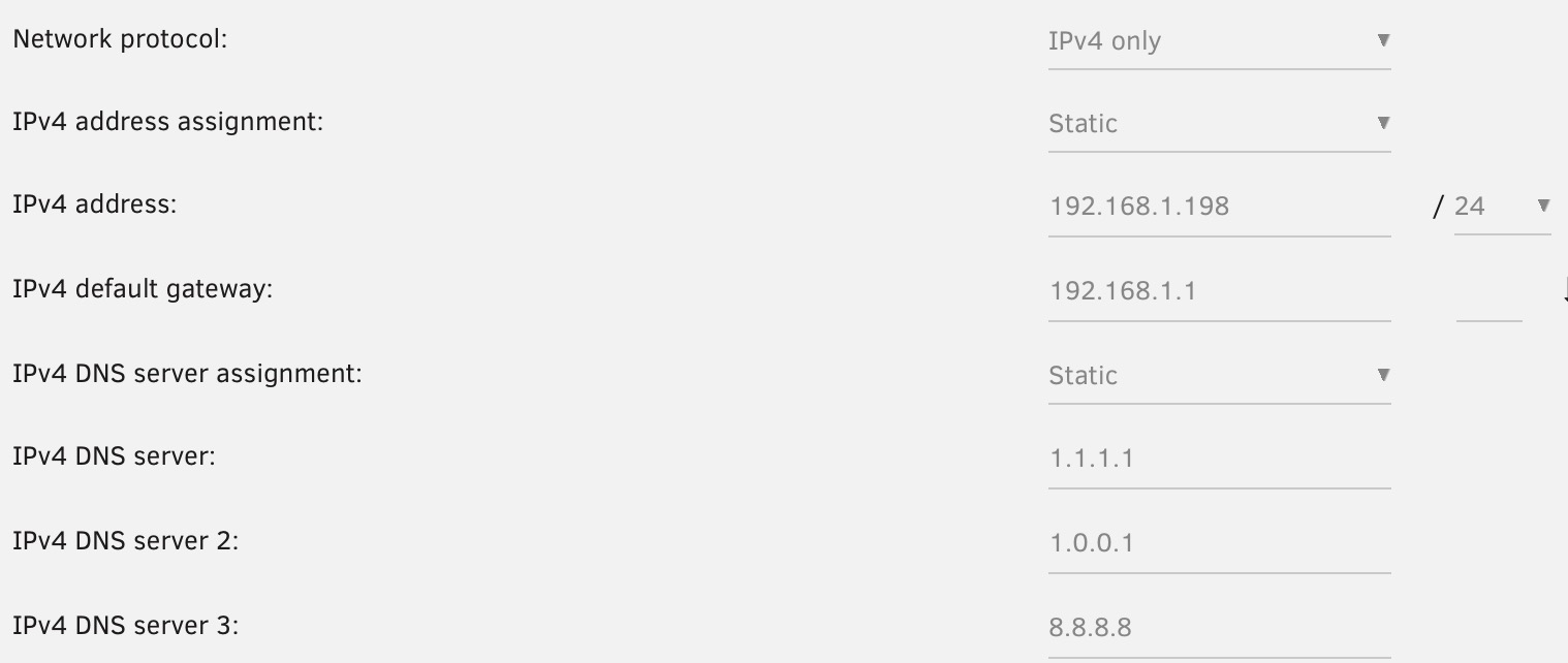

Start by setting up a DNS server for your Unraid server.  This is normally your router.  You don't have a DNS server defined.
Thanks for chiming in. I might be missing a setting, but I have this configured in network:

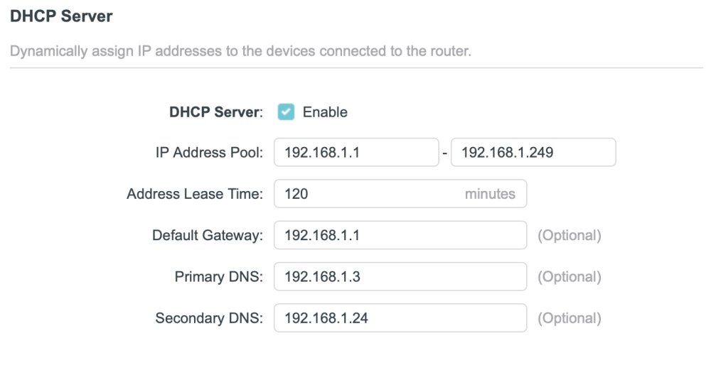

I'll do a basic rundown of my network too:
192.168.1.1 is my router
192.168.1.3 is an adguard home docker running as DNS
192.168.1.24 is a pi hole docker running as secondary DNS
192.168.1.13 is an unbound docker running as upstream DNS for both adguard and the pi hole.
Here is the config in the router:

An update - I changed several things:
-I updated my DHCP server to only share out IPs in the .200-250 range thinking that perhaps there was an IP address conflict despite having IPs reserved for most clients including unraid.
