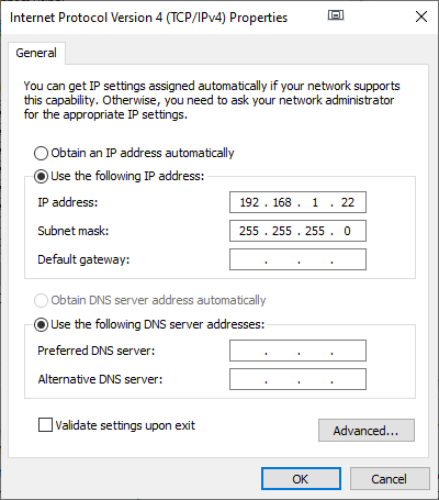

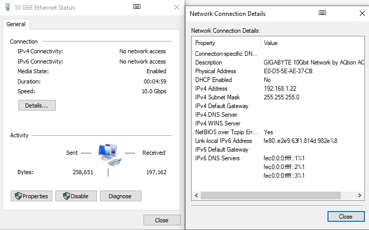

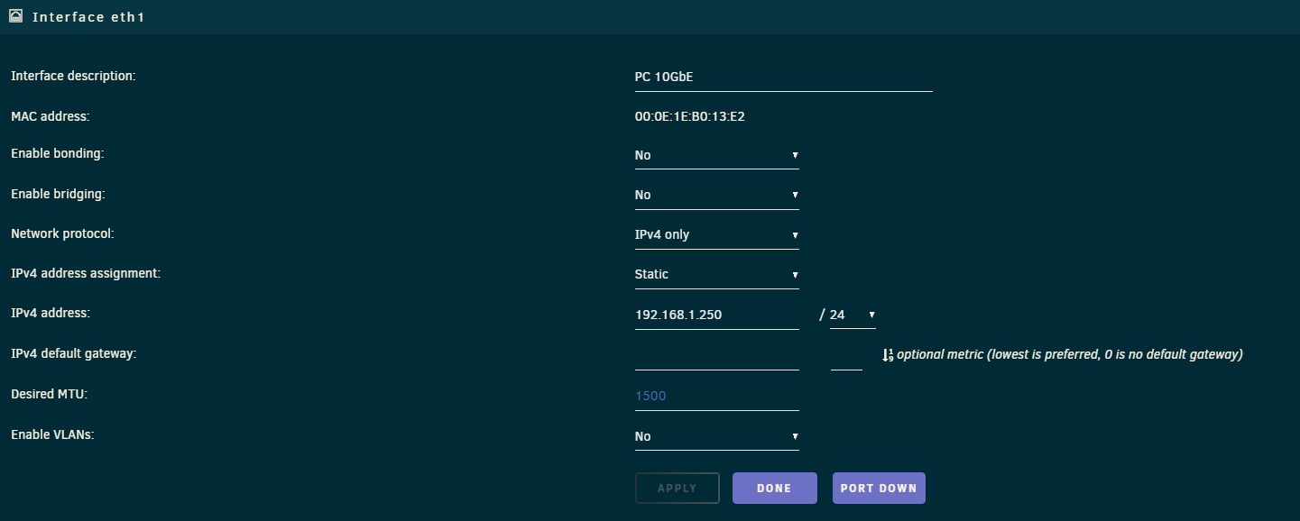

I have a direct connection from my Windows PC to eth1 on my unraid box.
The Windows ethernet is set up as 192.168.0.22 and the unraid machine is set up as 192.168.1.250. They were pinging fine but now suddenly I can't ping either to or from the unraid box any more.
The weird thing is that Windows sees the connect and says it's enabled and up. And Unraid sees the connection too, they just can't speak to each other suddenly.
Here's my Windows and Unraid settings:

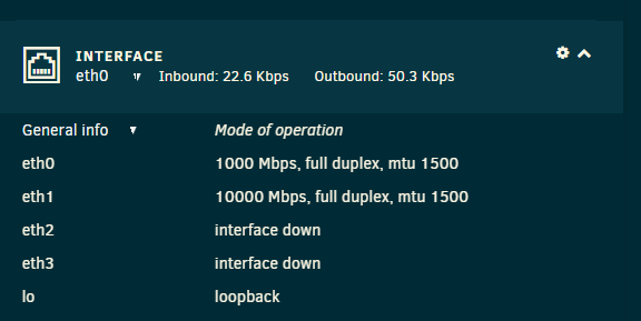

The end of the syslog in the diagnostics shows the eth1 link continually showing as down and then shortly afterwards showing as up again.    I would be tempted to try rebooting your router in case the issue is at that level

But even when it's up I can't ping. That's the main issue for now.
This is when the link is up:

Last time it dropped it linked at gigabit speed only, suggesting some cable/NIC issue.

The fact that is not linking at the correct speed suggests an issue, if possible try with different cable/NICs.

Very strangely, what seems to have fixed it is moving over from 192.168.1.x to 192.168.2.x.
No idea what the issue was there....
