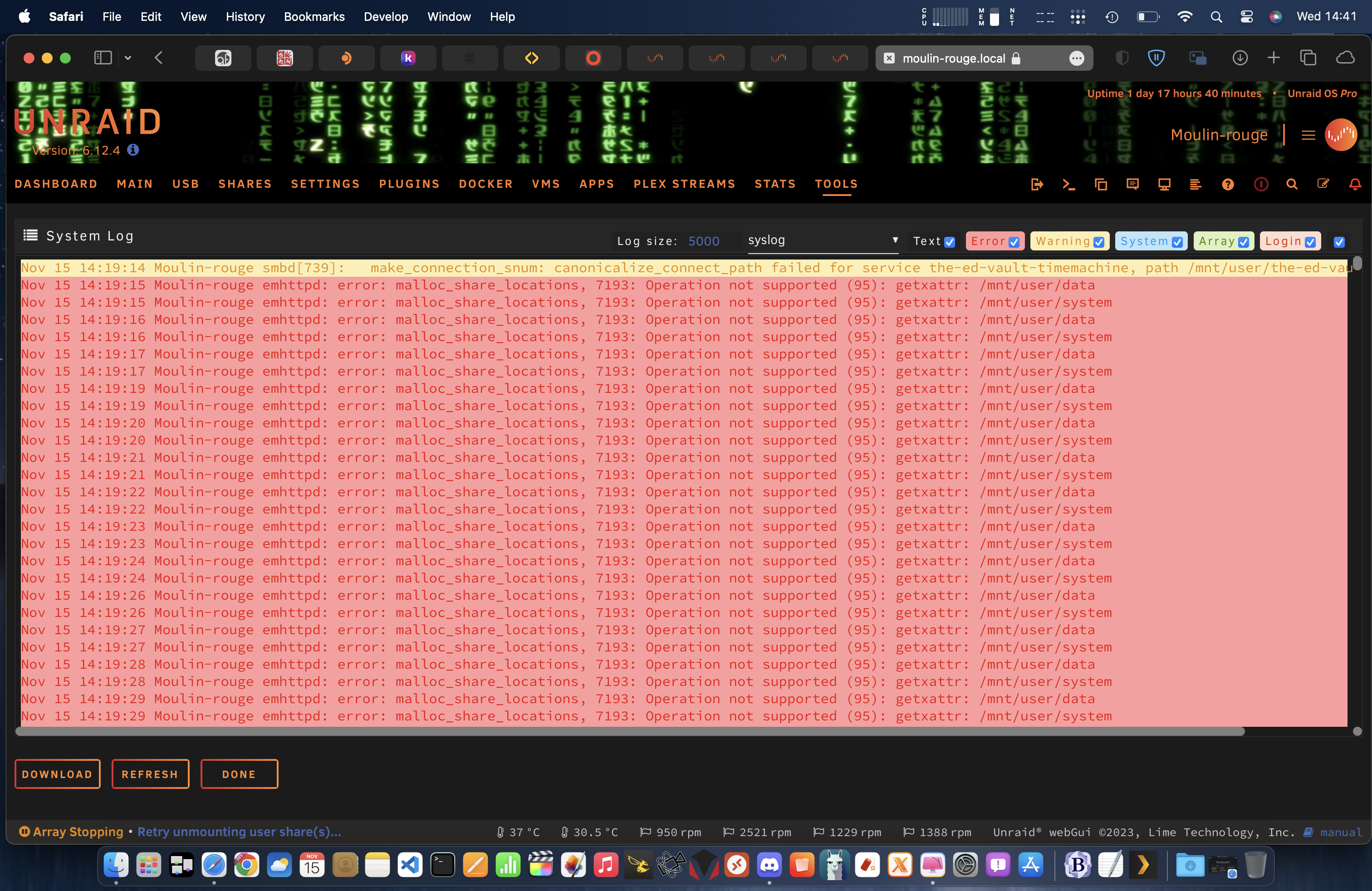

emhttpd: error: malloc_share_locations, 7193: Operation not supported (95): getxattr: /mnt/user/data
Getting this error every few weeks.
It makes me sh*t my pants because all my shares disappear but all fixed with a reboot.
Any advice on how to fix?
The syslog seems to also get messed up as its lost the previous days / weeks logs.
Nov 14 06:50:47 Moulin-rouge emhttpd: error: malloc_share_locations, 7193: Operation not supported (95): getxattr: /mnt/user/data
Nov 14 06:50:48 Moulin-rouge emhttpd: error: malloc_share_locations, 7193: Operation not supported (95): getxattr: /mnt/user/data
Nov 14 06:50:50 Moulin-rouge emhttpd: error: malloc_share_locations, 7193: Operation not supported (95): getxattr: /mnt/user/data
Nov 14 06:50:51 Moulin-rouge emhttpd: error: malloc_share_locations, 7193: Operation not supported (95): getxattr: /mnt/user/data
271118616_Screenshot2023-11-15at14_41_25.thumb.png.c43bc1256defe1450829557cdfbb9d68.png
moulin-rouge-diagnostics-20231115-1448.zip
Diags are after rebooting, if it happens again post diags after the problem and before rebooting.
Sure will do thanks @JorgeB
