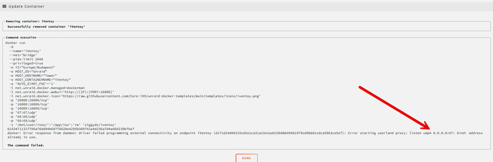

  • Edit :  Thanks @Mainfrezzer you just make me realise something , @VladoB you are not using my template .... 67 is use by dnsmasq

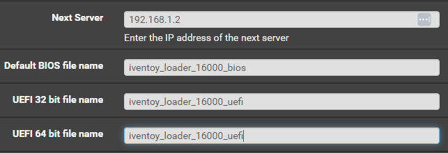

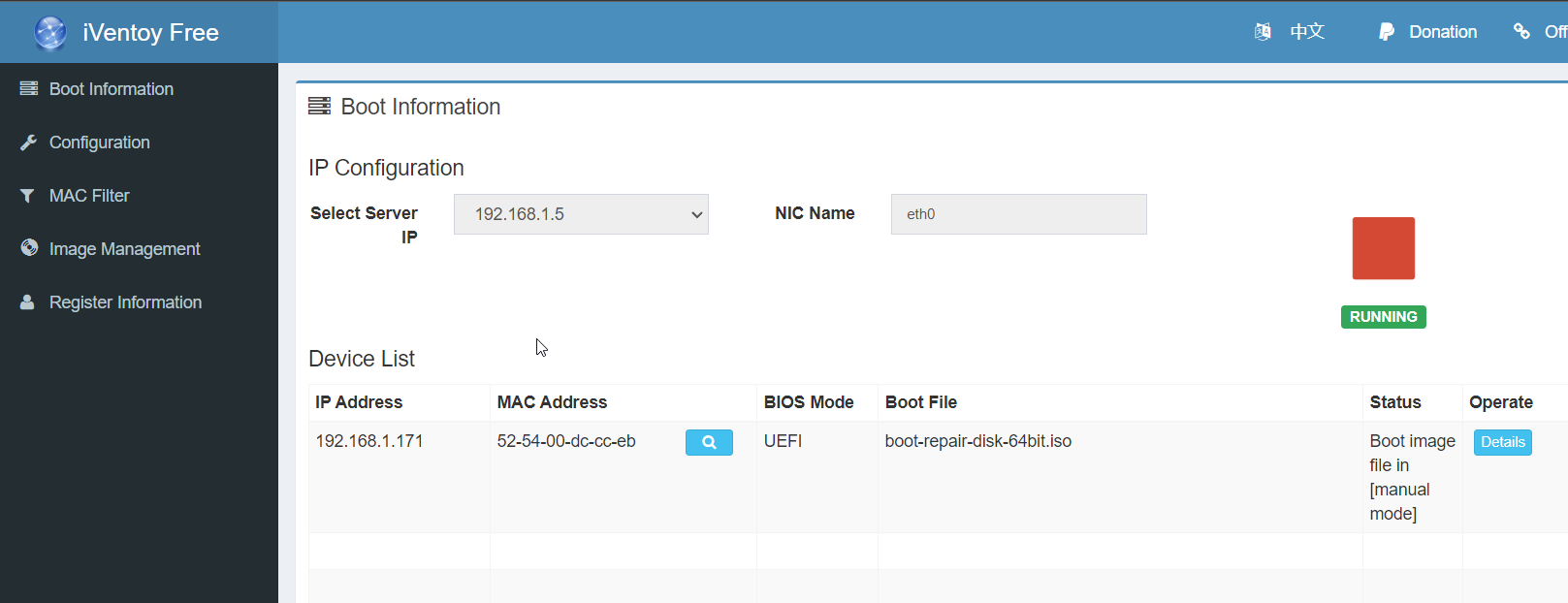

What is the BIOS file name I should be using? I'm on pFsense. Sorry if I am being thick-headed and missed it!
here you go :
55 minutes ago, ZappyZap said:
here you go :
Thanks! That worked perfectly.

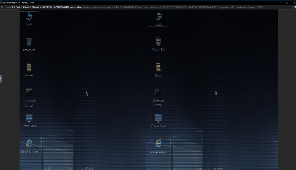

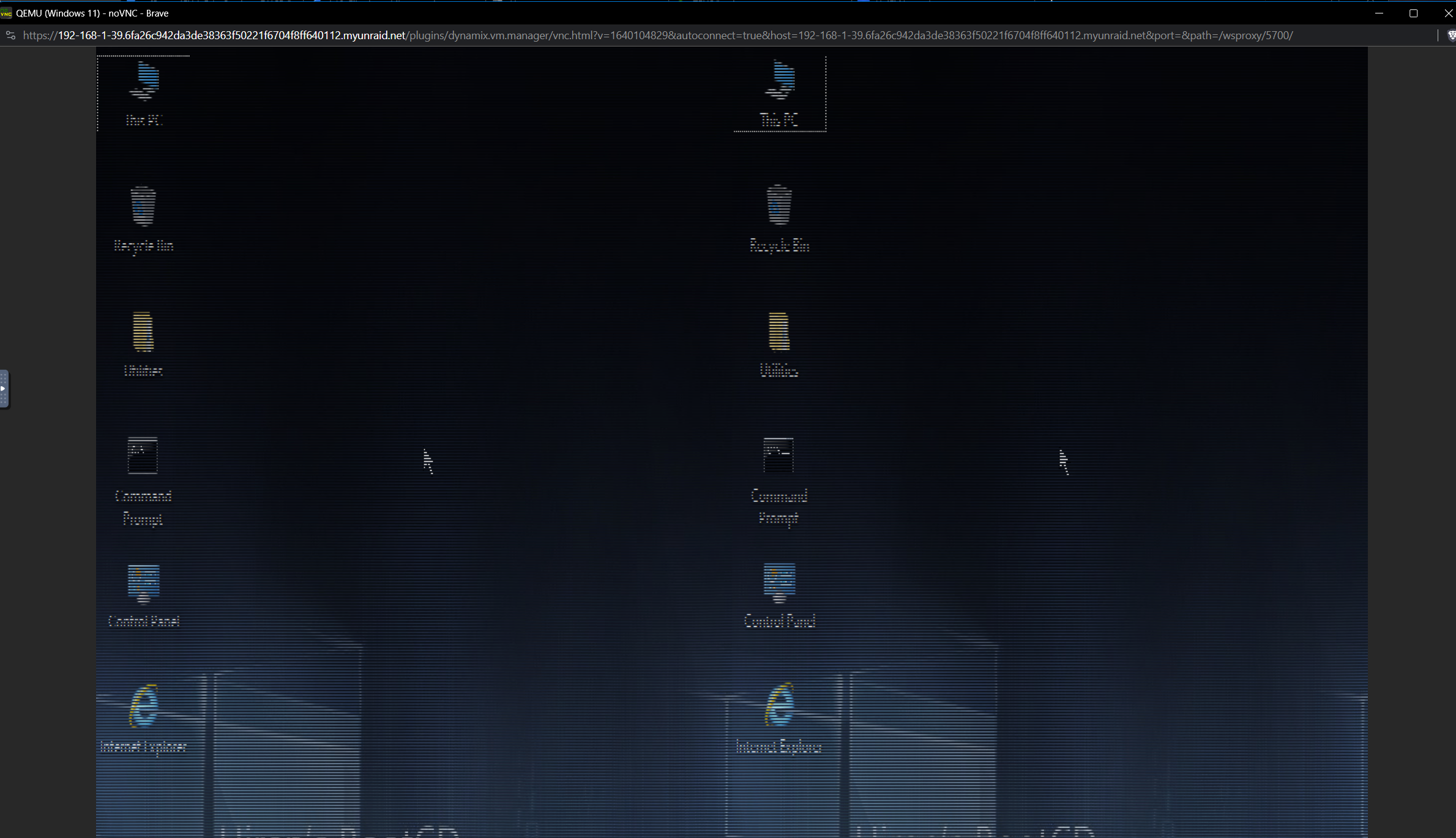

Just a heads up for anyone, I found that for UNRAID VMs, VNC doesn't play nicely...gotta use SPICE viewer.
The VNC view shows a weird double and triple ghosted display.

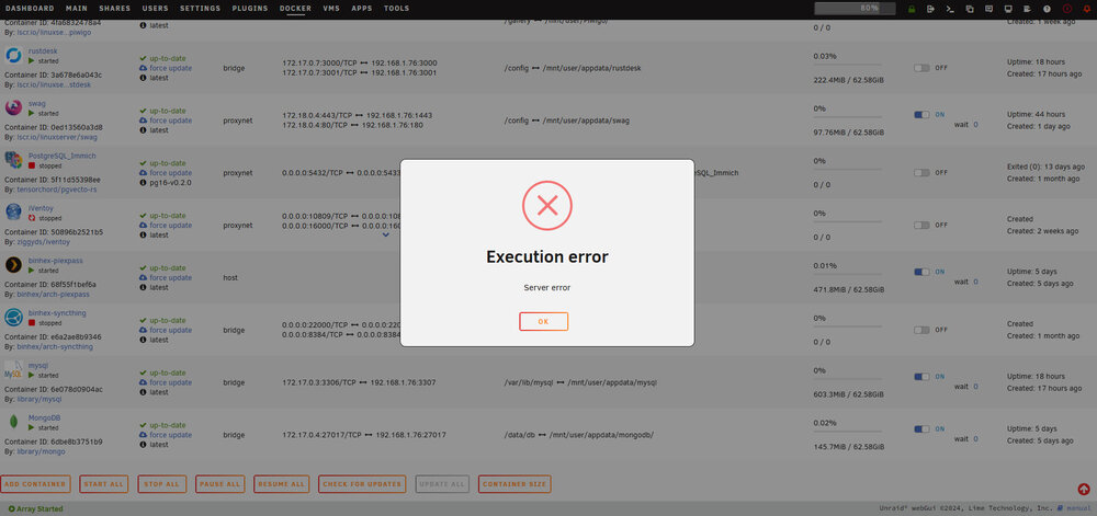

Thanks for putting this docker together!  It's working great except one thing I have noted:
When I attempt to stop the container it will not stop correctly. I get an "Execution Error" popup from GUI about 1 minute after clicking stop (timeout is 60s) and it shows "Exited (137)" as the status.  It starts back up fine though, so I'm not sure if anything is actually "broke" here.
Hello,
I was not able to reproduce this behavior.
i will try investigate a bit more.
Thanks

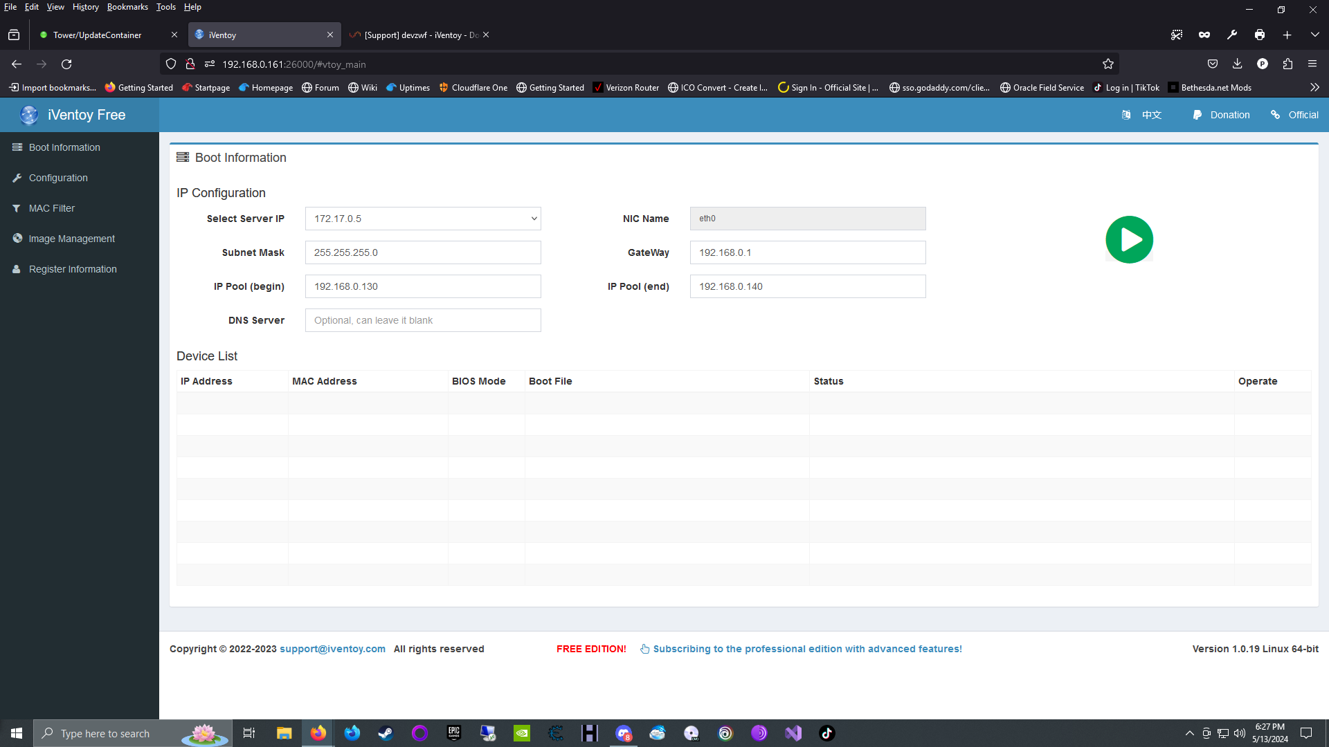

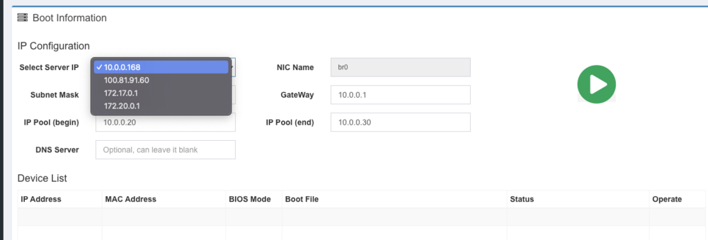

so installed it started it  and tried to boot from it but nothing. so my best guess is the server ip need to be to my local pool Example 192.168.0.0
