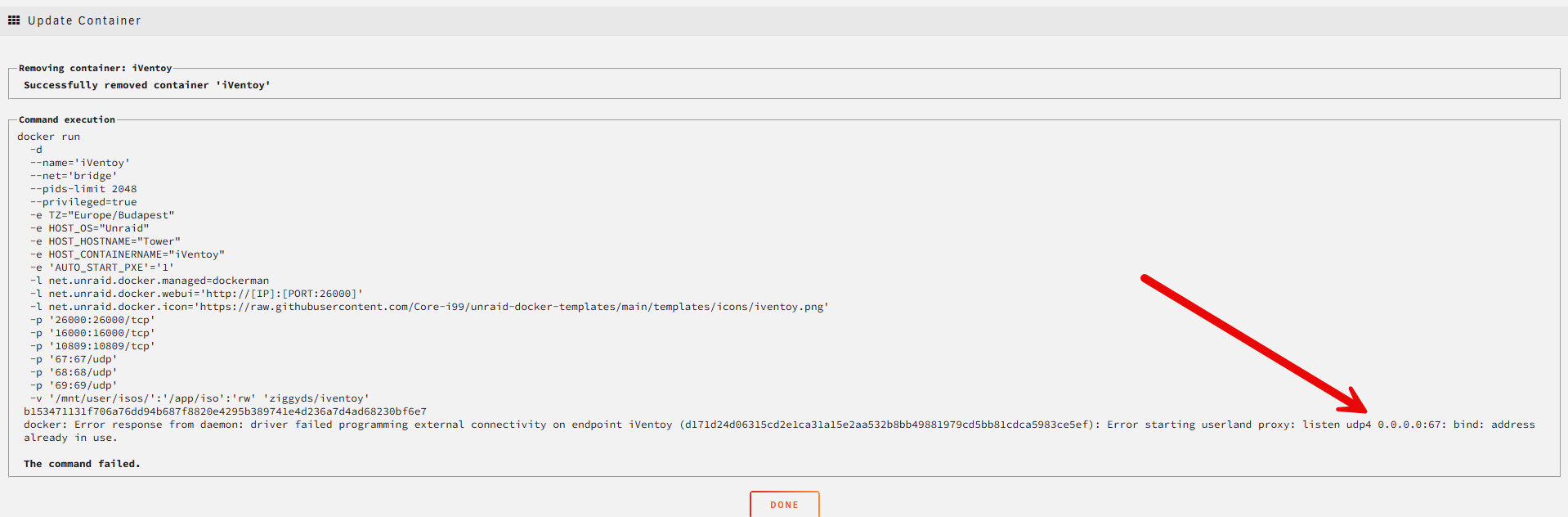

Hi Friends, my first attempt to PXE, but got error
50896b2521b5f516f7831cf9ac36114fe0552724fb60ccb18307d81fb194520e
docker: Error response from daemon: driver failed programming external connectivity on endpoint iVentoy (d4050464e6d74d4141560d479acd14f1e4fea2522e1cb2df6ace7c08fbb45614): Error starting userland proxy: listen udp4 0.0.0.0:67: bind: address already in use.
Any advice?

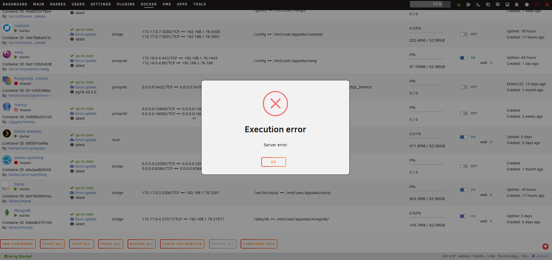

hi, I am not able even to start docker, it simply says Execution error.
and error is visible only when docker is created, because it does not start, it has empty log and it has no directory created in appdata2024-11-23_07-06-03.thumb.jpg.716675c11f08ee7db76c1550ad8d4c97.jpg
