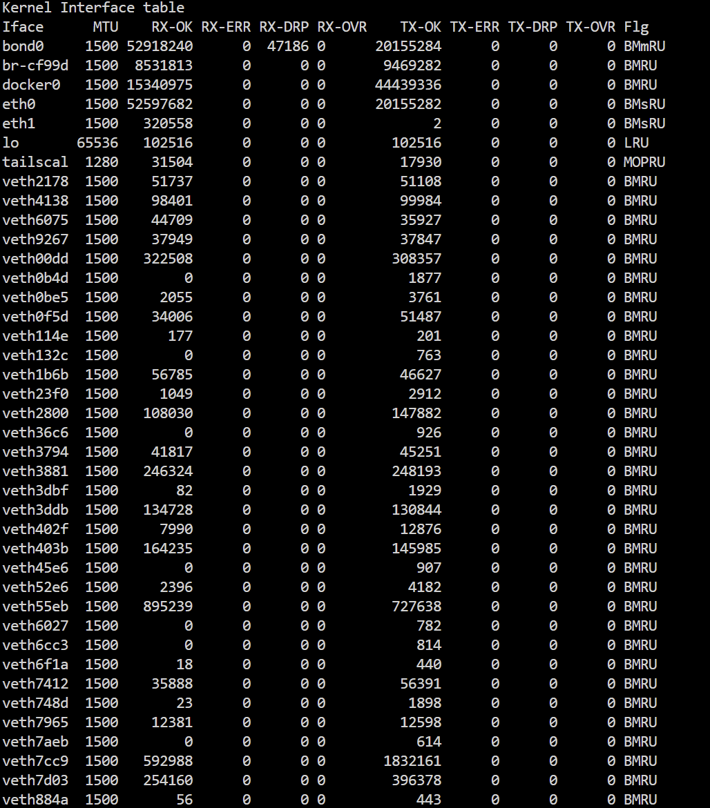

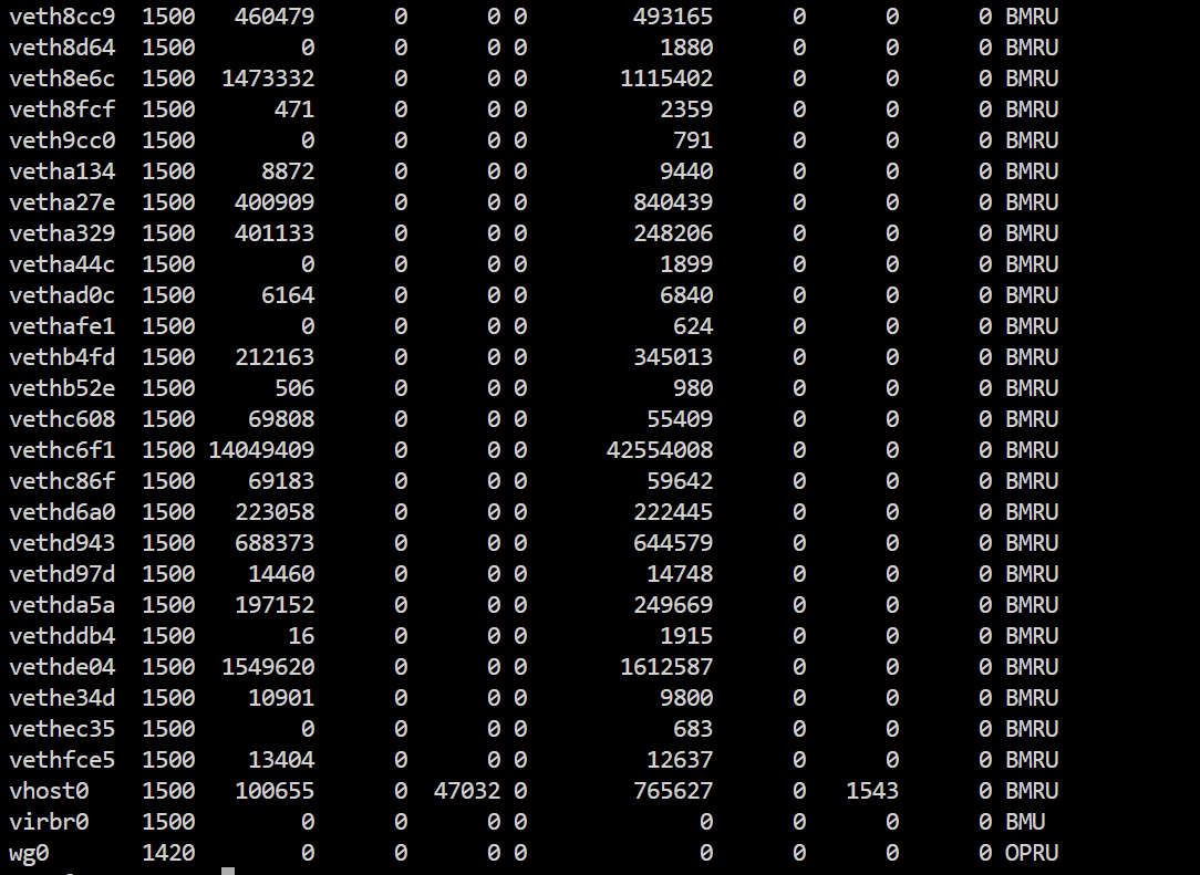

what is the output of netstat -i
we need to know the flags.
Your correct when I doubled check my settings, vhost has been taped for dockers with bridging off. But i'm not seeing drops...

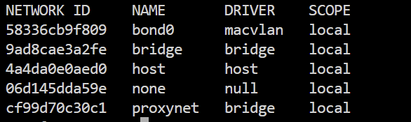

also what is the ouput of docker network ls
root@BMM-Unraid:~# docker network ls
NETWORK ID     NAME                           DRIVER    SCOPE
2f3b42c3e304   bond0                          macvlan   local
e392796db8d0   bridge                         bridge    local
7f05527ae402   host                           host      local
c7a0681e8f4a   netprobe_lite_custom_network   bridge    local
3189dbba008f   none                           null      local

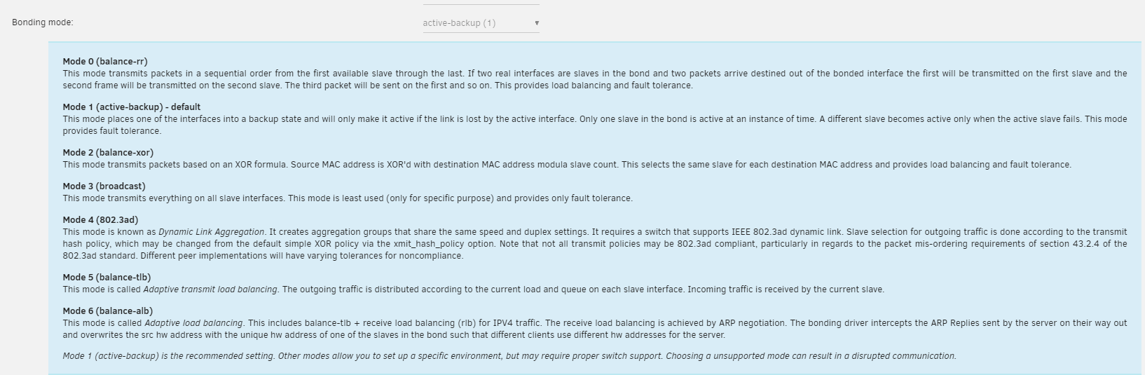

also since you have 2 nics in the bond. what mode are you running?
mode 1 - is the cable bad? you would see drops in it switches back and forth between the 2 nics.

Yes I tryed back without bond0, still have issue also changed cable.
As I posted befor is mode1, I will post all info later, also will try to check other cable again

I'm not seeing bad flags or other netowrk setting miss configuration/use yet...
in my experience, each veth is a separate docker..
so 63 dockers... What are you running?

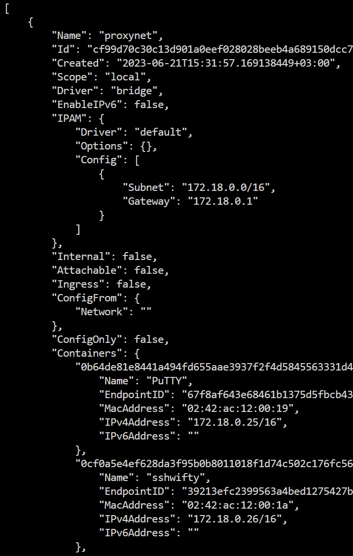

Lets check your proxynet bridge is taped into what interface for a connection? This could be a bug with default custom bond0 vs proxynet bridge.
Docker network inspect proxynet
Still need your unraid diagnostic we need the syslog and other data in the diag as there should be a record of what's happening before the drop please post diagnostics.
I'm running all kind containers proxynet for Nginx proxy Manager and containers for outside use.

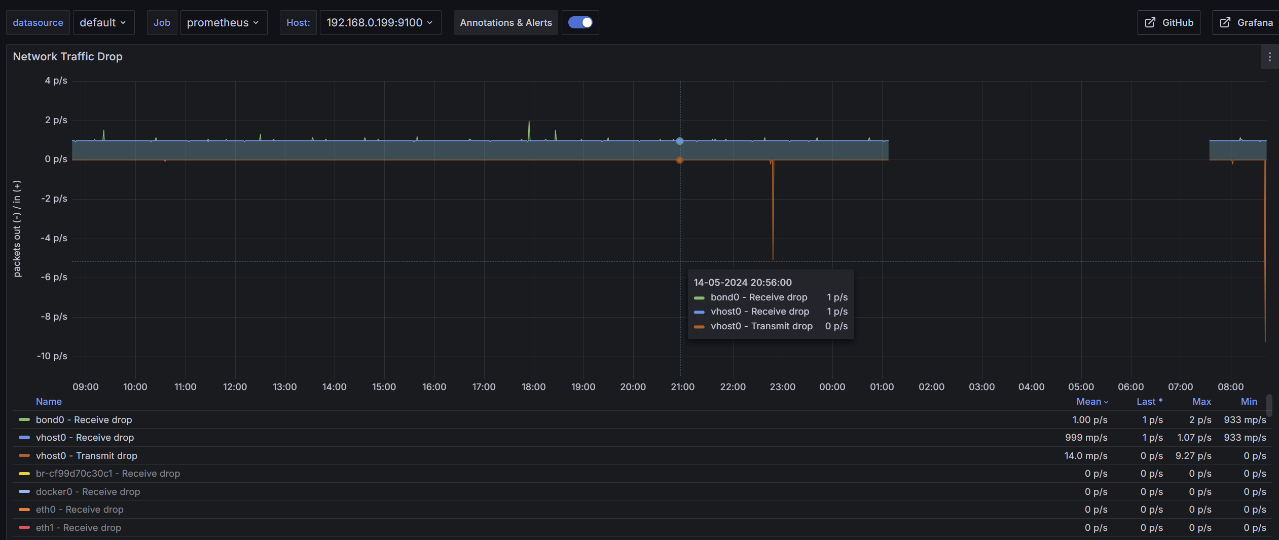

Also from grafana by monitoring Prometheus Node Exporter we can see no drops on eth0,eth1 so its not physical cable problem :

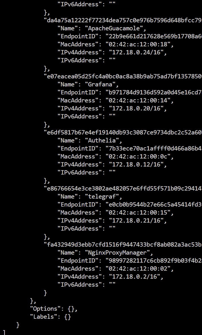

from network inspect :
Bond0 appears to be working correctly, you wouldn't see that even if there was a drop...
