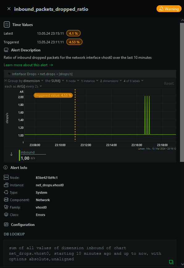

  6. Hello, I am affected too: vhost0: flags=4163<UP,BROADCAST,RUNNING,MULTICAST> mtu 1500 inet 192.168.1.10 netmask 255.255.255.0 broadcast 0.0.0.0 ether 02:33:dc:xx:xx:xx txqueuelen 500 (Ethernet) RX packets 235962 bytes 215191610 (205.2 MiB) RX errors 0 dropped 27168 overruns 0 frame 0 TX packets 41404 bytes 21627297 (20.6 MiB) TX errors 0 dropped 0 overruns 0 carrier 0 collisions 0 I had an alert in netdata inbound_packets_dropped_ratio on vhost0:

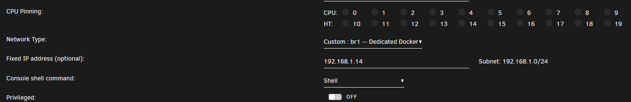

  10. Hello everyone, when I upgraded from unRAID 6.11.5 to 6.12.2 I had to experience macvlan call traces causing my server to crash. I tried with 2-nic docker segmentation method for my containers (br0 → br1) but this did not help, macvlan call traces still occurred, so I downgraded back to unRAID 6.11.5. Now I am looking for a solution to keep individual IP-addresses per Docker Container (right now it's br1) but I also would like to upgrade to the newer unRAID versions (latest stable for now is 6.12.4). Many of my containers look like that (with different IP): I am confused about the solutions on how go to use unRAID 6.12.4 without getting macvlan call traces. For me it is important that some docker containers have their own IP-Address since I can prioritize specific devices in my Fritzbox (for example the IP-address of a torrent container is low priority but the IP-address of a teamspeak is high priority). If I am understanding correctly, this does not work with ipvlan. But I also am using Docker Compose Manager with some stacks and some custom networks. I have taken a look into the release notes: https://docs.unraid.net/unraid-os/release-notes/6.12.4/#fix-for-macvlan-call-traces So when I follow these steps, will I still be able to give individual IP-addresses to my containers? After following these steps, will the IP-addresses stay the same or do I have to edit each container and setup the IP-address? Is there anything else to take care of except these steps (and the troubleshooting section)? Thanks for reading into my questions!
